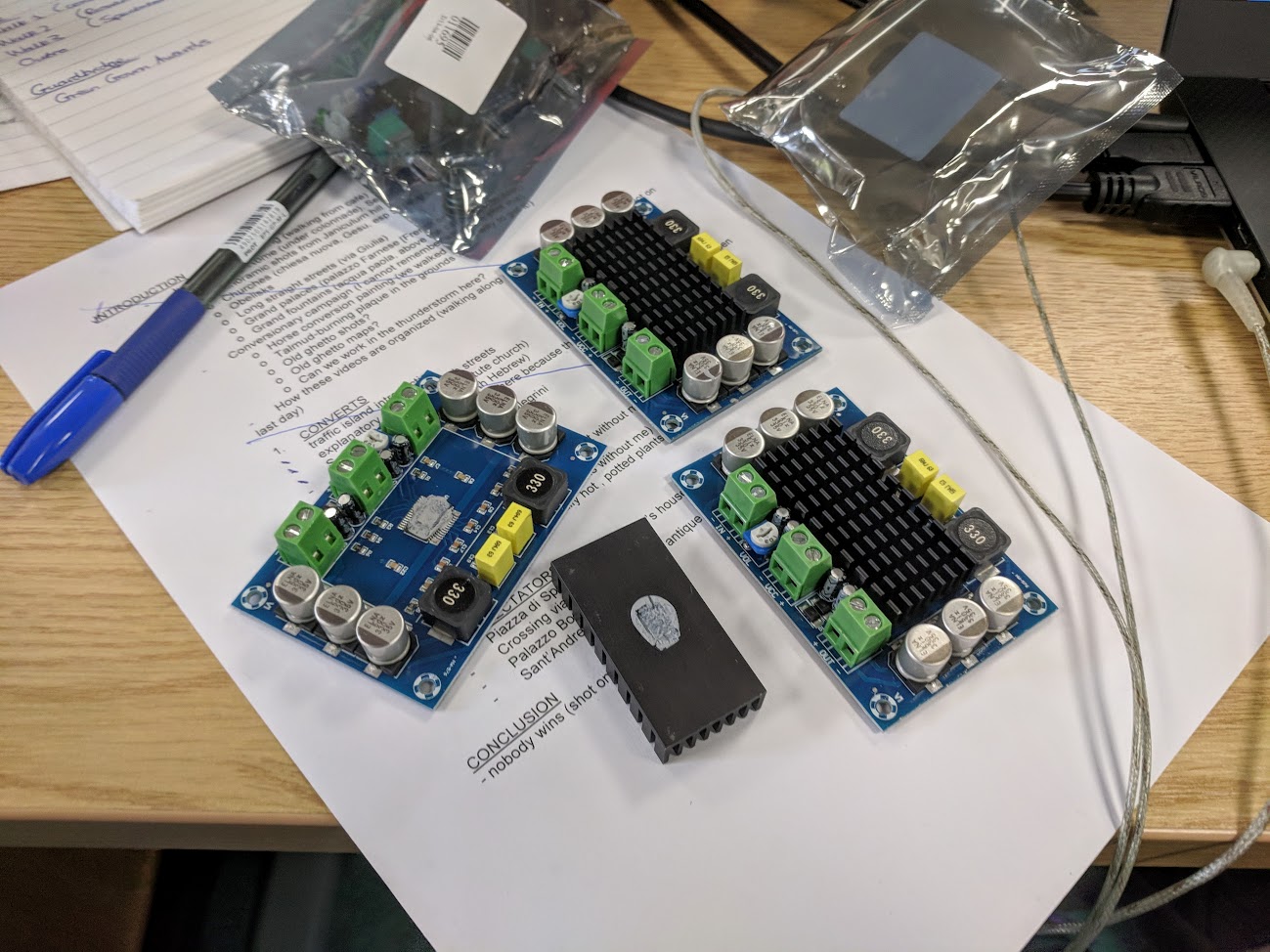

My filter & three of £3.37 amp modules arrived today, much sooner than I was expecting! The thermal adhesive on one of the amp modules failed & the heatsink was loose, so I'll have to reattach that. The solid capacitors are labelled 'Elna' but somehow I doubt they're legit considering the price...
