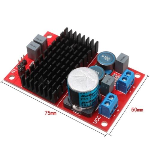

After a while, I took a search on ebay and found some new tpa3116 mono boards I have never seen before. Any info about this board? which is $5 dollar, has nice heatsink and a huge capacitor.

I would say you get whag you pay for. It's not going to bz impressive.

Why do you say that? That's about the average price for any TPA3116 board, much of them pretty impressive?

I say that because I do, and because I know what electronics go into an amplifier. There's also no onboard, gain controls.
There's only a meh-quality input cap, too.
