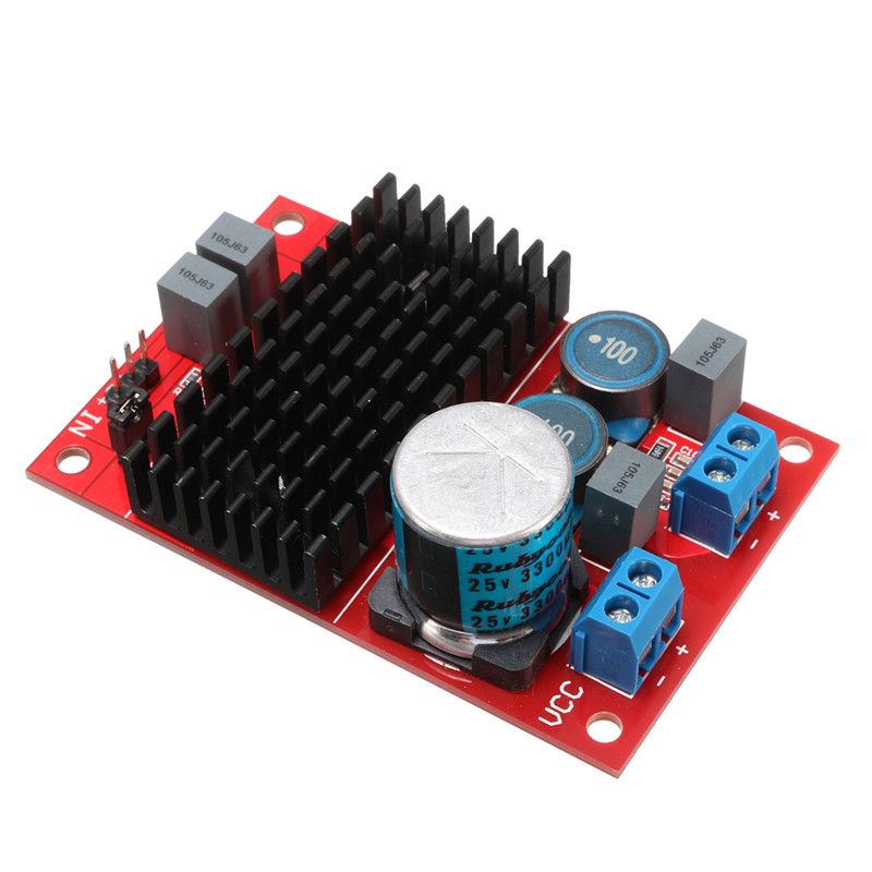

I ordered a couple of these TPA3116 PBTL to test. If they work out, making a Eagle footprint for it.
The terminal blocks and headers I'll remove. Those will become 'pins' using heavy bus wire.
We'll see how it goes. There is a newer version with a film input cap. I'll remove the existing two polars and replace too on this earlier board. The large 2200uF filter cap will also have to be replaced. Its rated 25V and I'm running 24V. The other two radial ps caps rated 35v so ok. The pcb is setup for heatsink screws but heatsink is untapped. So that too.

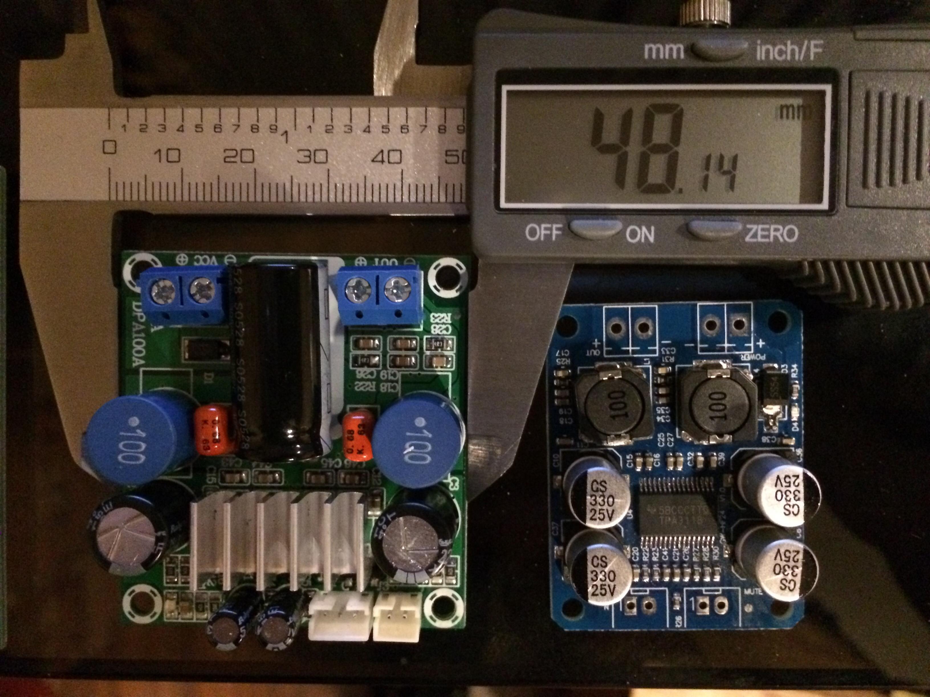

Shown here next to the ever popular $6 miracle amp.

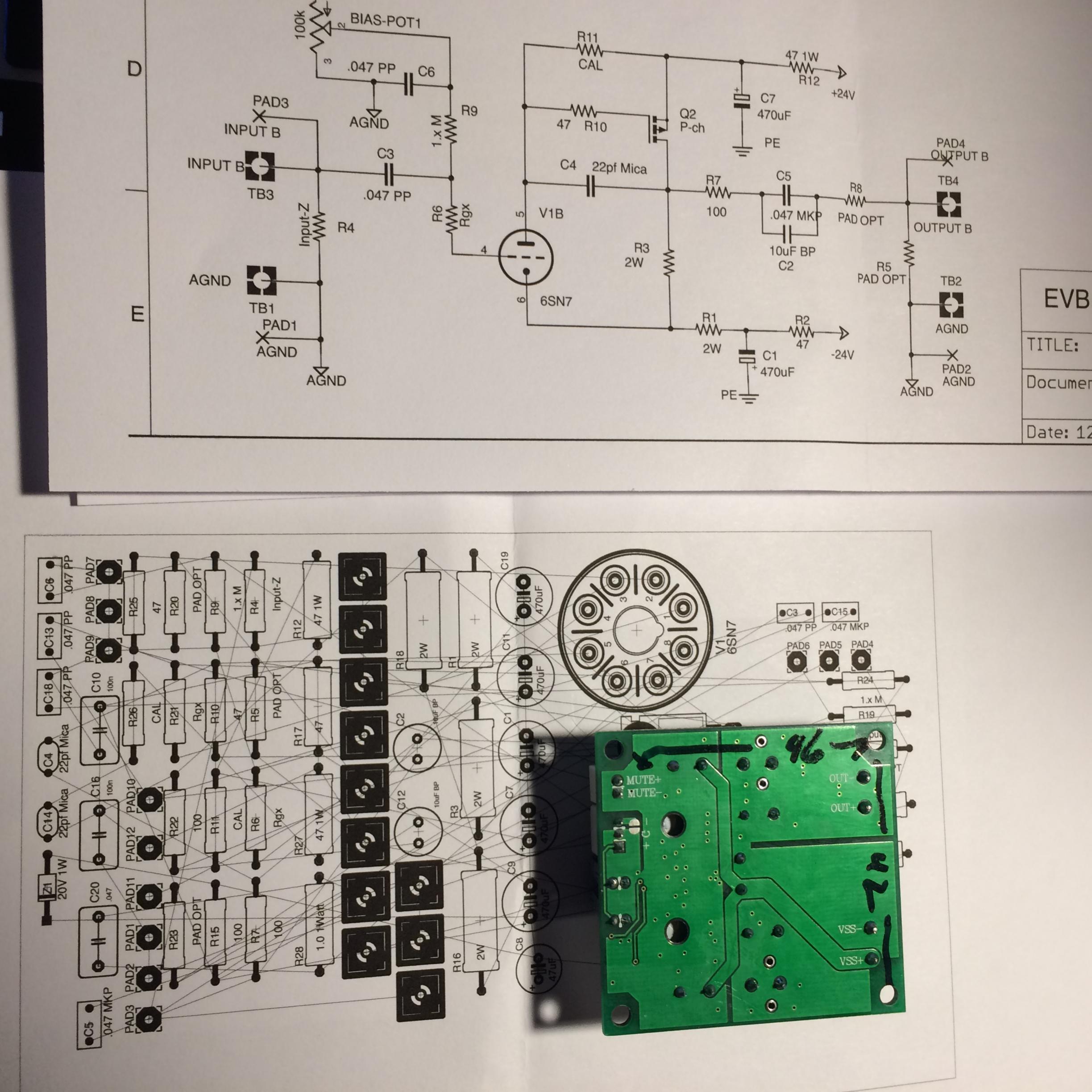

This is for a hybrid 6SN7/ D-class monobloc. Have different photos running now. I love these boards.
Phasesplitter in tube section ?
Why do you think the bigger ampboard might be better ? How does bottom pcb look ?
The tube make great simple low distortion CFP hybrid sound. Rat nest bottom pcb shown here. Dims are mtg holes. Power is +24 and -24v so tube sees 48v total.
Why ? You know what the best connection is don't you ? I have my doubts at the quality of those specific connectors blocks (probably ferro or famous chinese "any-metal mix") but Phoenix ones are better than soldering to pins. More flexible too and less problems with mechanical stress.
here is link to zip files schematic/plots early prototype using 12au7 and $6 tpa3118 board.
My background is high reliabilty mil/automotive and extreme environment oil-gas. Screw terminal connections are not allowed.
I prefer soldered anyway for this class-d app, guaranteed low z power connect.
