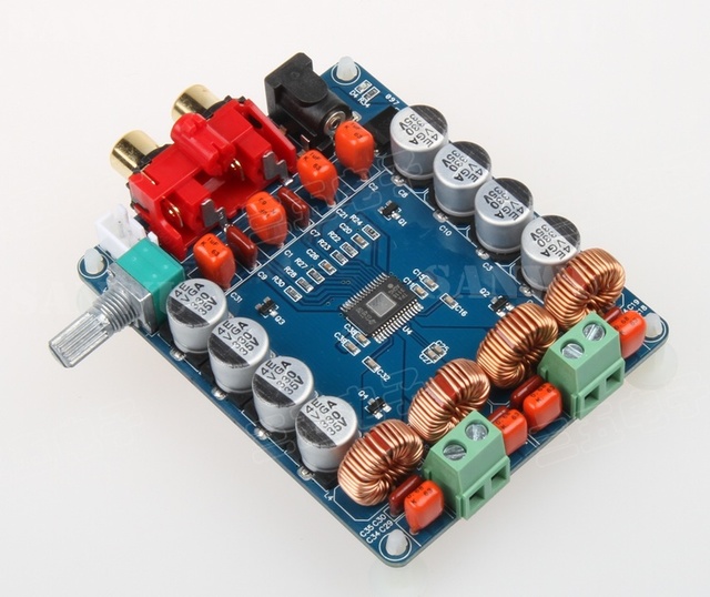

Not sure if this was posted already- it looks similar to that Taobao amp from an earlier post, but the caps are closer to the chip.

The bootstraps and the input audio caps are placed too far away from the chip.. I guess you'd need to add snubbers on it from the start. I wonder if all those psu caps can overcome the hiss problem that occurs when the caps are placed so far off the analogue power pin?

I noticed that what I wrote earlier can be misinterpreted. There is only 1 analogue power pin (AVCC pin 17, used for both left and right channel). Before we put the RC mod circuit on that pin I soldered the Oscon cap directly to it and lowered the hiss that way. Placing them further away gives me more hiss on my boards. Thats why I advise people to buy amps with psu caps close to pin 17. Wrong placement of of bootstraps and input caps gave me treble sibiliance. Of course I might be wrong about the hiss but I like study new tpa3116 layouts from time to time I am always in search for that perfect cheapo amp^^.

Yes audio inputcaps Wiener, left vs right ch. PCB layout seems to differ for left and right, just like TI3118evm btw. Small decoupling is very close, layout doesn't seem funny like some that have 1 bootstrap past inductor and really big distance and TH, these are close compared to those "drunk" ampboards

When the snubbers and bootstraps are placed correctly I think that the audio input caps placement is less critical. The sibiliance on the YJ red board disappeared when I put the snubbers on, and moved the bootstraps closer to the chip. That sibiliance weren't as noticable with all speakers, but is was really bad on my Xtz 99.26.
