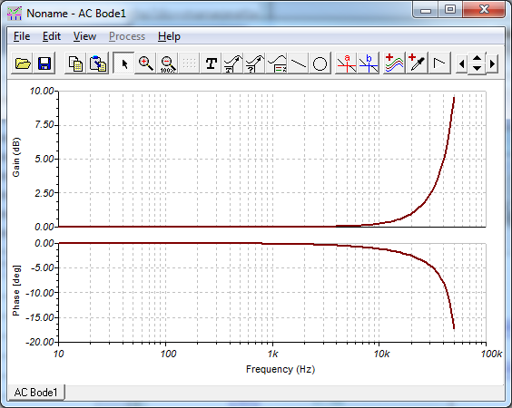

Would you mind uploading the .asc file here? I'm having trouble figuring out how to build this sim.
Another great package is Texas Instrument's TINA. A free SPICE program with built in library of TI parts.
SPICE-Based Analog Simulation Program - TINA-TI - TI Software Folder
Here is a similar circuit I made for filter analysis:
The circuit file is also atached as zip file. Once you install downloaded program, open the file and click on components to change. You can easily remove or add components and re-wire with point and click. Very simple.
Give it a try...

Pure resistive speaker? o_O
While a pure resistive load is naturally not ideal for simulations. It'll give a good estimate on where to start doing actual simulations with equivalent circuits for every single component. And that's not just the speakers and speaker cables but also each component in the output filter as well as the outputs inside the chip itself all have to be replaced by actual equivalent circuits for relatively accurate simulations. And even then, it's only a simulation which doesn't take interference artifacts and environmental artifacts into account.
