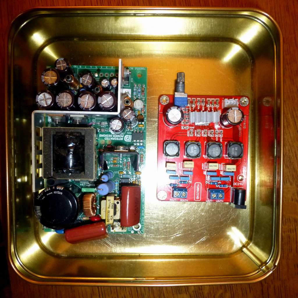

Hello TPA3116 madmen.
I will be boxing up my red YJ 2.0 board in a cookie tin I've saved for just such a project. I will include a 12V SMPS that I rescued from a shoddily-put-together 41Hz Amp6. My question to those more experienced than I: what would be the optimal orientation of both of these units inside the tin? Would it make much a difference one way or another? In the attached picture the mains input to the SMPS is at the bottom, and the 12VDC output is at the top.

Well, I scrapped that idea. I had another small chassis that fit the board perfectly. It's too late (early) to really fire it up, so I'll post listening impressions later.
I received a blue 2.0 board recently, and may put that one in another tin I've saved -- Sprungli chocolate from Zurich.
