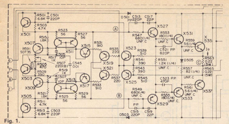

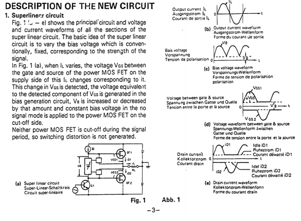

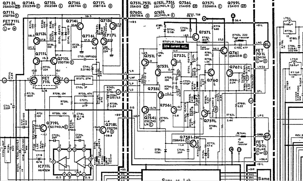

FTR old non switching OPS circuitries from Hitachi and JVC, dunno for JVC s solution that is from 1978 since they later replaced this discrete design by an IC referenced VC5022, wich was to be used in most of their later amps including low priced ones.

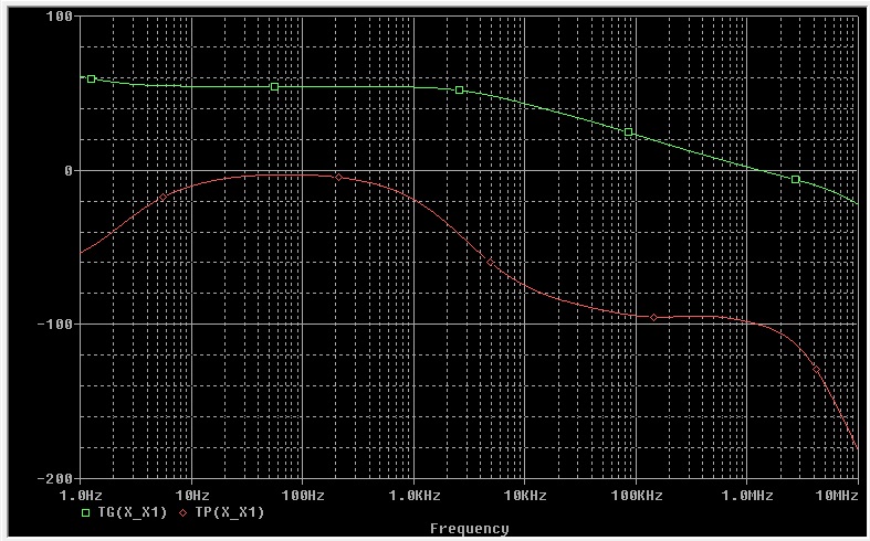

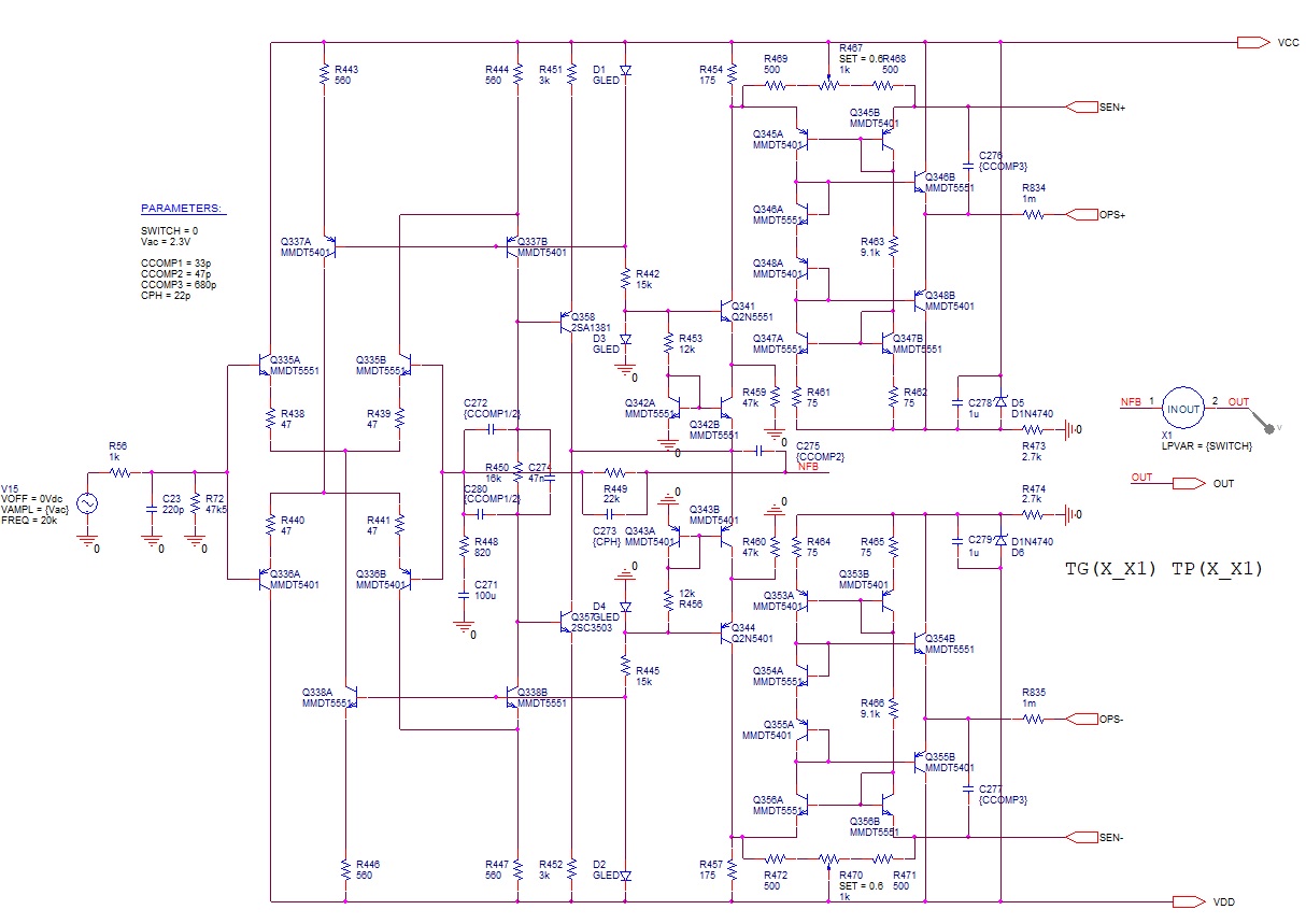

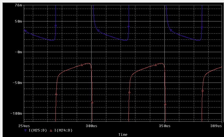

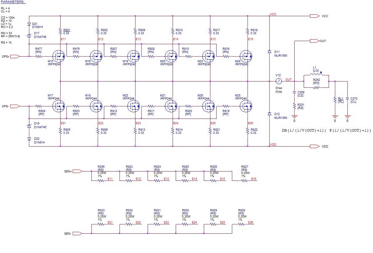

Here's a proof of concept of a high power non switching MOSFET amplifier I've designed a few years ago; the prototype showed about 0.0005% THD at 500W/4ohm. Still needs some work to be something pushing in a chassis (in particular for the pesky clipping behaviour) but is otherwise perfectly stable and doesn't do any really nasty things, like latching, when overloaded. Thanks to the non switching behavior it doesn't need much loop gain to get distortions down to 5ppm, this one has about 60dB at LF. Loop gain can be pushed much further in frequency, there are large stability margins, some two pole compensation could be used,
It's not a simple design, as expected performance has it's price. The trimpots are not really required (they set the output stage bias and balance the output) if the output MOSFETs are reasonably matched. Usually devices for the same tube are good enough (that's what I used and barely touched the trimpots from their mid position, to bring the output offset to zero)). Unity loop gain frequency can be pushed much further, there are large stability margins, some two pole compensation could be used, so there's a lot of further improvements, unfortunately I am swamped with work and other projects, so this one may wait until I will retire (few years to go).
I have somewhere the measurement results, I'll dig for if there's any interest.

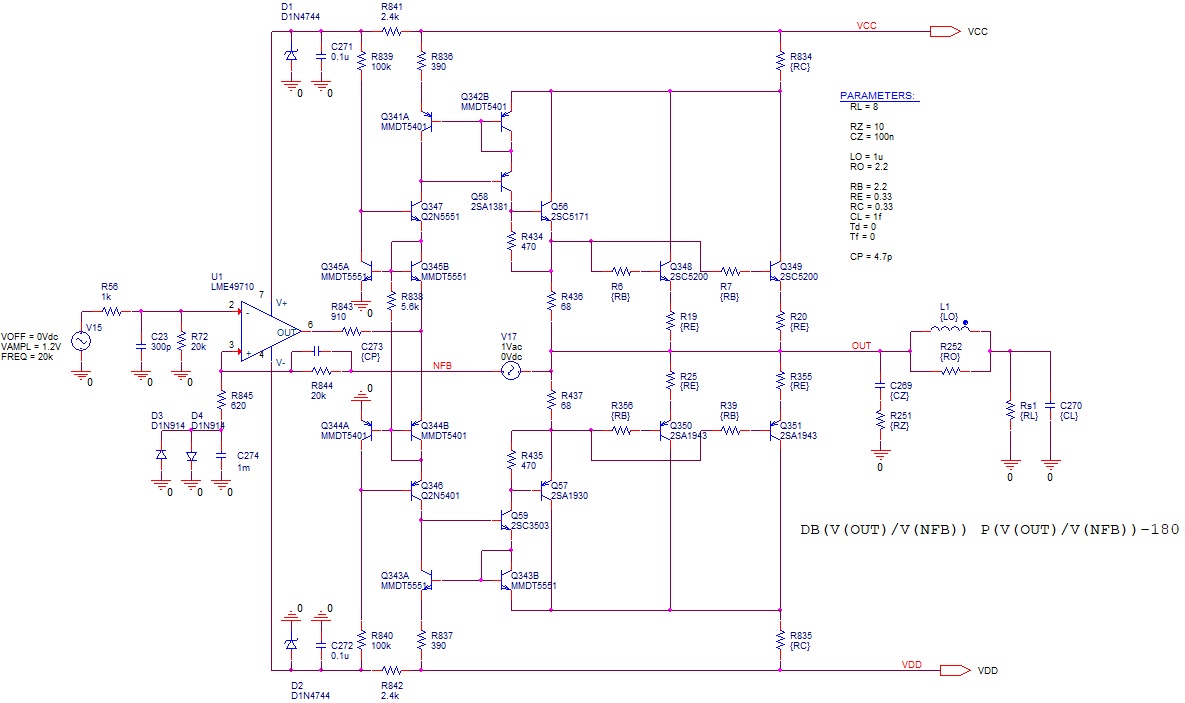

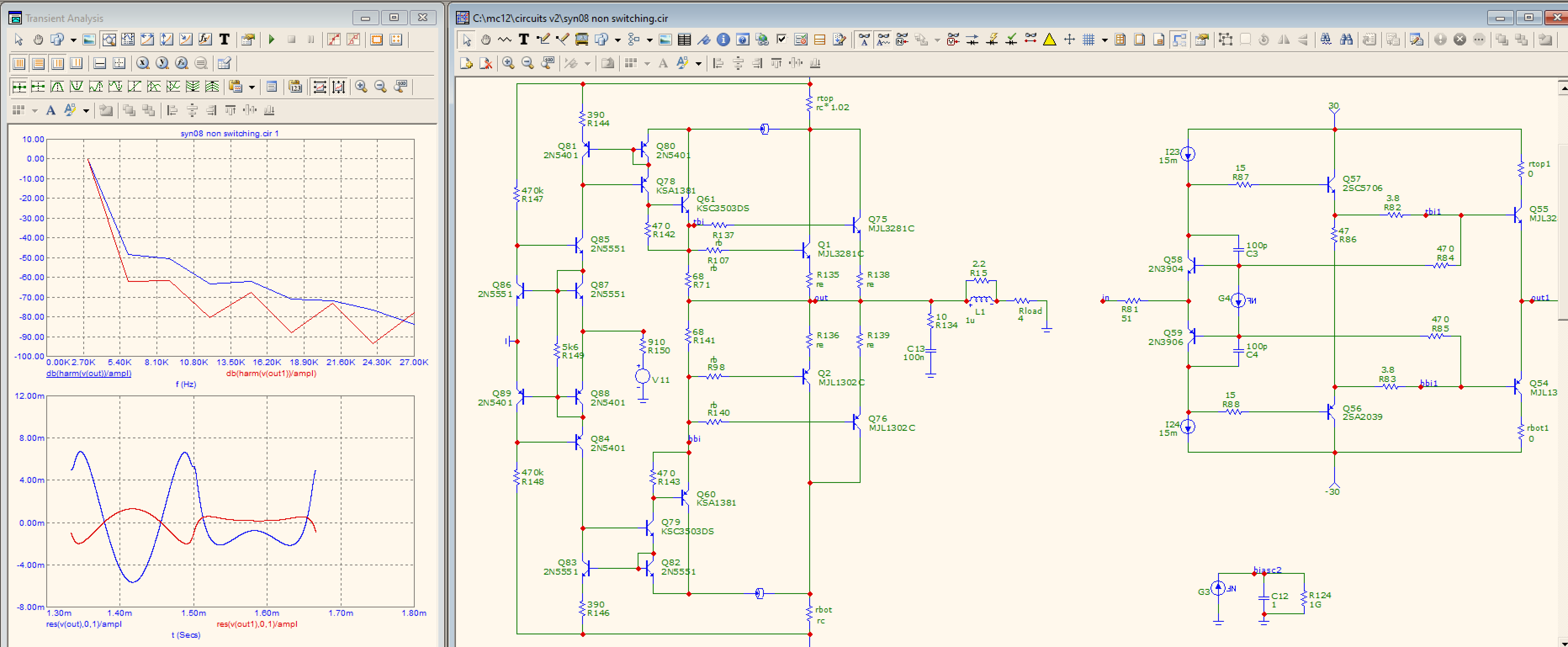

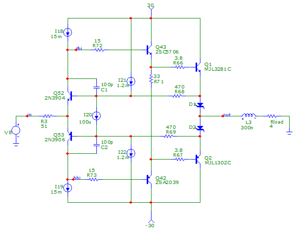

And here's a much simpler bipolar version; this one did not go beyond the simulation stage; it works fine in the computer, the distortion results @100W/8ohm are slightly worse than the version with MOSFETs.
Not my design, found it somewhere on the internet. I was looking for a smart compensation schema for it, beyond the rudimentary phase correction in the attached schematic, before trying to move it on the bench. Didn't find anything obvious/clear, Spice trial and error method is not something I enjoy doing, time was short, so I gave up. If somebody wants to pick up and make it a working amplifier worth of building, be my guest.

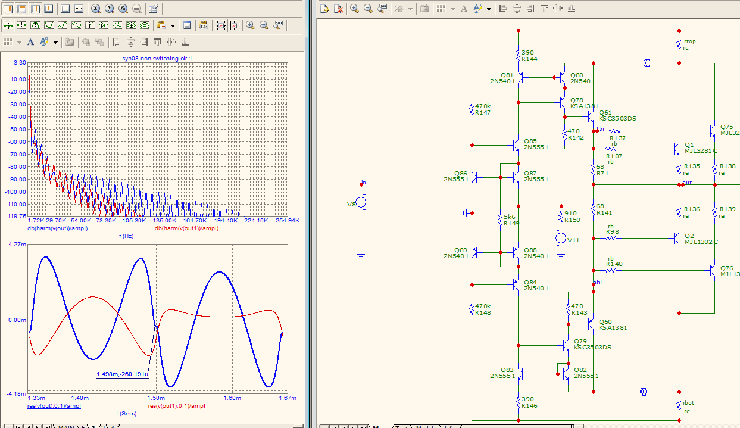

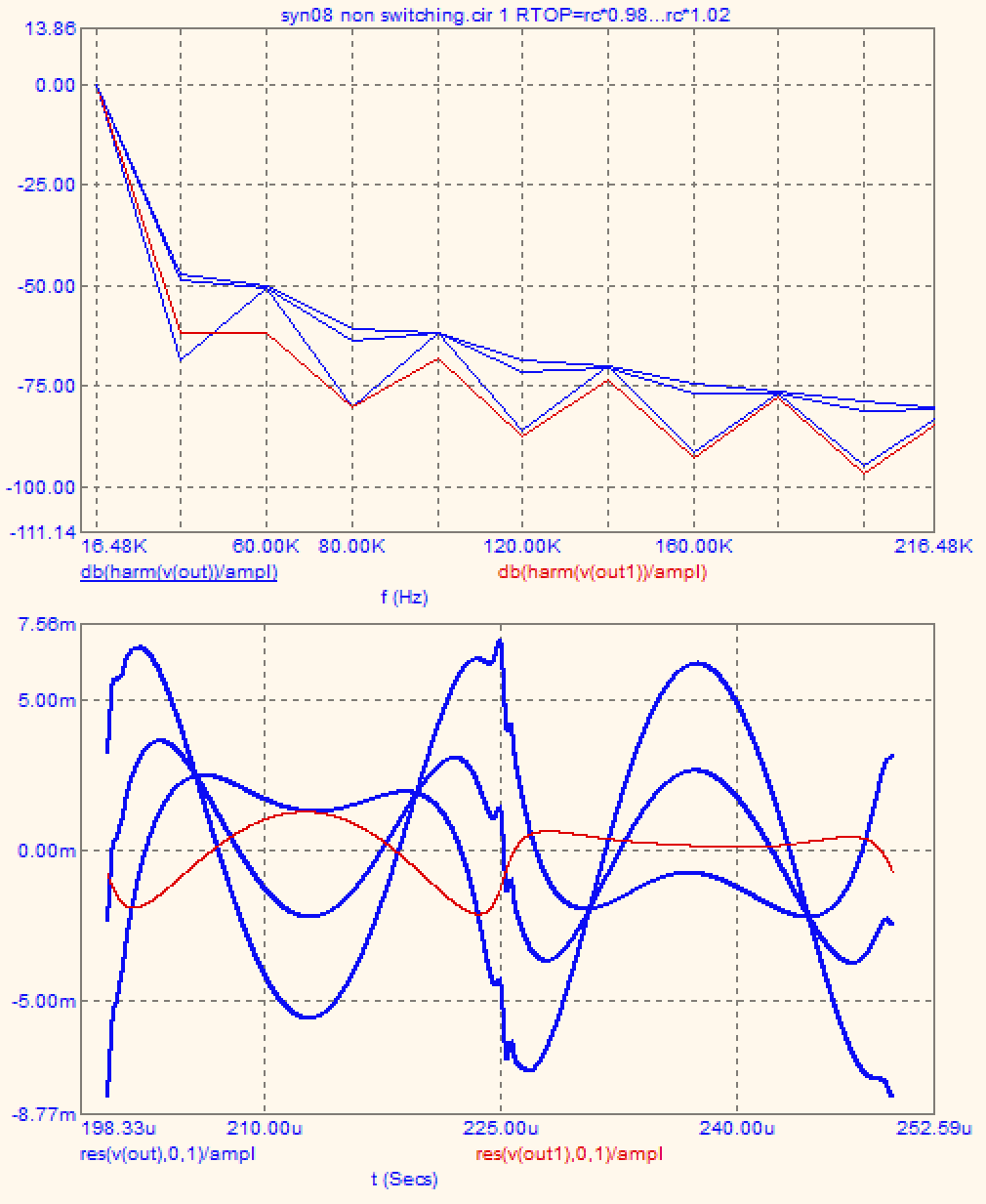

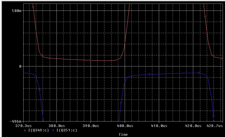

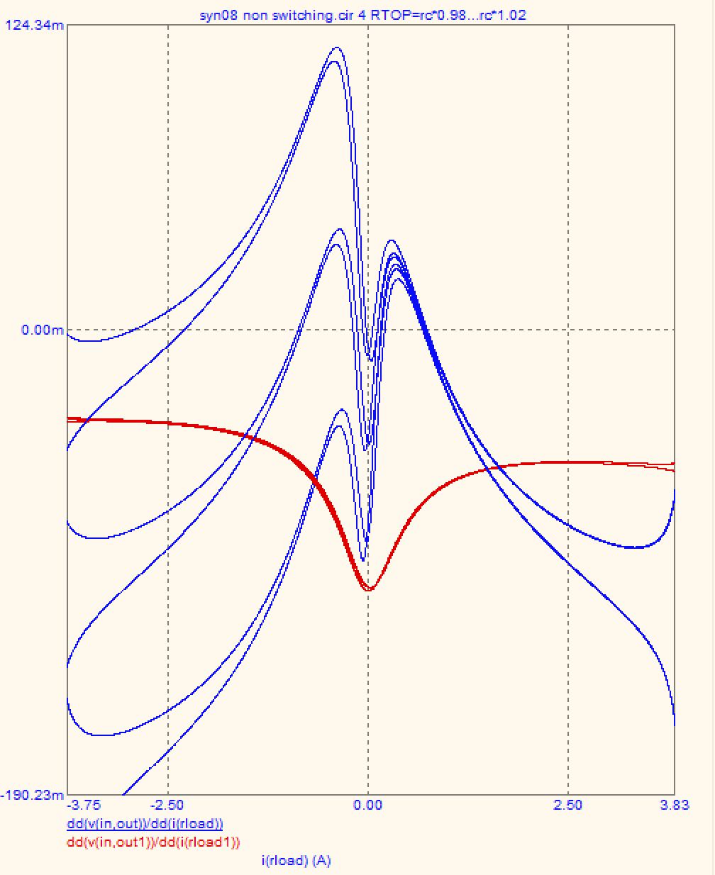

This belongs to a class of circuits that uses a small signal class AB stage to split the desired output current into two halves. Then, two separate current controlled current sources (cccs) amplify each half-wave, and the resulting current is summed at the output.
This entire circuit class does not work for several reasons:
1) Even if the splitter is ideal and generates two half-waves whose sum is not distorted, for the same to happen at the output, both CCCS must have exactly the same gain at all frequencies. If they have 1% gain mismatch, then 1% of the halfwave current, which is almost entirely distortion with tons of high harmonics, will end up in the output. Attached simulations for various levels of mismatch, including no mismatch. It makes lots of high harmonics that don't fall off with frequency.
2) Each half, or top and bottom CCCS, processes a halfwave rectified version of the output current, which contains a lot more high frequency than the original signal. From these, each half will create its own intermodulation products, which will never match and will never cancel in the output.

Doesn't work perfect, which is what you are after. Absolute perfection or absolute failure exist only in simulators.
I was looking forward to put this on the bench, but I could not make it stable to my satisfaction, in a sensible way.
The discrete version above works perfectly on the bench, with the indicated results (probably also not perfect to your criteria). As I said, it is rather complex though.
I remember for open loop (as you did above), the THD increases by some 20-25% with 10% imbalance (which can be easily compensated using the trimpots!) to a maximum of 0.5% (on the bench) with the most energy in the 2nd harmonic (probably due to the MOSFET output stage). No high order harmonics.
This approach is obviously inferior to the geometric collector/drain currents approach used by the LT1166 and that Edmond tried to simulate (which I believe is the best strategy) - unfortunately I still have to see an implementation that works properly.

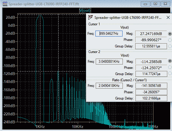

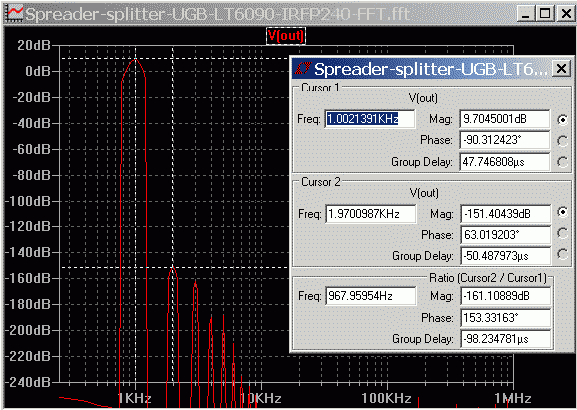

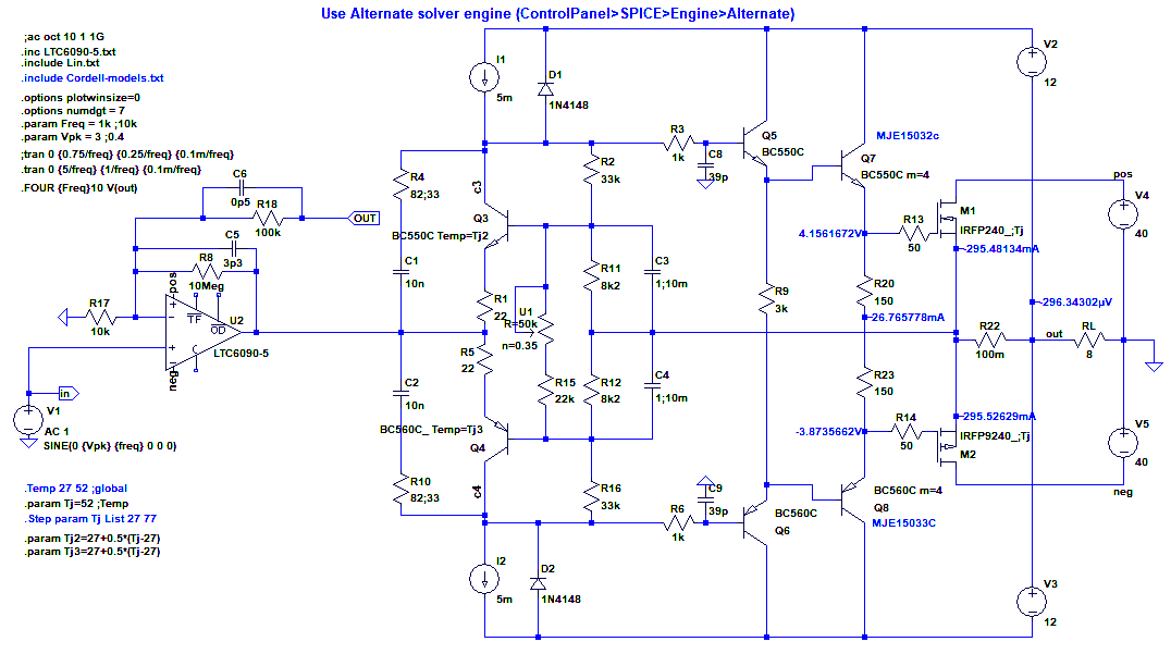

Hi Ovidiu, peufeu,
Ovidiu, that second one is interesting how the splitting transistors are effectively bias spreaders as well. They don't give non-switching Class-AB by themselves but the 5k6 resistor across their collectors (R838) stops current turn off on one side.
Here is a circuit I have been looking at. It also uses the spreader transistors as splitters but NOT non-switching as I am using MOSFETs (but it can be made non-switching).
attachment.php
attachment.php
attachment.php
It's still in early stages of simulations.
I1 and I2 are temporary while I developed the main parts. C3 and C4 are set to 1F just for plotting the gain function at 1Hz -- they would normally be 10mF/6V, since the base node needs a very low impedance for a high internal gain (80dB at MF and LF).
Peufeu, BTW R22 is not the same as source resistors for the MOSFETs, so it not an "evil source resistor". It provides some degeneration which reduces the compensation with R4,R10 which gives higher BW (20MHz small-signal) and less high-order harmonics at 1W. The closed loop bandwidth is 200kHz which is mainly due to the opamp and with C5 '3p3' it is over compensated just for better clip recovery.
Anyone running the circuit, for some reason it needs Alternate solver engine on LT-XVII.
  • Spreader-splitter-UGB-LT6090-IRFP240.zip

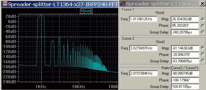

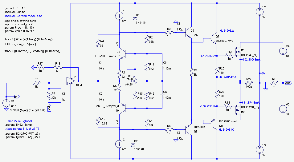

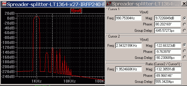

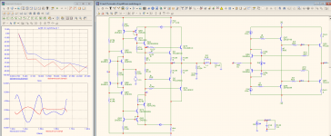

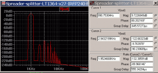

A relative of the last post with a normal voltage opamp by using an output stage with voltage gain.
THD is higher (1W 0.3ppm) and overall BW is higher (8 MHz).
attachment.php
attachment.php
attachment.php
Although this and last post are not Auto Bias they allow a comparison to a conventional bias sensor -- to help decide whether an Auto Bias scheme is worth the extra effort. An Auto Bias has no thermal lag distortion while a conventional bias sensor does have TLD. An Auto Bias has no bias trimpot while a conventional bias sensor does have one.
