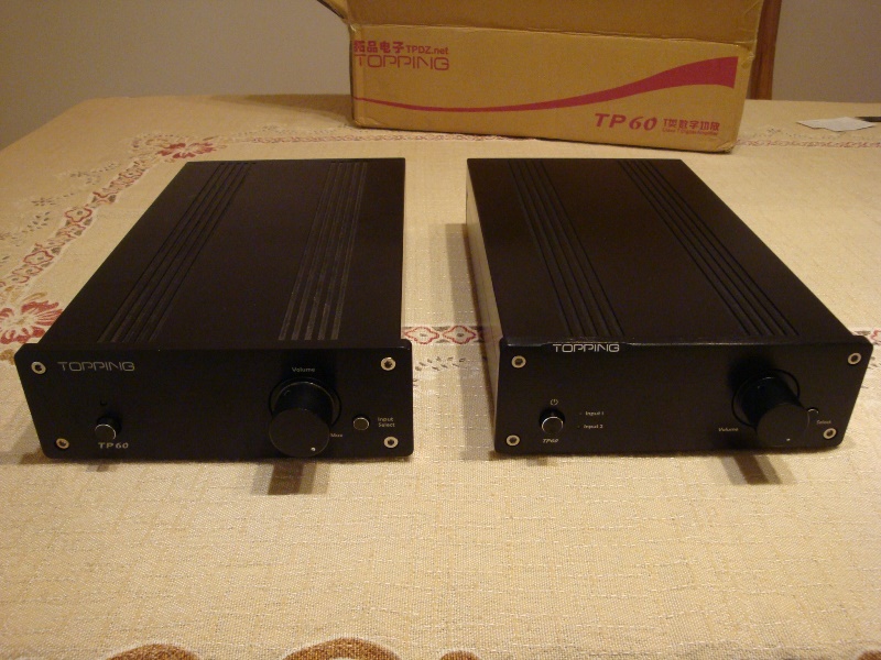

Came back earlier and started working on my new TP-60. It's the new version. In the pic, the old version is on the left and the new one on the right. You can see it here: TOPPING TP60

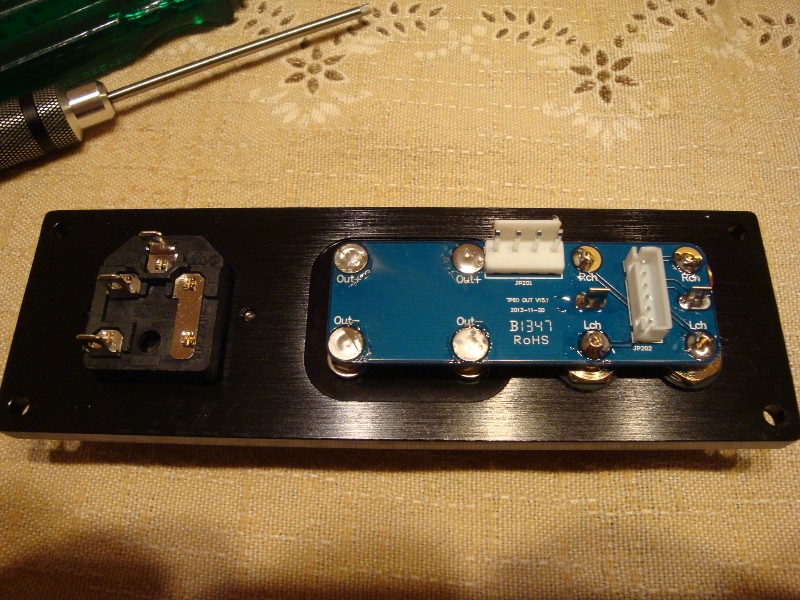

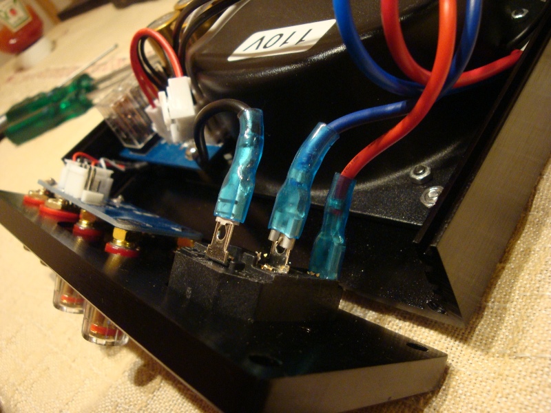

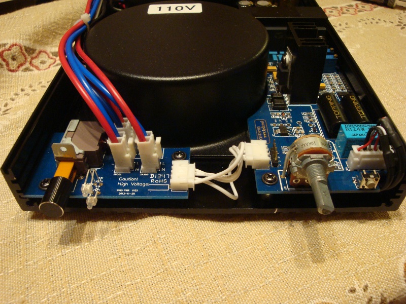

Mod list is:
- Replace original pot with a 21 step SMD stepped attenuator or to remove the pot
- Eliminate the input relay
- Replace input caps with Auricap Xo
- Replace PSU caps with Nishicon KW and Panasonic FM (the original ones are Nishicon FW. Not bad!)
- Eliminate PCB on the back plate (soldering the new wiring directly to the plugs)
- Replace input cable from RCAs to board with silversonic interconnect
- Replace output cables with furutech 14AWG speaker cable
- Solder trans cables directly to board, eliminating connectors
- General improvements on cooling
Here are some pics of the initial work.

As I said, after the mod is complete, I will be happy to do a comparison for you. Also, I can send you the original Topping caps so you can try them yourself in your amp too. As you can see in the pics, for the new version they are using their own (OEM for sure) caps instead of the WIMA ones. The new ones look like film type (2.2uF 100V)... Just let me know.
