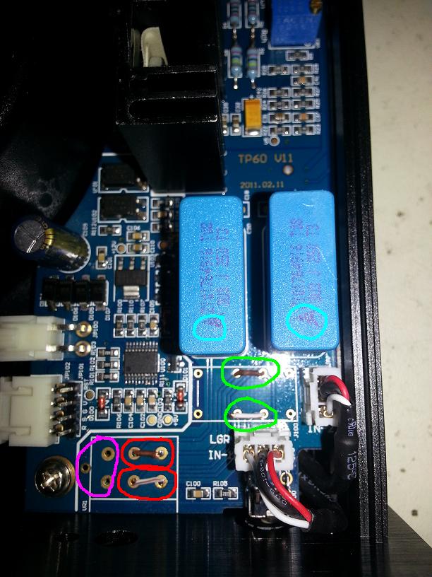

I think the easiest would be to:
1. Take out the pot.
2. Run the positive lines of one RCA pair from the back panel directly to the large input caps. Could follow the PCB lines from the pot wiper to the caps of interest.
3. Run the GND lines of the RCA to the GND of the board. Closest GND point to the input caps would probably be best.
I'll verify the connection points on a pic later.
Mike

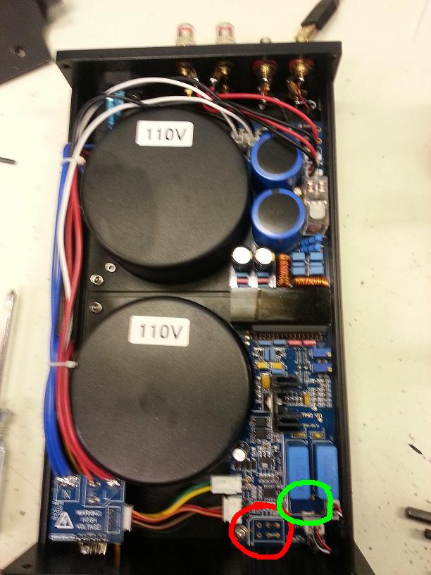

Hi All,
In the full view pic the Red circle was the POT, the Green circle was the Relay. I didn't want to cut the RCA cables that run from the back of the unit to just beside the circles, so I jumpered the PCB. The other picture is a zoomed in pic of the area of interest.
In that pic the green circles are 0R (0 ohm)wire jumpers for the relay. The red circles are 0R (0 ohm) wire jumpers for the pot. These simple pass the POS signal from the RCA connections to the input Caps. The input cap connections are circled in blue. If you flip over the board, you can get at these connections. The purple circles are the GND or negative signal reference. All the RCA negative/reference on the back panel are electrically connected to those points.
I've had this running for the last 3 months so seems to work with a passive pre-amp.

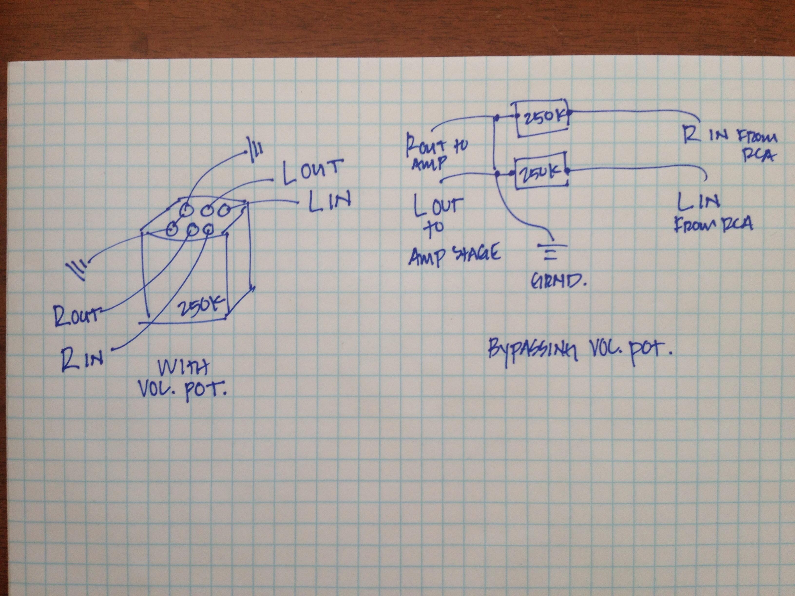

I've attached this drawing that I've copyed from the other post that I can't recall. The drawing was made by another member, not by me. Sorry I don't remember his name right now to give it the propper credit.

Hi ggmesquita,
Not sure whats going on in the drawing you've provided. Looks like there is 250k in series with the RCA lines and after the resistor the lines are hard wired to GND. Seems like the input signal would drop all voltage across the resistor and the amp would only see a GND signal but difficult to know for sure what it is feeding. This drawing seems to pertain to a very specific type of circuit topology.
In general, the pot emulates the resistor divider so the inline resistance will be small, the pull down to GND will be large. This ensures most of the voltage is seen by the amplifier input as most of the voltage is across the resistor to GND.
You could add the pulldown to resistor to the circuit and it will behave the same. Not sure what value the pot is on the TP60, either 25k or 50k I think.
Hope the above makes sense. I do not explain things well sometimes.
Mike
Mike
I see. That drawing must be specific then. When I first saw it, I thought the exact same thing, If the resistors are in series with the RCA lines, it would be the same as turning the pot all the way DOWN, not UP...
