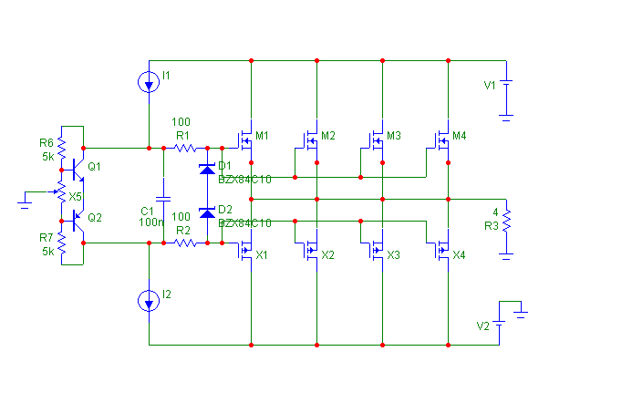

just of curiosity can you tell us what is the current through transistors T107 and T108?
And what are the resistor values of R114 and R115?
Thank you!
Cheers Michael
Streams will be higher as 50 milliamperes. Resistances smaller as 100Ω. Exactly will be decided by transistor. According to measurements based on zener diodes is less than 5V. Everything will be specified for each module individually.
Thank you Federmann,
are you going to use the popular high performance VAS transistors Sanyo 2SA1540/2SC3955 or Toshiba 2SA1360/2SC3423 for your T107 and T108, the aforementioned transistors are virtually the very best one can find these days.

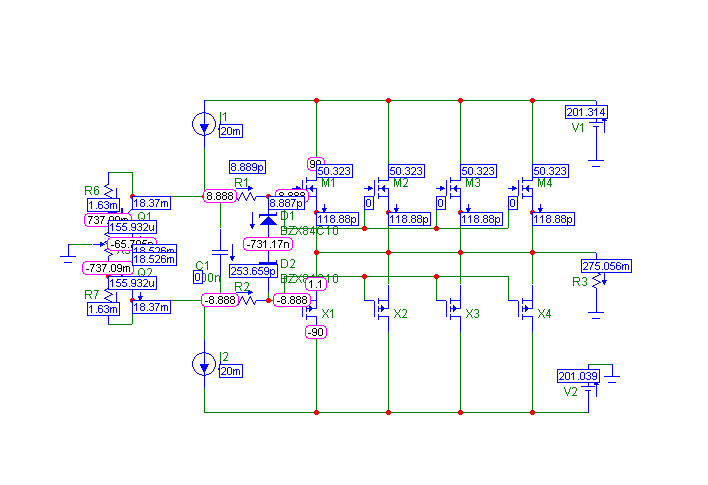

It is the same output stage, same 'protection' by 10V zeners. Wire from midpoint of zeners already added, regardless that there is no current limitation in any safe area.

Here is why it will not work well without source resistors. Let's look at Vgs = 4.5V and Vds > 10V. In that case, the drain current is:
For temperature = 25 Celsius, it is Ids = 0.6A.
For temperature = 150 Celsius, it is Ids = 25A.
That is not a reduction in current with increased temperature!
All the parallelled transistors have the same Vgs so the hottest one will work harder than the others. Drawing a load line and pointing at it is nonsense. It is current sharing that is the problem, nothing to do with the load line.
However, the BUZ9** transistors you mention on your page do not have this problem. They can be parallelled just fine without resistors.

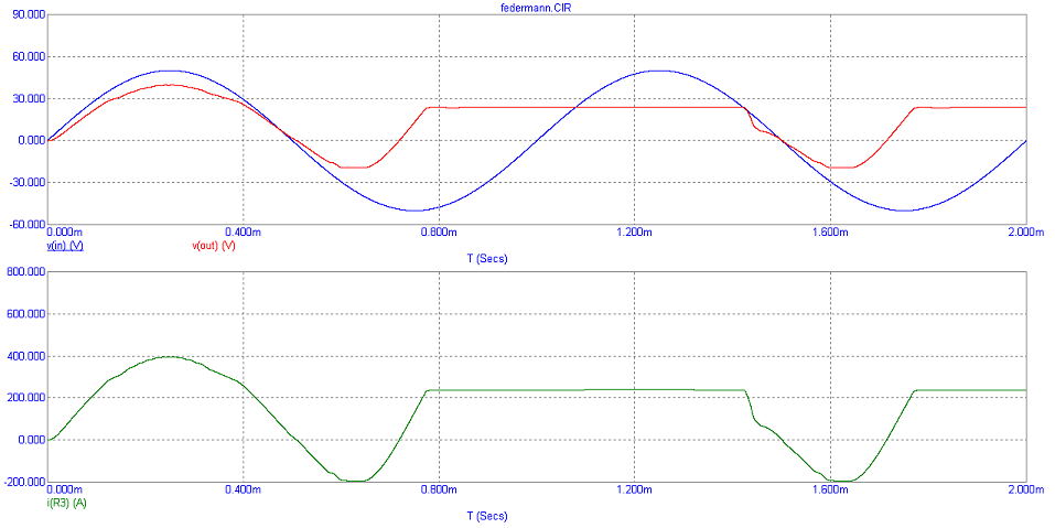

Hi Federmann,
The unanswered question is still there. Do you have a working prototype, or is it still in the conceptual stage right now? Simulators tend to give very optimistic performance numbers.
We have seen many simulated designs that do not work in real life. Therefore, I think our members are interested in real measurements.
-Chris
Hi Federmann,

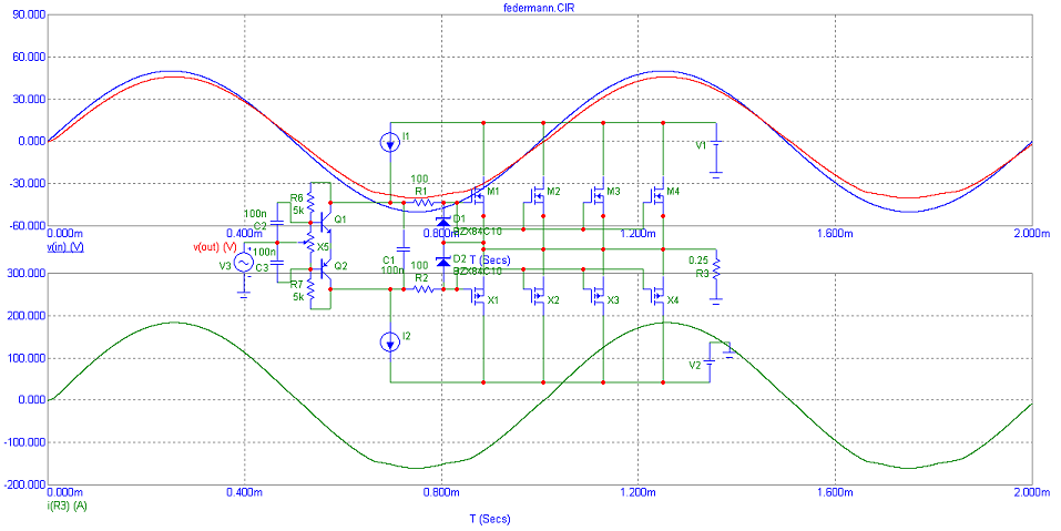

Current form, the assessment and fitting end transistors. He will be measured.
I can enter data into the simulator, so that they are not mistakes. Here you can see the correct function of restrictions.
