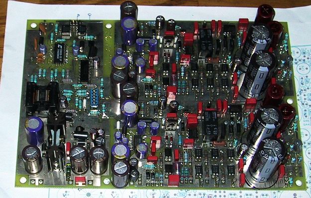

Joined 2002
Broadhurst DAC
I would also be interested in tweaks for this DAC....
Is there a NPC drop-in replacement for the BB - DF 1704 ?
Arne K
To do that, do you need 2 CS8420 receivers (one in cdp, one in DAC) or you can simply configure the one in the DAC only?
It is not ideal but -yes, I put in another 8420 in the cdp.
To get a similar solution in the dac you would need to add a DIR (like the 8412) that output 16 bit serial data, then use the 8420 in mode 2 serial in, serial out and set it to receive 16 and output 24 bits.
The problem with this is that you can not make good out of a native 20-24 bit spdif without it cutting off the 4-8 LSB's.
I'm not that familiar with Crystal chip and I don't remember the exact implementation in Broadhurst design, but I guess 8420 is in oversampling mode. How one can disable that?
Well, you can disable it but it will still not manage the bit depths properly and the whole benefit of the added master clock disappears, it gets similar to the 8414 in its function.
A 16 bit dac must be great as long as you feed it from a cdp.
Personally I would not want to exclude access to the sonic benefits of some of the native 20 or 24 bit LPCM dvd's out there..
