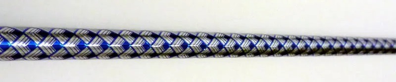

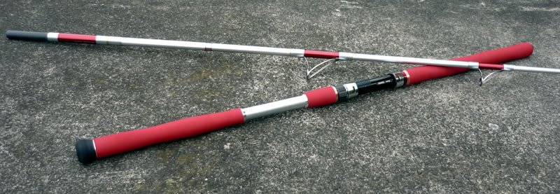

Using a fine woven glass veil and epoxy is a standard measure to preserve wood gain. Just something that I picked up by observing the pros at work. I wouldn't know where to refer. Probably the most detailed article would be mine on a forum where I am still listed as vendor and consultant for what's regarded as absolute high end for that equipment. Composites and finishes has been life work. This is an example of setting up a rod development shop in my spare bedroom and going head-to-head with the best of GT Popping out of Japan and ending up being called on to consult with, lifting their own standards both in performance and finish. These two pics are of prototypes when starting out. First attempts and tests@Randy Bassinga so you are using the 45 cut, right? Is hand held saw good enough for miter cut? Also I read again your post about the cure the cut with epoxy and woven glass. But I am not sure I understood everything correctly. So I should cure the edge before miter cutting? Is there maybe so article or more information to read about it? The woven glass + epoxy...it is some product to buy for this purpose of keeping the edges sharp?

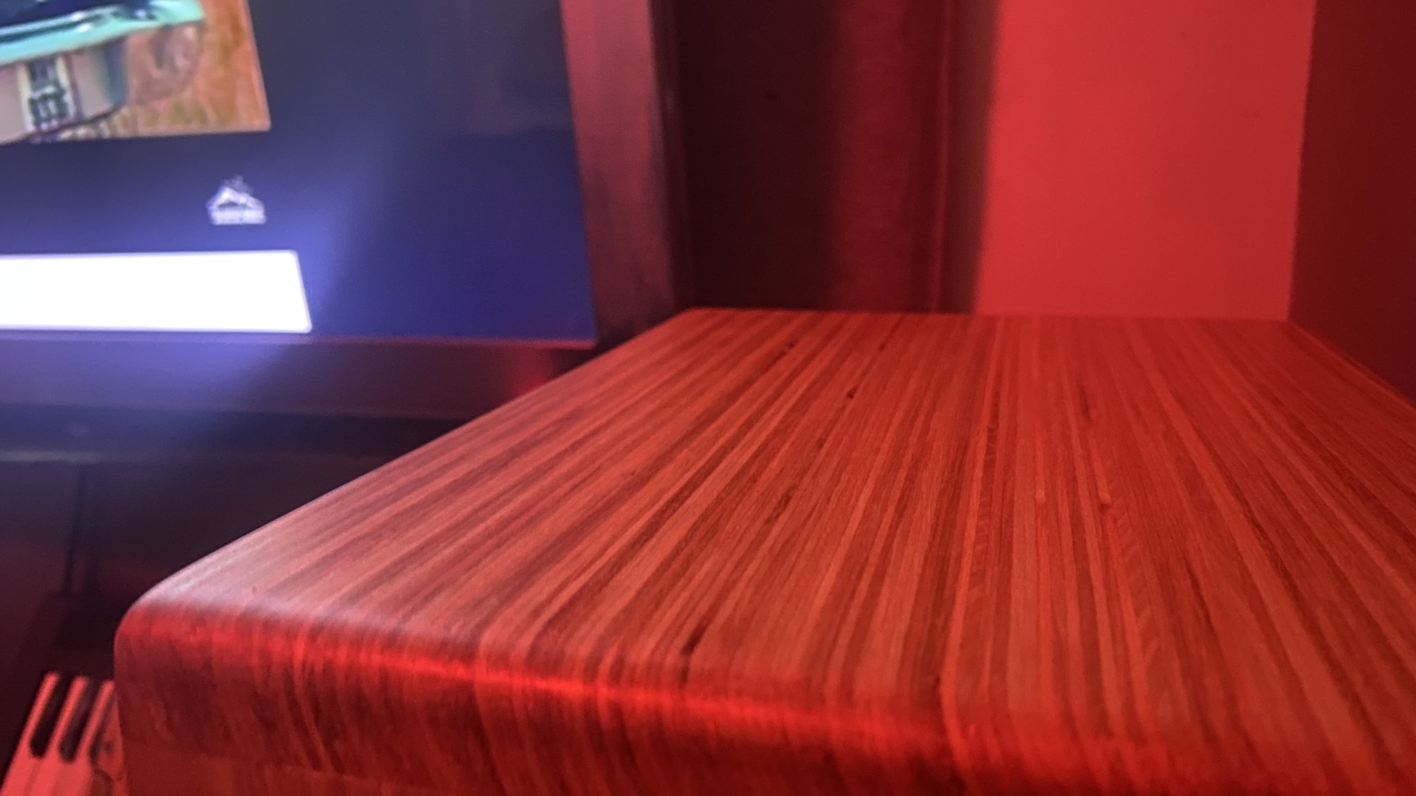

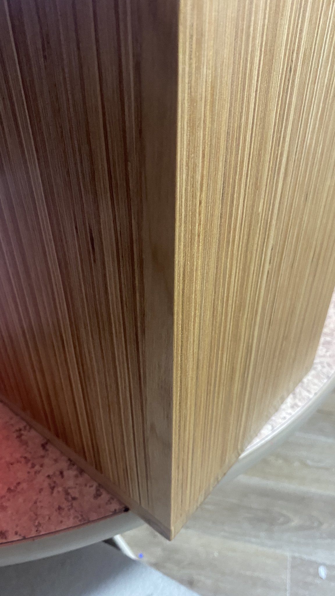

My last bit of woodwork with real timber. The surface in person looks like diamond like coating but feels silky slithery to touch. That's just water break free buffed finish really zoomed in. It's a bit of scrap that I was curious to see what a 90 seams would look like with grain ina speaker box. I think Tangent or some brand in the 90s had ads in the AU hi-fi mag that had 90 seams that looked gorgeous. I think this one is a fail as it looks like a chopping board and not a high end cabinet. It shows me that contours like that scream shortcut
The back side, apart from the razor sharp edge, another fail. The 90 seams really spoil the look. 45 done with a veil will be sharp. MDF is like sponge, one shortcut I have seen is 90 seams covered with veneer. Am I the only one that can see the seam print through?
