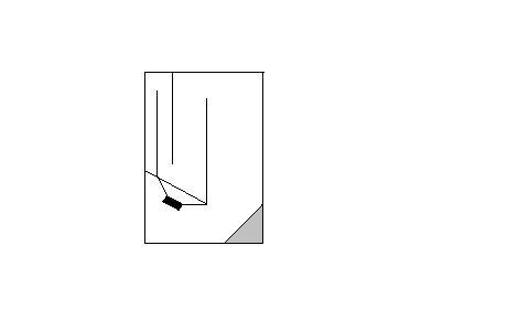

variation on the theme...
here (I hope) is a crude attached drawing based on the Half Square Antenna design that was mentioned by DKJ in the Acoustic Wave Cannon thread. I have folded the long 1/4 wave section into three to make the whole thing more compact. This causes the two (one at each end of the 1/4 wave line section) 1/8 wave sections to exit at 180 degrees to each other rather than both dropping as Dennis discribed. I am not sure if either of these two changes will have a negative impact or not. The driver loads the line in the top left hand corner firing into both the long 1/4 wave section as well as the shorter 1/8 wave section.
The idea is that the Half Square line will have four distinct nodal points of resonance and so produce output over a wider band than the cannon would with its three nodes. The cross section of the line can range from half driver Sd to 100% of driver Sd with half area yielding the smoothest response and 100% area yielding the greatest output (most ripple).
I have also attached a link to the thread page where DJK discribes the idea. I woud be interested in comments on this idea. Regards Moray James.

Hmm, all I see is a folded up offset driven 1/2 WL pipe since the driver isn't in series like a BWC........... Anyway, a half square wave sub duty pipe will be pretty big since the total pathlength will ideally need to be 1 WL of Fs (minus end corrections).
GM

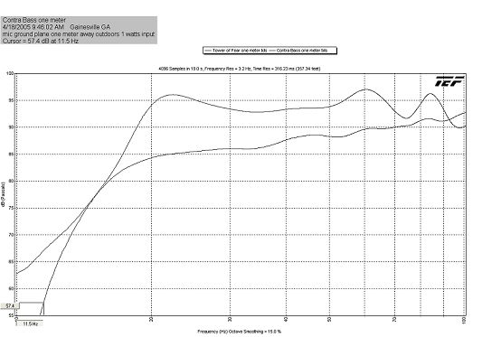

I built something akin to a "Tapped Horn" but for midrange. While working on my Unity horn, I was curious if the tapped horn concept applied to mids as well as subs. If you'd like to see the results, I'm posting them here:
Tapped Midrange Horn

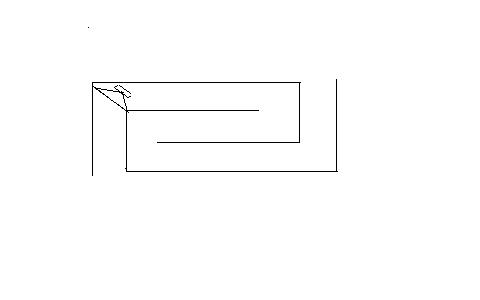

possible folding for TH112 and H115...
Here is a possible folding config. for the Danley box. I have shown the first 1/4 section of the line equal to driver Sd but this section could just as easily taper to So=0. A further alternate would be to have the line start at So=Sd. Regards Moray James.

Thanks for the picture correction, I was going to mention but thought maybe you had a different idea going there. But doesnt this actually load into the 1/8 stup and a 7/8 section?
To work properly, I believe the lengths have to be a 1/4w stub and 3/4w section with the exits 1/2w apart.
This way you get a resonance from the left pipe at 1/4w, an addaitve output from both 'ports' at 1/2w, resonance on the right at 3/4w, and a reduced addative output at 1w from both.
(or at least thats the theory)
The trick is making the responce of each 'port' wide enough, or the reasonant peaks close enough together to blend into a relatively flat output from 1w to 1/4w.

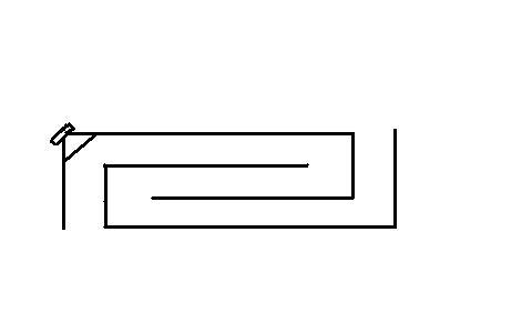

as far as I know...
the idea was to have an acoustic version based upon the antenna theory. And yes Dennis implied that this arrangement would add one additional resonant peak to the pipe making the band wider (from three to four). I was under the impression that it was 1/4 - 1/2 - 1/4 wave sections so a total of one wave length . That is huge and so I was folding to try to make the thing compact.
The design example that Dennis gave for the small 4 inch driver with the 85 Hz Fs was 20" - 40" - 20" which is clearly 1/8 - 1/4 - 1/8. so from that I figured that the lengths could be reduced to the same ratio and still workas per the antenna theory. I would like to hear from Dennis on this one. The cannon is interesting but big, but not as big as the PWT just mentioned by GM. These are in the land of built in to stay in systems.
I came up with a possible folding for Tom's Th 112 and 115 but for the life of me I cannot get it to uplink don't know why. Regards Moray James.

Reguardless of the length of the pipe, the frequency at which it will resonate is 1/4w.
The 20" segment will resonante at 170Hz.
The 60" segment will resonante at 42Hz.
At 85Hz the output from both segments will be much reduced compared to those resonant levels, but since they are 180 degrees out of phase, and 180 degrees apart in spacing, the result will be addative.
The same should occur, though at a reduced level, at 21Hz.
(image not to scale of any kind)
While this layout is basically a form of 3508 wave cannon, the same kind of 1/4w phase addition/subtraction occurs inside Danley's TOP.

Greets!
Hmm, the link in post #90 works for me. Anyway, it's certainly one way to fold them.
Not so, for a given driver Fs, they are virtually the same, with the BWC shorter only by its terminus's end corrections, though these are offset some/all by the in-line driver 'box', assuming you bother to factor these in.
When you mentioned DJK's analogy of the BWC being based on 'half square' antenna theory/85 Hz driver example recently, I just accepted it at face value due to who said it and answered your Qs based on the info presented without doing any research.
Since you keep bringing it up though, I did a bit of 'due diligence' and not surprisingly it does indeed conform to 1/2 square antenna folding requirements with the short pipe being 1/4 the total pipe's 1 WL length (Fp) and with 1/4 - 1/2 - 1/4 WL fold spacing, or in this case, 170, 340, (2) 680 Hz respectively.
Anyway, it's not a good idea IMO to think of a resonant pipe folding scheme in these terms, and especially as 1/8-1/4-1/8 WLs, so let's pick the BWC apart to hopefully get a better 'feel' for these things and how he arrived at his alignment.
The BWC is a nominally two octave bandpass (BP) device consisting of two 1/4 WL pipes attached to the driver that are 3 ft (36") and 9 ft (108") long, so using your 13,489.5"/sec SoS:
