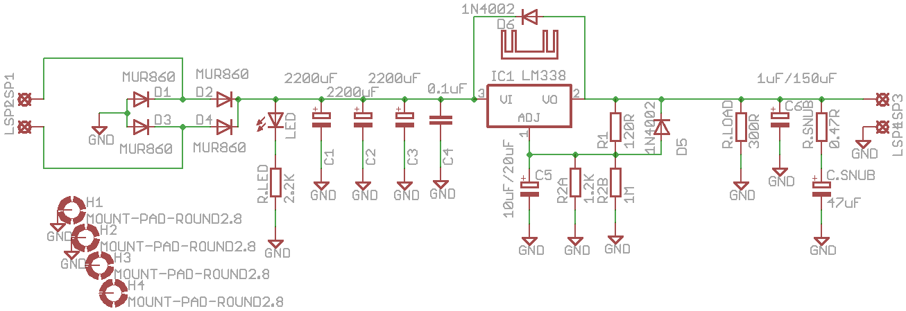

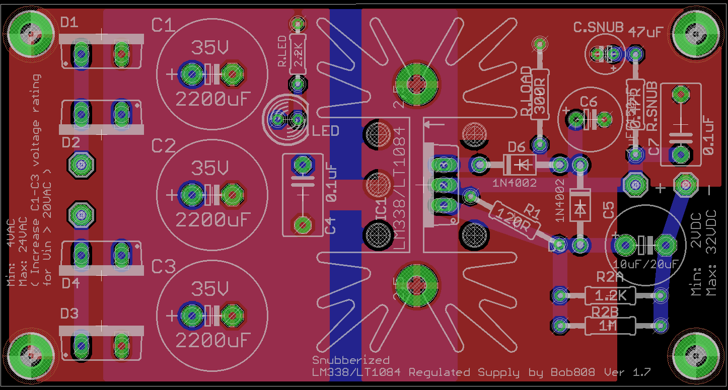

Theoretically would a LT1084 supply work? Like the one in the schematic I posted?
Recommended values for capacitors? The large cap would fall before the supply. I'd also need some capacitance after the supply, and those kind of capacitors mustn't be low esr as it throws the regulator into oscillation.

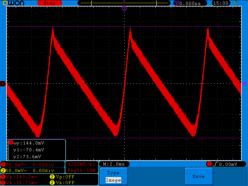

Now I'm going to look at the small signal power supply with the scope and see if it looks ok. Also I'm going to disconnect the boards that I don't need.

I just disconnected J802 from the small signal power supply. That was the feed for Dolby boards. The current decreased now to 186mA, and thus the power dissipation of the 33ohm resistor. Now it sits at a comfortable 1.15W (it's 3W rated). So I don't need to replace it anymore.
I scoped the small signal power supply and it seems quiet. My scope might pick up some noise from the line/air but that is there regardless if the amp is powered on or disconnected completely from the power outlet.
So small signal supply seems ok.

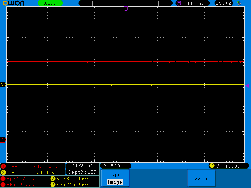

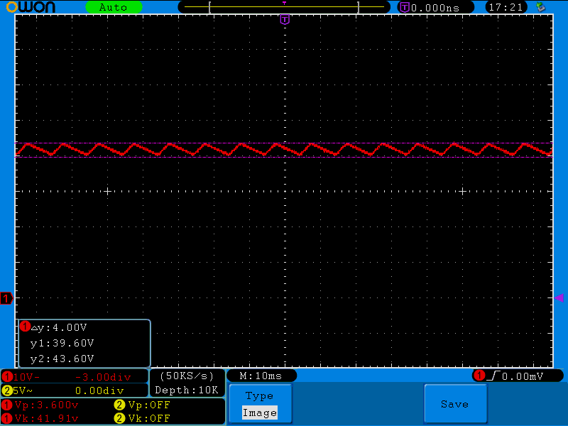

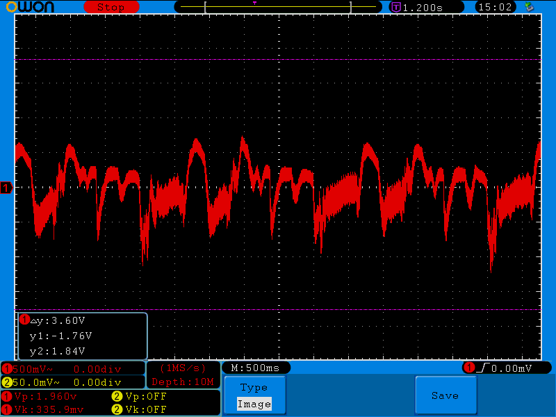

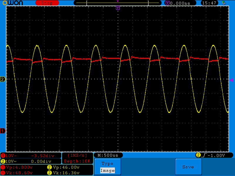

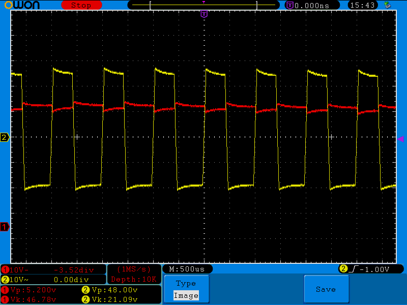

When scoping the output power supply there's ripple big time and it oscillates like crazy.
I attached some screenshots with the ripple and how it varies (AC coupled) with a horizontal time base of 500ms. Are you sure it wouldn't matter to sonics? If you say so then I'll leave it alone.

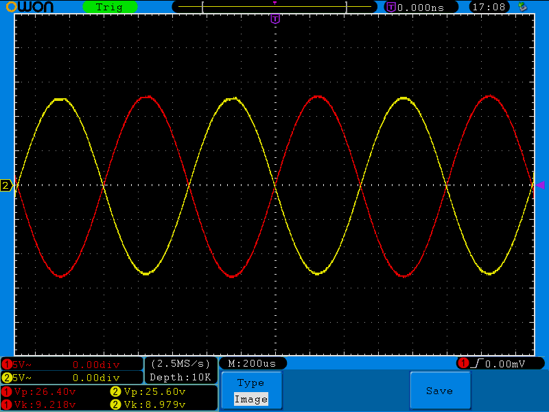

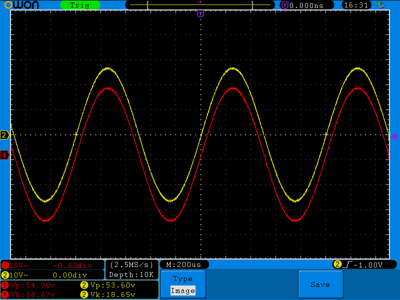

I tested the output as well.
Red trace is the power supply feeding the output boards (measured at the connector on one of the output boards).
Yellow trace is the output into a 8 ohm resistor (100W). Both channels had 8ohm power resistors attached.
Baseline is 49.77VDC power to the output boards.
As you can see the second picture is right before clipping. 46Vpp is exactly 33 watts into 8 ohm. So those are clean 33 watts and the power supply is still 48.60VD.

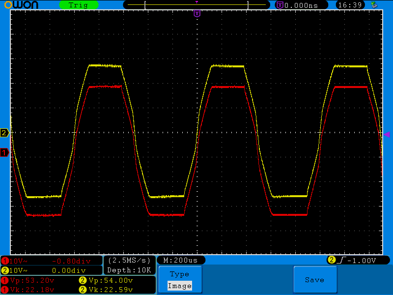

The last picture is with volume maxed out, heavy clipping, output power is 36 watts, bad ones . Still, the power supply is at 46.78VDC. So with max volume but no clipping I loose 1VDC from the power supply.

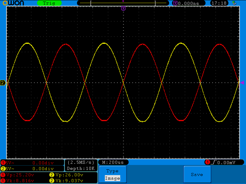

I had the back knob set on 4x12 instead of 2x30 And I switched two wires and I wasn't probing correctly. Seems like there's a potential difference between the output ground speaker connector and power output board's ground connector.

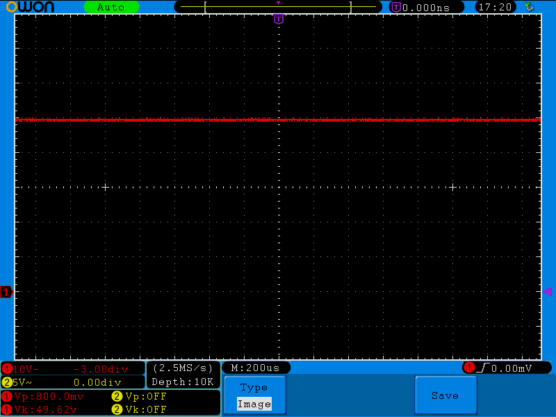

I measured the baseline for the power supply with one probe. 49.62VDC with no signal.
Then I adjusted the volume right before clipping and the power supply is 42VDC RMS and has a ripple of 4Vpp.
I scoped all 4 channels and they are symmetric and looking nice right before clipping.
The nice surprise was that it puts out 45 clean watts rms right before clipping, into each channel!
Maximum volume it goes to 64 watts RMS but ... yeah.
So, what do I owe the higher wattage to? Increased PS voltage? Output transistors?

Ripple on the unregulated power supply is normal. Connecting a scope to the correct grounds is important in low level measurements.
If the speaker is essentially silent (no hum and noise) then there is no real issue.
