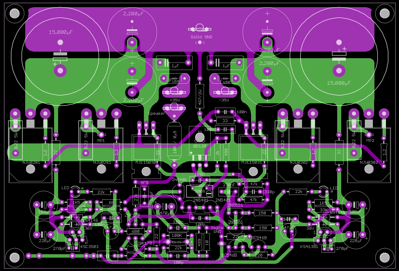

P.S.: In the meanwhile I have the enhanced (?) the on-top reservoir-capacitor layout by a new one, since I have had some luck and "inherited" a couple of "ELNA for AUDIO caps" for a very nice offering.
I wonder, how the NJW0 transistors will sound as compared to the TO3.
Best regards - Rudi_Ratlos
Harrison, thank you for you recommendation.
A German DIY-friend of mine told me exactly the same, so my efforts ended up in the attached layout: 1µF MKT || 2 x 2.200µF || 15.000µF .
I will then evaluate the differences in sound,
- when I operate this SYMASYM from a standard PSU
- when I operate it from a SMPS (SMPS300RE, +/-36VDC, 300VA)
- when I operate it from a rectifier section only

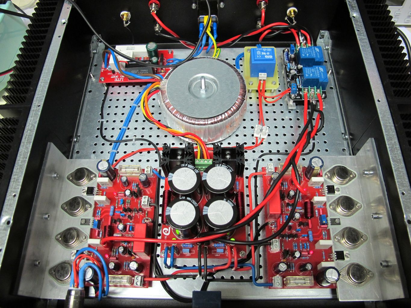

My new SymAsym TO3
Hi
I have my new SymAsym TO3 running, and I am very happy to report that having connected the amp to speakers and powered it on, there is (without input) no hum, no hiss, no noise at all, it is dead quiet. When some nice input music is given to it, the output gives sweet sound, very pleasing : it is a great amp and I did not think that a diyaudio amp could be that great sounding !
Thank you for sharing your work with all of us Rudi ! I am so happy to have had the good idea to build it using your wonderful PCBs and your Builder's Manual that has been written fool proof, all questions one could have building it are answered ! I did not think that a diy power amp could be that good !
Thank you Rudi ! I am so happy with your SymAsym TO3 !
Here is my build in the chassis.
Best regards
rephil

Very nice build indeed
The TO3 holes in the bracket did they fit well?
Yes they fit perfectly , but I will not tell you how many L-brackets I did use for the learning pourpose in order to get the experience for having this result . The result at the end did come : I am able to repeat that good result when I want it . Now I have the knowledge .
Best regards
rephil
Yes you really need to prep the surface of the L brackets so there are NO sharp surfaces above the plane of the holes. I use 120grit and a palm sander.

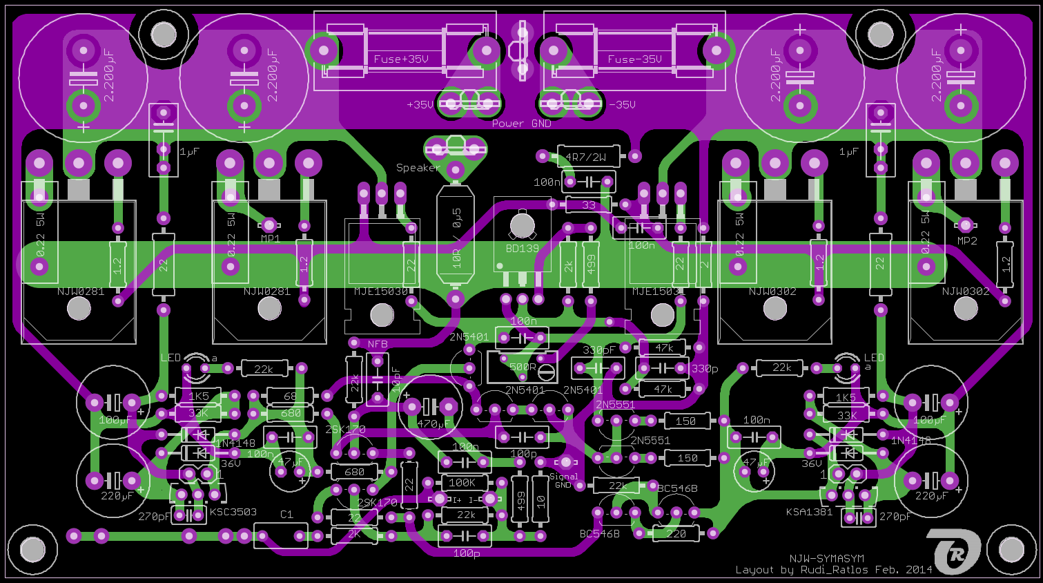

Randy, I have never before used the big SANKEN transistors in any of my SYMASYM layouts.
But I did, when I built one of DESTROYERX' DX - amplifiers several years ago, and the SANKEN sounded really well. "They rocked".
I will no more offer the TO3-version of the SYMASYM. I did a new layout using NJW0281 / NJW0302 that need to be mounted beneath the PCB.

Gentlemen, I feel very happy and will offer you some (at most 12) PCBs of my current layout of the "R-SYM":
http://abload.de/img/r-sym005yckvk.jpg
The current layout is using NWJ0281 / NJW0302 transistors that have to be mounted beneath the PCB.
The size of the PCB is 140 x 80 mm.
The heatsinks that I am showing come from TME.EU and cost about 6€ per piece.
2 PCBs incl. worldwide shipping will cost 20€.
If somebody is interested in these PCBs: please tell me.
