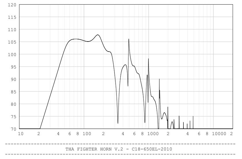

update cnn news on my thread. if not update seems very hard to find my thraed . these pics about 18 tha f horn built. the first pic a wood worker man from europe helps a lot. these pics about 18 tha f horn built. the first pic a wood worker man from europe helps a lot for built these cab.

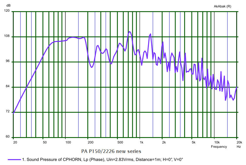

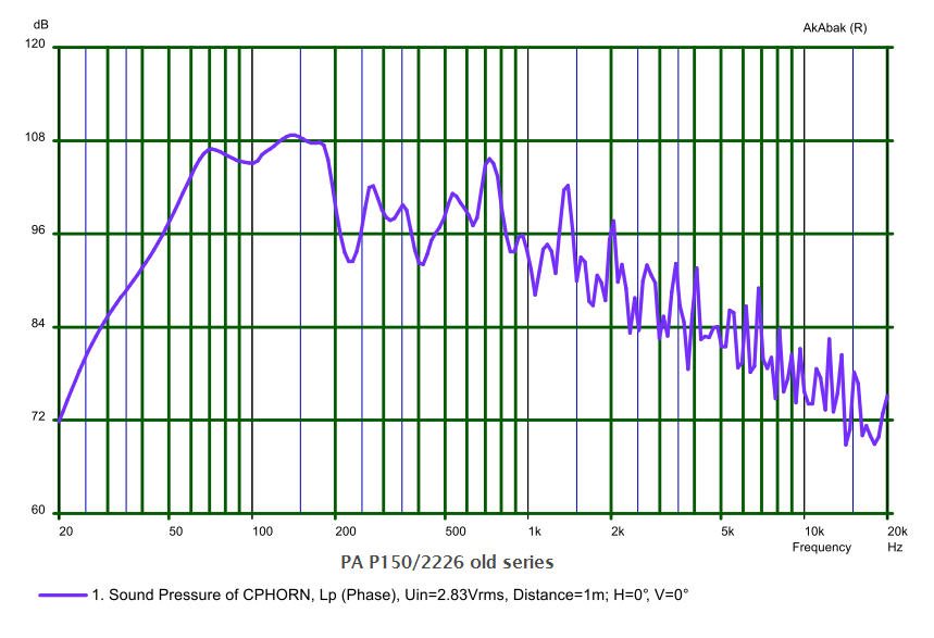

these pics about the Kane drv. this drv from thai group in chiangmai. they order oem from china. its very cheap in some series. the name of this series is intanon. intanon is the name of highest mountain in chiangmai city.
