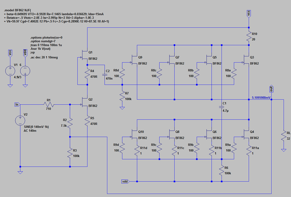

Although I do not normally build amps with output coupling caps, I find this a very clever solution for a portable.
So I have taken the liberty to play around a bit with the circuit.
I hope you would not mind.
Here I share with you my simulation results.
I use one type JFET throughout (BF862 SOT23).
This has lower noise than both J112 and ZVN4306.
Even though bias is a touch lower at 50mA, I can still get comparable performance into 32R 1Vrms.
-3dB bandwidth is > 3MHz.
And the use of JFETs simplfies the output White Follower considerably.
Best regards,
Patrick
I built this amp but am having problems getting it to work.
http://www.diyaudio.com/forums/pass-labs/146310-bf862-preamp-45.html#post4919251
I don't know how stable the voltage at the drain of Q2. The amplifier has to have to adjust this voltage trimmer resistors R4 or R5.
Is there anything wrong with moving the cap in front of the White follower stage? With clever Idss selection and some tuning of source resistors we can make the remaining output DC go away.
Ah, pls note the typo: the supply voltages should be symmetrical.
Amp works! I had a bad wire from PCB to the headphone jack. I am using 33R source resistors on the bottom to get 12mA bias current in each leg for 48mA total bias. Running 17v DC from a XL6009 DC-DC booster module. Has capability of being driven from 5v USB type cell phone battery for a nice portable class A amp.
Sounds great in stereo.
