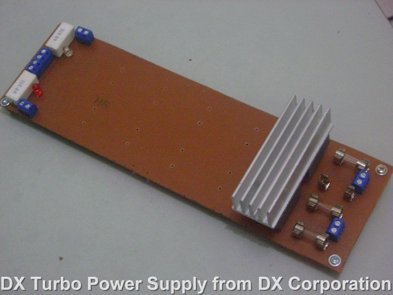

Thanks Carlos for the information. Anyway, I already mounted the capacitors mentioned. This is the only available parts I have. I believe this will already serve. Haven't bought the electrolytic caps yet. Maybe on weekend. Maybe 10000uF/ 80volts only. The 100volt version could no be accommodated by the board. Another thing is that the 10000uF/100V caps are screw type and not solder types. Besides the power these caps will be handling are only 70volts. I just hope the power will not soar to more than 80volt in case of fluctuation.

a 230:50Vac 4% regulation transformer will give ~76Vdc when fed with 240Vac.
If the tolerance of the mains is +6%, then 254Vac will give ~80.5Vdc.
Yes, 80Vdc caps will survive in the short term. Many would not use caps this close to maximum rating. The higher leakage at ~ Vrating will make the caps run warmer than the ESR normally causes.
This will shorten their lifetimes.

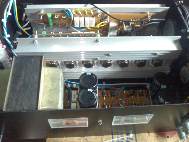

and the old amplifier i made with 8 transistors per channel. I got the design from an Electronic Enthusiast book. Sound good and clean but I'm sure this will be no match for the DX Turbo Amplifier. I can't wait to see these monster playing. I got 4 Targa 3-way speakers that I'm planning to put in a tower enclosure box. Each speakers has 150 watt ratings which will soon be dedicated for the DX Turbo.
Thanks to Carlos and the rest of DIY fanatics who made this amplifier possible.

Actually I don't have the transformer yet. I'll get one soon as the PSU board is completed. Correct me if I am wrong.
A 220V transformer with 50V AC output when connected to the PSU board will give you about 70V DC rating which is 4% rail from 50V AC out of the transformer. If I get a transformer with 45V AC out, then I might get about 63VDC output from the PSU board which is quite safer for the amplifier.

no.
A 220:50Vac transformer will only give 50Vac when fed with 220Vac and the secondary is loaded with resistors to draw exactly the power rating of the transformer.
If you feed 240Vac, you will get >50Vac.
If you run the secondaries open circuit, you will get >50Vac.
If you feed 240Vac +-6% then expect the secondary voltages to be all over the place.
Do the sums and then make the informed decision.
You should be asking; "what voltage range will a x% regulation transformer rated @ yVA and specified as z:50Vac give for a mains supply that varies from Avac to BVac and usually runs at CVac".
