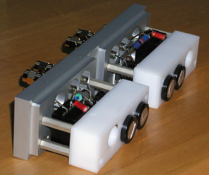

Looks great! How did you mill out the back panel? It looks much more professionally done then the first one.
Also, is that a Noble 50k pot?

Peter,
In your tight P2P wiring do you use any special trick to keep your layout uniform or is it just practice? I can get mine fairly tight but not nearly as tight as yours and the components tend to flop around a little during the soldering and don't maintain a neat uniform appearance between channels. Aligator clips work in some cases but not enough to make a difference. Any pointers?

Very compact, nice Peter!
But are potmeters not very impractical for dual mono ? Why don't you use stepped att. ?
BTW: are your BG's larger than the ones on the 47 labs picture. Jean-Paul had bought some 1000 uF BG's that were very large, diameter larger than the width of the opamp!

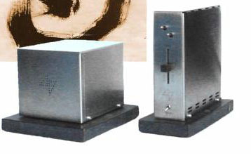

Peter,
I was reading one of the Gain Card reviews, and the reviewer
mentioned that the GC is so small that some large speaker cables
could make connections cumbersome. Since the GC isn't big and
heavy the cables could tend to drag them around. So i guess
adding mass to your amps could be good from a practical point
too. I would imagine that your amps weigh more than the
Gain Card does?
Has anyone looked in to cloning the integrated amp? I think
it's a lot cooler looking than the GC.
((Peter needs another project, right?!!))
m.

Those BG are 22 x 36mm. I wouldn't be so sure that 47 Labs using BG, they take the jacket off for a reason, right?
The panels are done by machine shop now and are polished at the same place as Sonic Frontiers and Bryston are done.
When I do p2p are always go with a simplest and shortest connection (and this can be done only one way) so it's always uniform. I never use aligator clips, just my fingers, tweezer and small scredriver. The solder diepenser usually end ups in my mouth.
I'm not using switching pot, since it's more complicated, bigger (woudn't match that design) and more expensive. I found out that a pot can sound pretty good too, the one I'm using is dented so stereo adjustment is easy. I also match them, so tracking is very good. It may actually sound better than switched one with average resistors. And it's Nobel.

I need 1/4" notch for mounting purpose. It leaves 1/2" on the outside. 1/4" would be a minimum for good looks, but when you are facing $3 price premium for extra material why not go for better look (and feel) of half inch?
Two inches are not practical.
