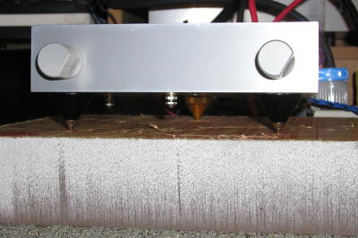

This is my last improvement for today. I installed 3 improved spikes under my amp and I couldn't believe the improvement in sound;).
While I had some doubts if Kimber cable was OK, or diodes were not too soft in trebles, after the spike installation everything just got right into focus and now I understand what they mean when saying that soundstage opened up. Everything became so coherent and right that the big smile still didn't disappear from my face.:)
I was listening to old recordings and was discovering them again, hearing new sounds that I was not aware before (and I'm not kidding).
Now, if you look carefully there are two steel spikes in front and one in the back. The one in the back is brass and I put it there on purpose. While steel spikes provided very nice bass extention and definition the top end was a bit too harsh. Substituting one of them with a brass spike, made everything sound smoother and
more pleasing. The spikes are highly recommended. The amp is resting on 2.5" acrylic board.
moderator's note: this post engendered a long side discussion moved here: http://www.diyaudio.com/forums/showthread.php?s=&threadid=11742&perpage=15&pagenumber=1
