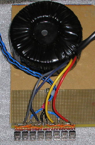

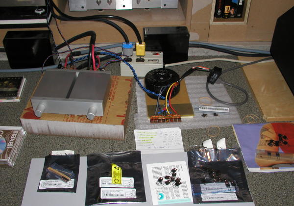

So I spent 4 hours today comparing different diodes. This is the choice I used:
MUR1620 (hexfred) $1.66
HFA08TB60 (hexfred) $2.17
8ETH03 (ultrafast) $1.00
15ETH06 (ultrafast) $1.39
MUR820 (schottky) $1.08
MUR1520 (schottky) $1.71
Beside are the prices in CAD for quantity 10 and more. All available from Digi-Key. And here's my test setup.
This was the first time I really compared dides and I have to admit that in some cases the difference in sound was comparable to placing different capacitors in a circuit. I also noticed that diodes (like resistors) are directional .
I was looking for a natural sound, something that draws my attention and don't allow me to get bored fast. I didn't want the mechanical sound.
The choice wasn't really easy, because all of those diodes are decent quality and supposed to be better then standard rectifiers.
First one to be put aside as least appealing was 15ETH06. Thet's the one I liked the least. The other one that was definitely different from the rest was MUR1520. This diode sounded most natural and grabbing attention. It had very good detail and resolution, probably because it softened highs a bit. Also the voice was very laid back, but sounding very narural, without the glare and harshness that other diodes provided.
I didn't test MUR1620, because being common cathode diode, it didn't fit my circuit.
The 3 other types were pretty close together, with MUR820 close to MUR1520 in character, without softening the trebles so much though. I thought that this might be good substitute for 1520, yet I found it less engaging.
The 8ETH03 was also nice sounding and it was probably the second after 1520 that was drawing my attention to music. The HFA08TB60 being the most expensive of the bunch was also at the end of my list. Actually I couldn't find nothing wrong with it, it seemed to be most neutral, but I thought it was also most mechanical sounding from the group.
So here it is, the quick overview of some of the diodes. It is only the first impression I got and more lengthy listening sessions are in order, but as they say, the first impression is usually correct. Also that choice is probably very dependant on the rest of the system and listening preferences and may vary. My choice for today is MUR1520.
I'm always open for other suggestions and ready to try more. Next thing I will try, is how the umbilical cord from PS to the amp affects the sonics.

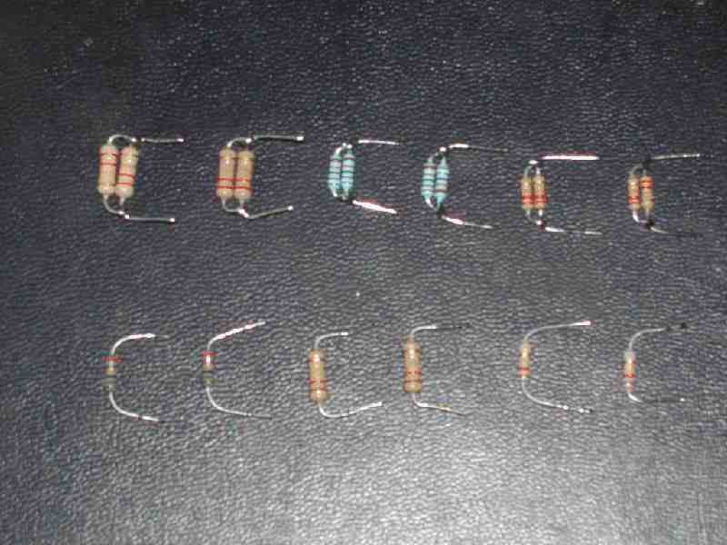

Peter: I bought parts for my gainclone yesterday, the shop hadn't 3875 nor 3885, so I use two TDA7296
Now, I've seen your shematic, and I just realised you suggest 1W 10kR and 1/2W 220kR resistors, but I use classical 1/4W metal film ones
Is this a problem? I don't see the use for such powerfull resistors, can you please explain why you use those?
Nothing wrong with different parts. It's just that I used the listed ones and they make the amp sound really well.
