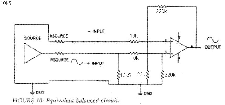

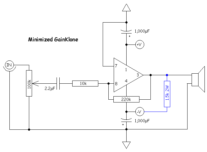

does anyone have an idea how the Thor/Peter Daniel minimised gainclone can be converted to balanced input?
I suspect you would do it one of the usual ways. the best solution of course is a suitable input transformer. That failing make the usual pseudo balanced input. Nelson Pass has used it a lot, it's described and shown as part of the A75 Article, part 1 page 12:

Please forgive me Kuei Yang Wang but I'm a bit of a newbie.
Do you mean that I can drive the op-amp as is with a balanced signal from a balanced pre-amp as long as the input impedance of + and - signals is equal?
So I just add a resistor to the other signal line of Peter Daniels gainclone and I'm done?
Why wouldn't I want to drive the amp this way? You seem to have some doubts on whether balanced operation is suitable.

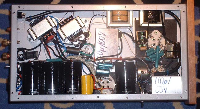

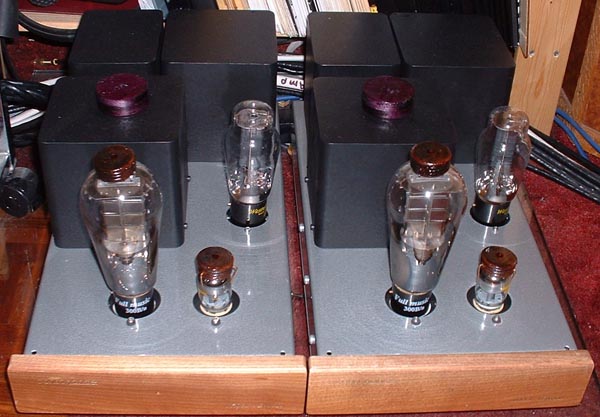

PS....
Here my latest "clone". It's not really a clone, but these SE 300B Amp's are inspired by Gordon Rankins Triton/Napoleon Style Amp based on the Chassis and iron of the DIY HiFisupply "Billie" Kits....
Modestly obliges me however to say that many features in this amplifier are my own and have nothing to do with Gordons Amplifiers. What I did nick from him are the Gridchok on the output valve and the use of the 437A as driver with an input transformer that offers up to 12db passive gain....
Sayonara
PS, these amp's sound a LOT better than a friends inverted, battery powered Gainclones, but so they should for the investment and design....

Okay. I have redrawn Nelsons Schematic a little (no Circuit Drawing program at hand here) to clarify the application to an inverted gainclone (including the "unconditionally stability resistor").
I in general do not feel that balanced connections offer advantages, UNLESS they are executed using transformer coupling. Note also that I called the input type shown here and described by Nelson Pass as "pseudo balanced", indicating that it does not operate fully like a balanced (transformer) input.
In many cases the balanced outputs of preamplifiers incorporate extra circuitry over unbalanced outputs which usually do not help the sound. In my own system I use balanced Inputs and Outputs EXTENSIVELY, however the inputs are either naturally balanced or via transformer and most outputs are via a transformer (only VCR na d Phonostage have unbalanced outputs actually).
