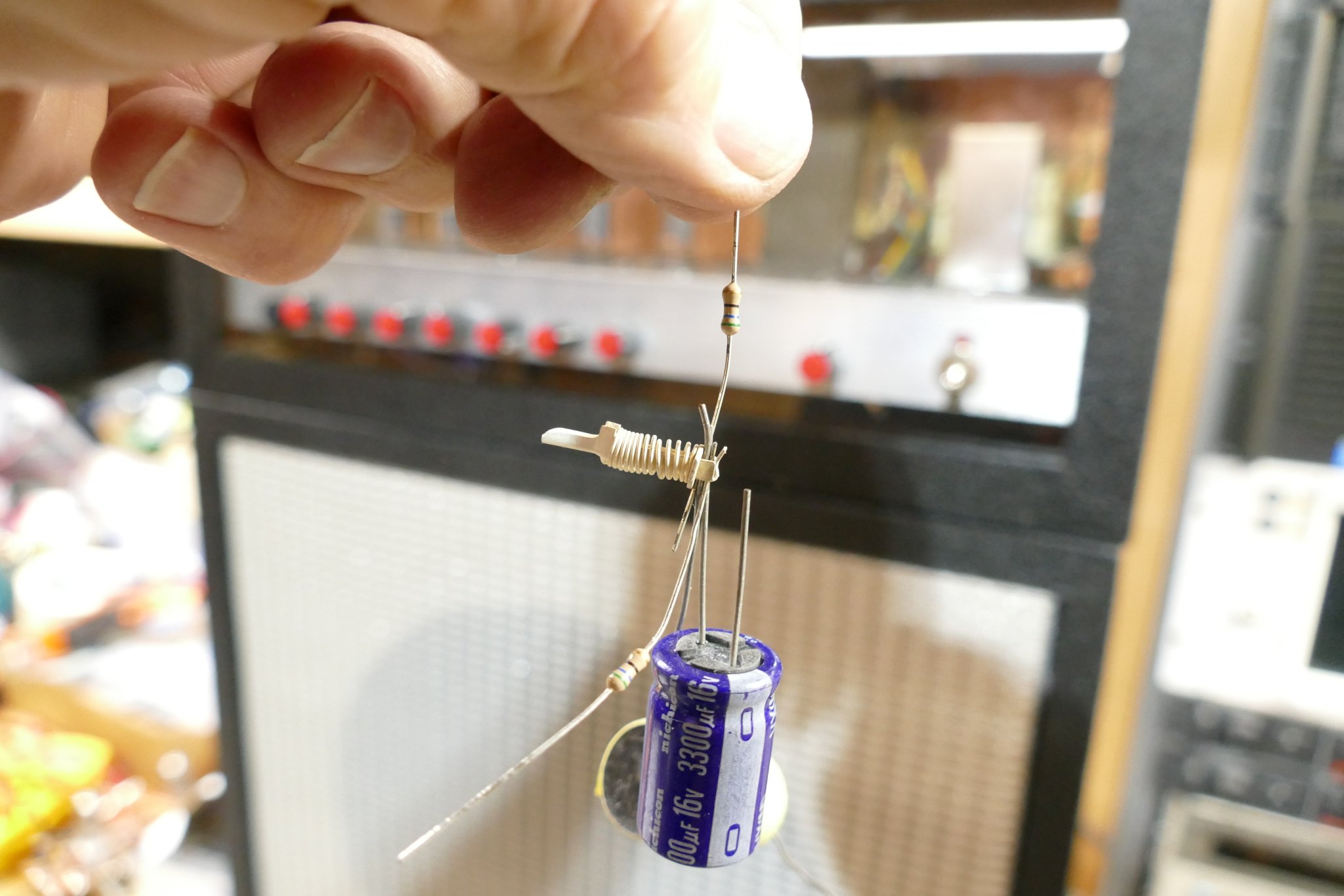

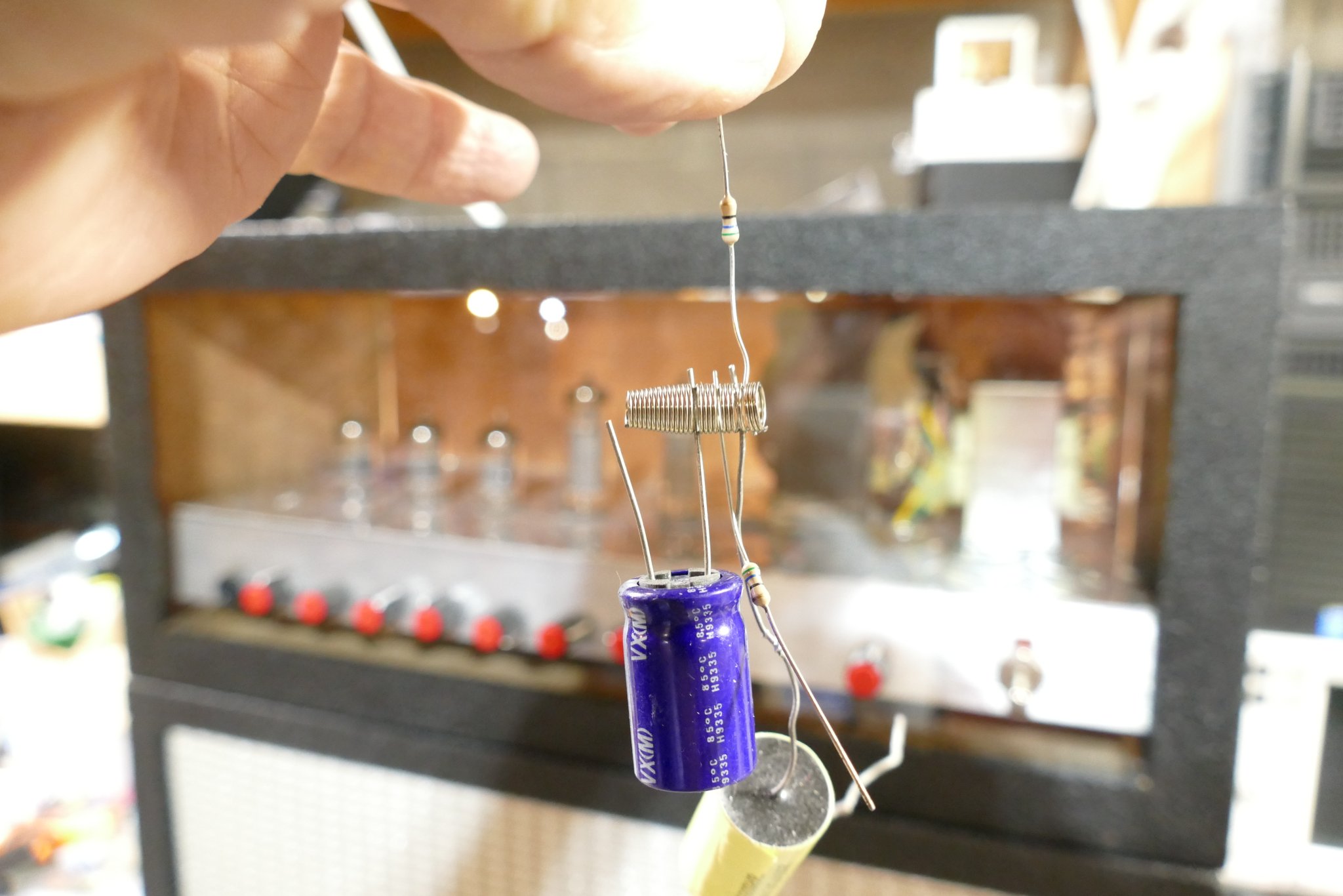

Tubelab_com said... The T30-2 wire grabbers from Ebay arrived this morning. They are obviously old and a bit tarnished but will work fine for my breadboard use. These will be used in the construction of several breadboards, each of which will contain one tube socket and the parts for a minimally functional circuit block using the T30 clips to allow for easy solderless parts changing where the dip switch and resistor bank is not feasible. The circuit blocks will be things like a pentode gain stage, phase inverter, dual gain stage with a twin triode tube, FMV triode stack between two triodes. Baxandall tone stack between two triodes.......

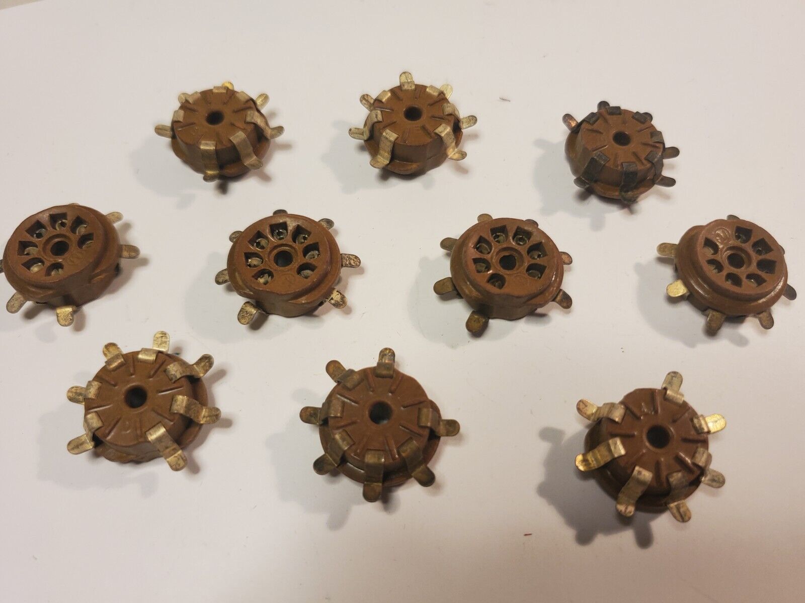

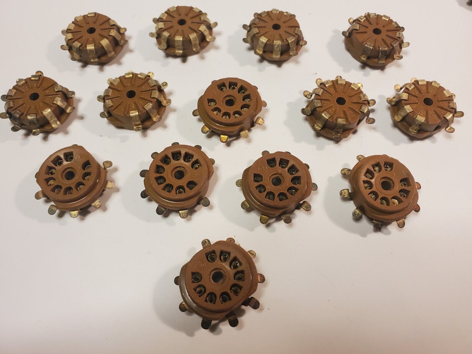

"Push-in or Snap-in sockets, almost Surface mount."
These things were made to snap into a hole in the phenolic PCB. There were quite a few AA5 radios made with these things. They used a rather small PCB and 7 pin miniature tubes, which worked for 4 or 5 tube changes. Unfortunately, there were a few TV sets made with them which were total junk. Imagine reaching into your TV set to pull out a tube and finding the socket on the end of the tube with pieces of the copper traces hanging. Use these at your own risk and epoxy them into the PCB or flatten out the pins and screw or glue them to the top of the PCB.
About 15 years ago a forum member here made some prototype sockets like yours. I still have some of his blank boards. Maybe it's time for someone to do it again. Octal relay sockets show up on the usual surplus sites from time to time. Most work fine for vacuum tubes, but the really old crusty looking black plastic kind start to smell funny with a glowing red 6LW6 in the hot seat.
Totally agree. The original big hole PC usage for these push-in thingies were disastrous, that's why they're still so cheap. But T30 pins and PVC pipe caps might work out for them. Haven't tried them yet, but got a couple coming soon. Looks like a 3/4" hole PVC pipe cap needed for a 9 pinner.

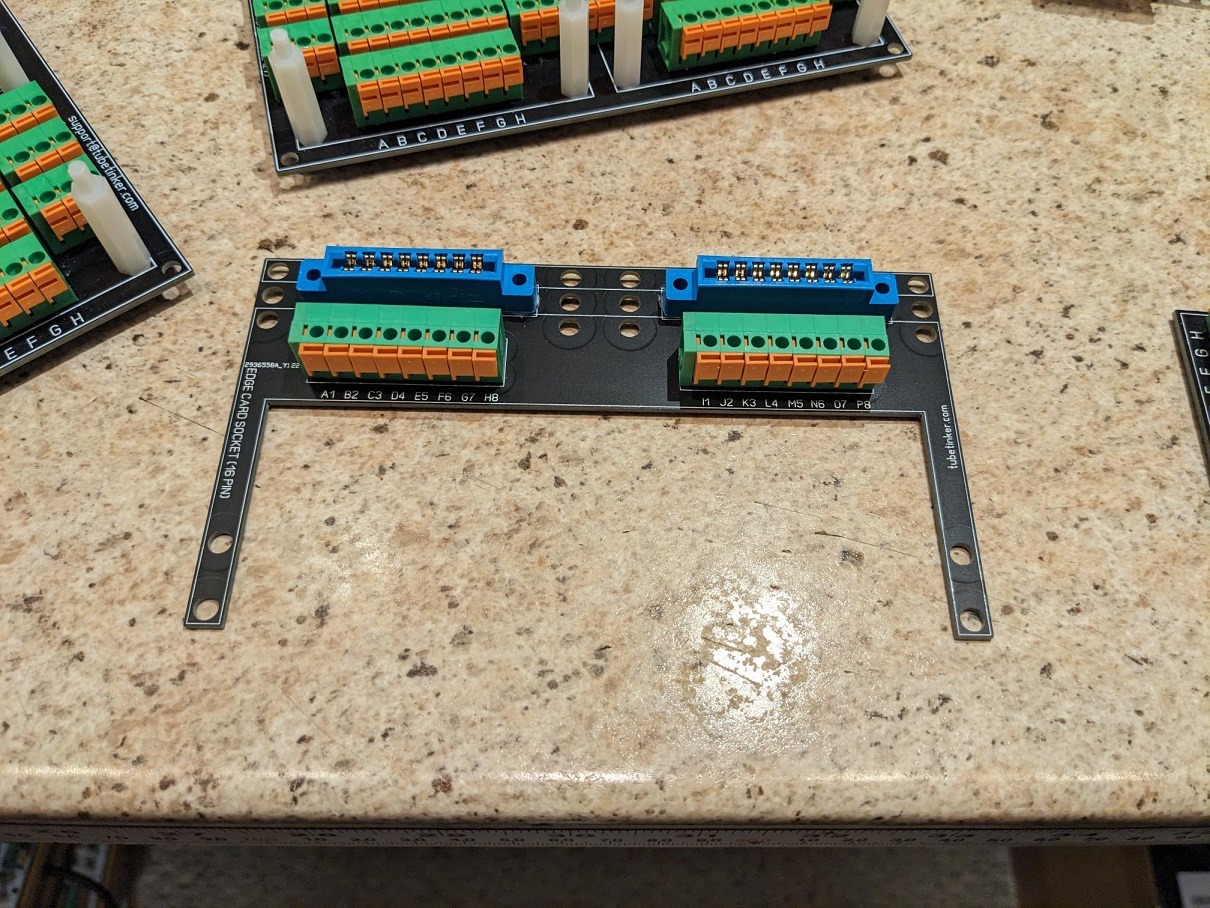

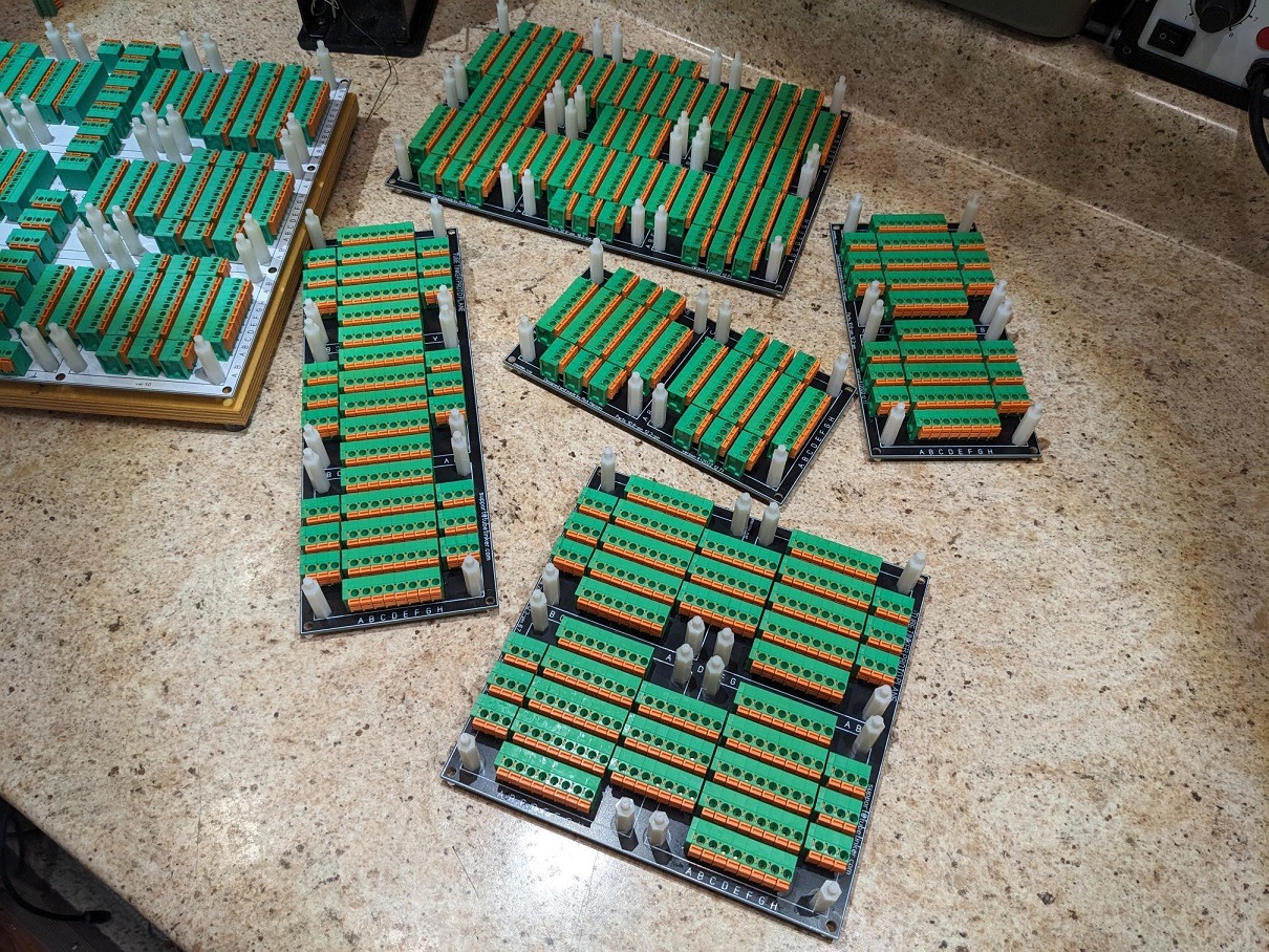

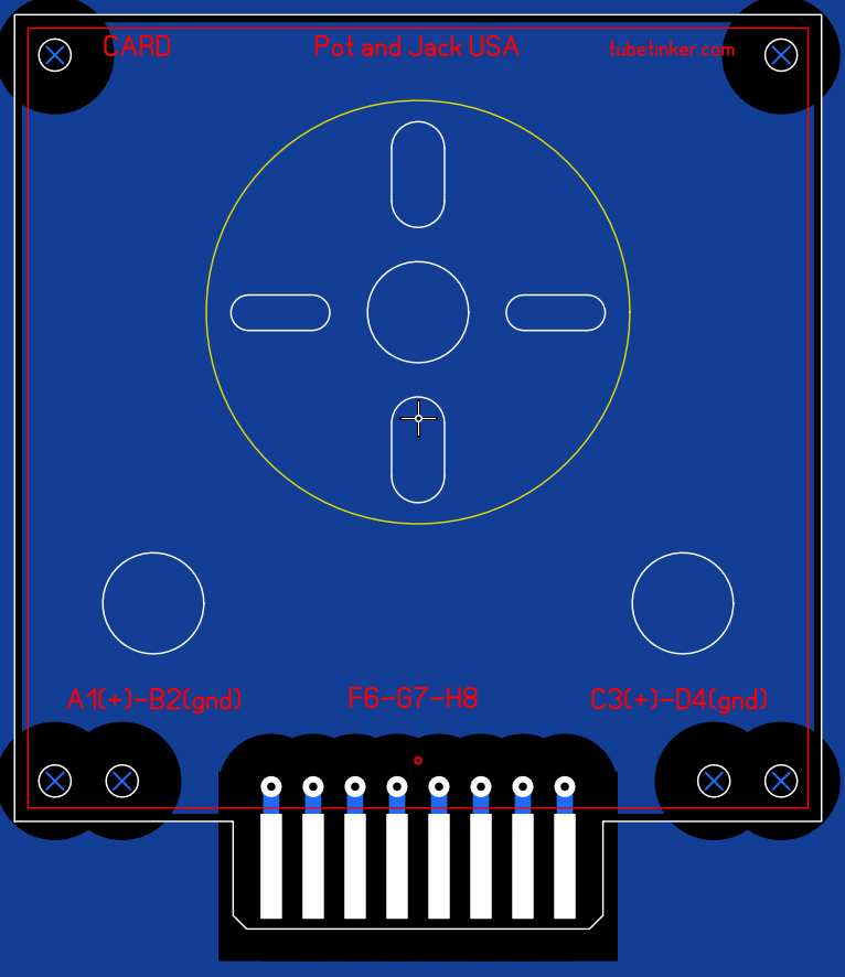

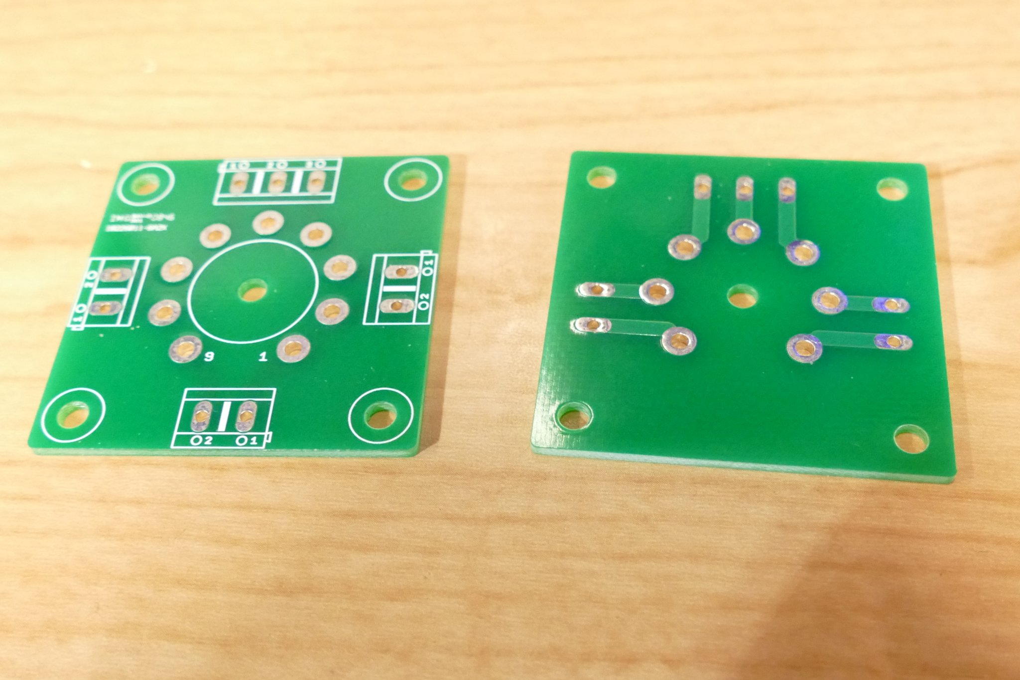

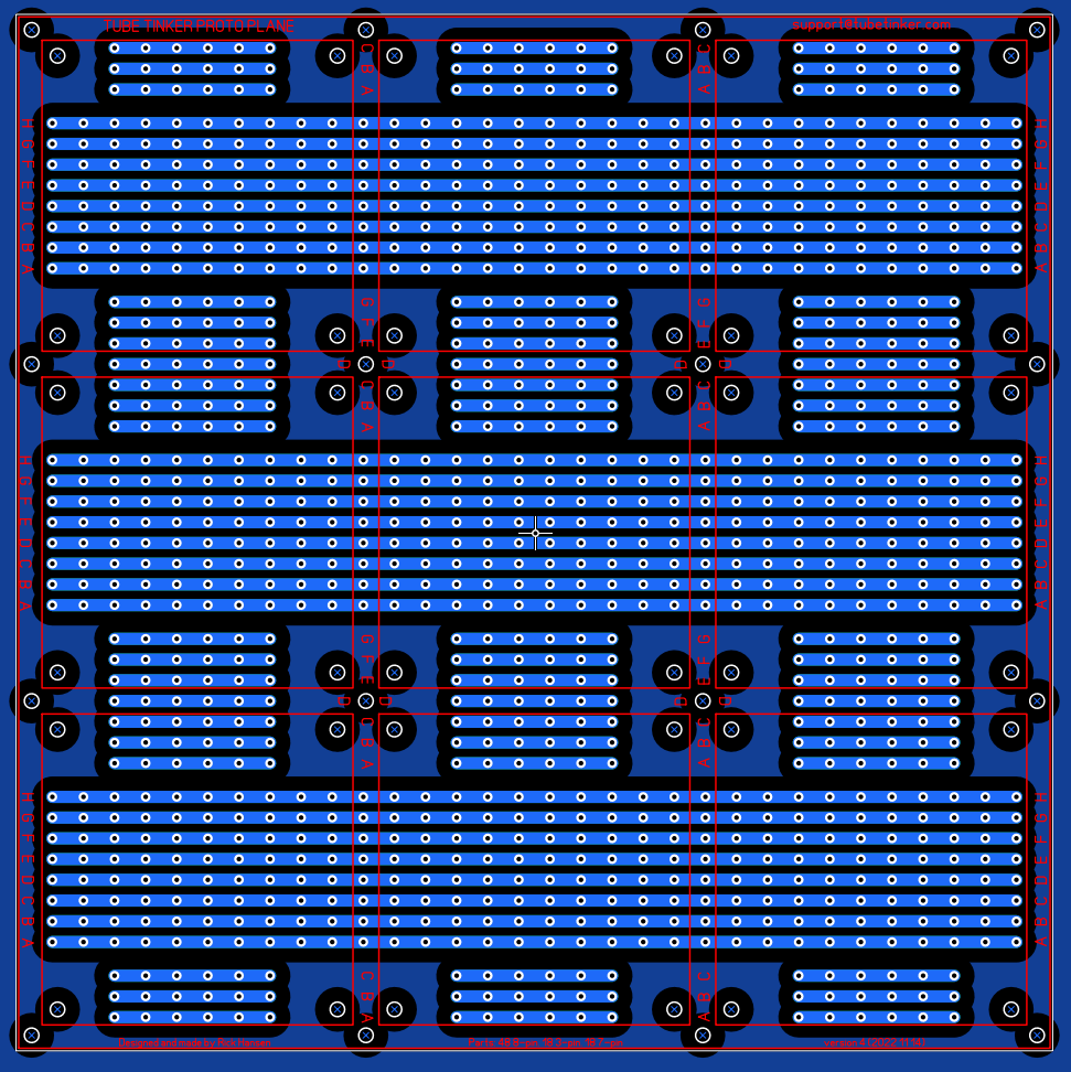

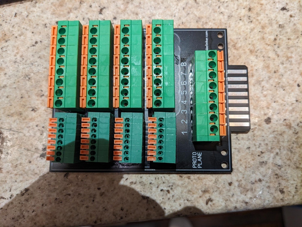

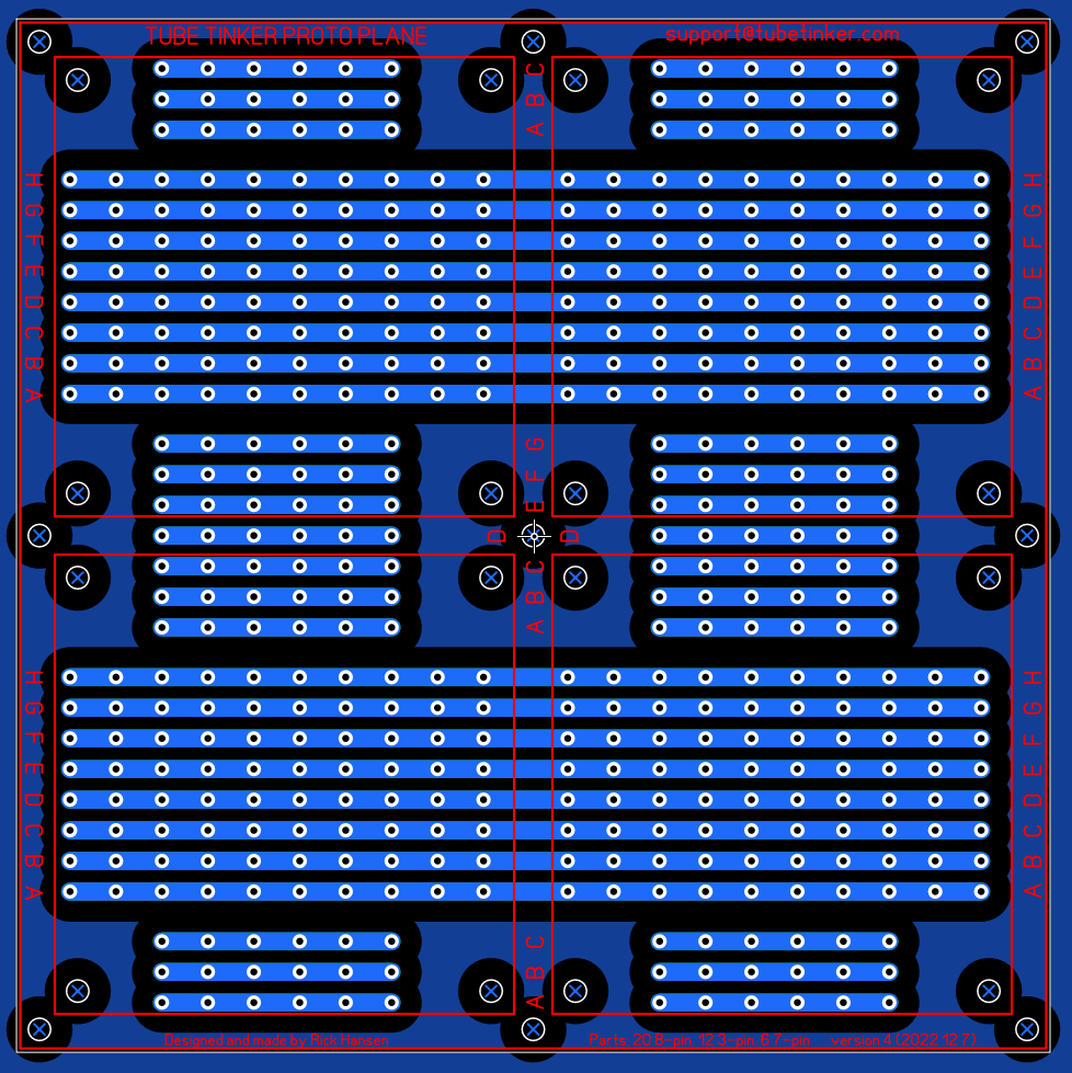

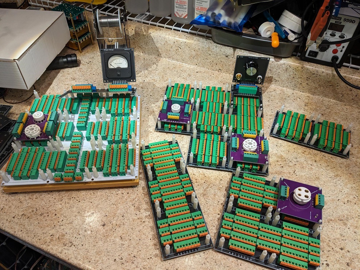

I guess now is as good a time to unveil something I thought might have commercial value in tube breadboarding, something I call my "Tube Tinker" system. I've been obsessed with breadboarding fun since I started this hobby, so that's why this Norwegian mans post was so delightful to me. A while back I found these vertical spring clip that can accept any wide size tightly from 30AWG all the way to 14AWG. Each hole can also accept a bundle of wires of the same diameter, great contact. I've arranged these on a PCB "row" pattern similar to the usual solid state breadboards. Additionally I standardized the mounting hole spacing to accept M3 standoffs where other smaller boards can be stacked for tubes, sub circuits, etc. Additionally I began to make some stand up boards as edge cards that can hold pots, jacks, meters, rheostats, etc. Here are some photos, you get the idea. Also a sample of how one of the many different PCB's shape out. Now that I think of it, I can probably build the pre-wired circuits of Helge's tube tester on edge cards, plugged around the perimeter like he did. Then any circuit, like the opamp for example can be improved later just by making another edge card plug board for it. Note how tube socket overlays can be made and just dropped onto whatever section of the backplane you want it, same for edge card sockets.

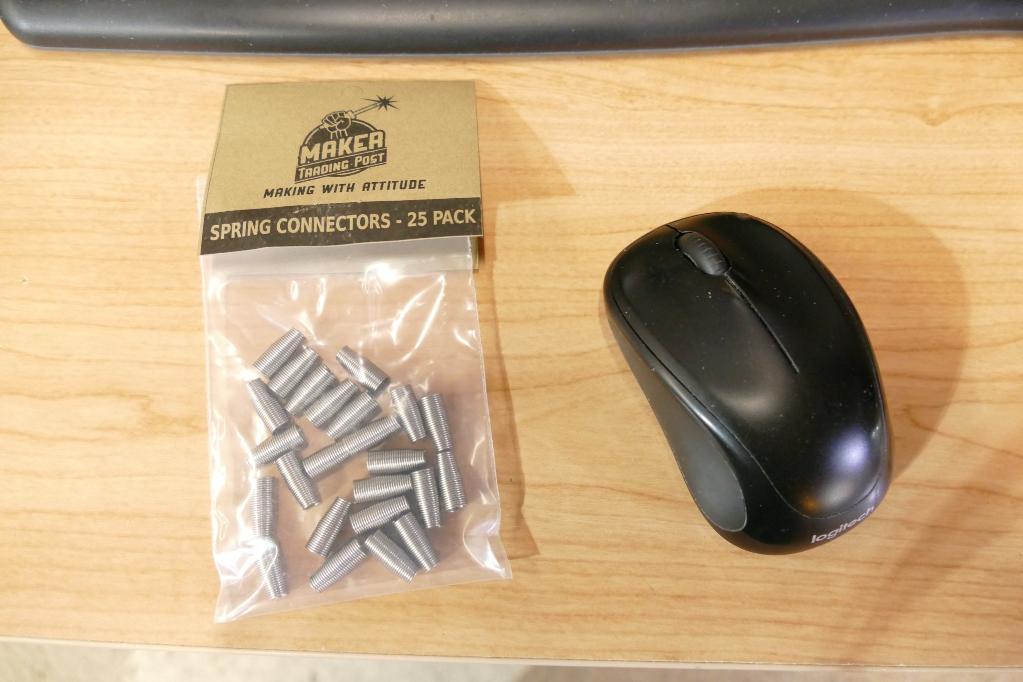

I tried a Wago, and a couple other lift lever solderless wire connectors sold on Amazon. They all failed the 4 wires of three different sizes at the same time test. These little T30 thingies are the clear winner here, though the spring things from Makers Trading Post worked OK as well. It took a bit more fiddling to get all 4 wires into the spring than it did the T30.
That post was long so continuing... The more I think of it I should leverage the work I've already done designing (with many JLCPCB iterations) these prototyping boards with these great vertical spring clips. Helge's tube tester nicely arranges the grid, cathode and plate circuits around the perimeter, with metering and power coming in at the top, just like a schematic! If I use edge cards for all the grid, plate, cathode, metering, and powering. Then use a larger version of my proto planes as seen above. I can make a totally modular tube tester, where any part of the circuit can easily be revised by just designing a new edge card for that portion. The modularity comes from edge cards and from the standoffs that allow you to stack smaller "shield" boards (to borrow an Arduino term) in any section of whatever sized backplane field board you chose to use big or small. To date I've made 1x1, 2x2, 1x2, 1x3, 2x3 and 3x3 section backplanes of spring contact fields arranged in rows of 8 and 3 for power bussing. Each "section" is a standard 3 inch x 3 inch board with the corner holes 1/4 inch off each corner as I remember. For a tube testing and experimenting lab I'd maybe PCB design a backplane with a nice large contact field maybe a 4x4 or even 4x5 which would be12x12 inches or 12x15 inches. Edge socket shields can be dropped anywhere on the primeter standoffs to hold the vertical edgecards that provide the grid, cathode, plate, opamp, metering, etc. boards. Exciting stuff for me ideas are flowing, now this is the fun of this hobby! Working with actual parts every day.
With these spring clips various diameters in the same hole work as long as they are adjacent sizes, if not these holes are in buses of 8 so just use the adjacent hole for the problematic big wire that is loosening the small wires! Here are these clips, I worked with a China supplier to buy in quantity at a discount, part number KF142V if anyone is interested many different suppliers of this spring clip compete:
