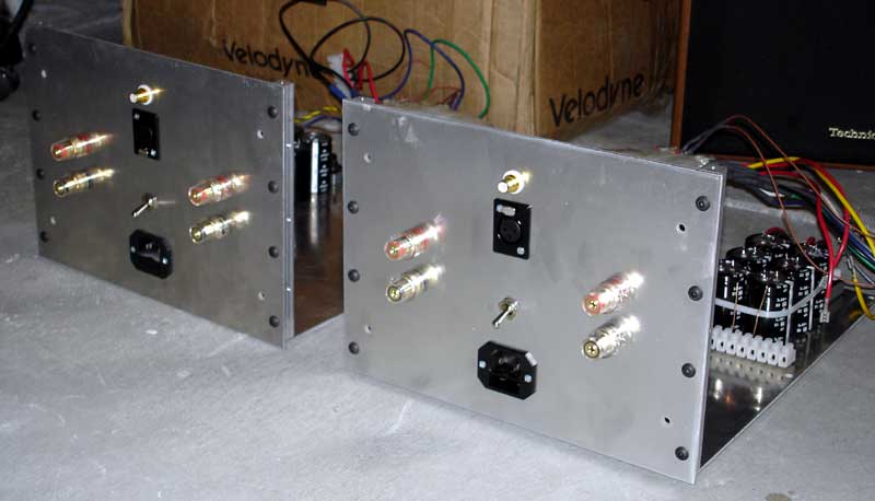

thanks everyone.
i HOPE that these can beat my rotel. i mean, everyone is talking how great they sound and how they are beating up on a ton of high end designs. well, the rotels arent that high end in my mind. so, they should beat them. if they dont, ill get out of class d completely.
i dont run my speakers full range, so they wont be asked to do a LOT of bass, but i still like them to be punchy at the midbass frequences.
im having a problem finding appropriate caps to use for the supply. the ones i have will work for testing, but i dont really want to use them for the final amp if i decide to build it. the best ive been able to find at a reasonable price are nichicon 10,000uf @ 80V for $4 each. im really looking for 100v, because if i decide to go with the ucd700's later, i dont want to have to upgrade everything.
i found some nichicon muse FG's, but they are like $50 each. i would need 4 per channel for a 4 ohm supply, thast a lot on caps.
edit:
the lc audio predator psu looks good, but it only goes up to 60v, so i would have to get the special addition. i guess i could just drop the cash for the hypex PSU, but its PRICEY and its not carried in the states.
who in the states other than diycable and adire carries hypex stuff? adire is pricey and diycable doesnt have power supplies.

chris,
im not sure if i was completely clear here...
im not simply planning to "toss" something together. i do have a plan, maybe im just not properly sharing it with you.
i already have a pretty impressive surround system, but im not totally happy with my amps. my fronts are being driven by a pair of rotel MB-1070's. they are biamped, and produce around 200wpc at 4 ohms, and since they are stereo, and one per speaker, im running passively bi-amped at around 400/ch. the speakers are magnepan tympani 1D's, which are pretty power hungry.
the rears arent as important for my purposes right now. BUT, if all works out, a pair of these amps for the rears wouldnt be bad either... but thats not taken into consideration.
SO, i currently have everything i need. i have all the amps and speakers, so its not like im building anything i dont already have.
so, in answer to your question, i only need two channels to evaluate the sound quality. i do this stuff for a living (i sell audio and do system consultation), so i have a "tuned" ear, or better yet im used to listening to amps on my system with the same damn songs ive heard 1 million times.
im not necessarily comparing this amp to "anything", im comparing it to things i have access to, and more importantly what i currently use. if it doesnt sound better than what i have, there is no use playing around with class D.
i dont plan on doing any tweaking or upgrading for just a test. i plan on using it in a "modest" form, that is, in a non-extreme application. i want to keep it pretty stock, but also not use inadequate parts either. just a basic textbook implimentation.
and i dont have meager expectations, they are actually quite high. i have heard a lot of things in my time, up to $1/2 million systems that have been properly designed in sound treated rooms. i dont expect THAT, but i expect it to live up to the hype in these threads.
the 180AD might be enough power to "test" with, its certainly not something i would keep if it sounded good. i would much rather use 400's. so, if im going to test them out, i might as well use 400's. that way, if i like them i can just keep them. either way, if i dont like it, i would sell them. but, i hope that wont happen.
hum, i wasnt quite clear about what i already have to test this thing. i have a TON of caps sitting around, and i was planning on using some i had laying around. i have various phillips, nichicons, some elnas (not enough for what i want to ultimately build though), and some others. i have high and low grade. i also have a bunch of bridge rectifiers, most 25-35amp, 600-1200V. the transformers will be 1.7kva toroidals with 45v secondaries. if i liked the sound and were doing it "for real", i would use better caps and a better power supply, maybe hexfreds or something.
i guess you may have thought that i didnt have parts at my disposal and i was planning on JUST buying the modules, and then trying to source all the other parts later. thats not the case. i have EVERYTHING i need to properly test these. i just want to see how they sound compared to what i have, and what ive heard. if they sound good, ill go from there, if not, ill sell them and not lose any sleep
i know i ask a lot of questions and seem new to this, but its just that im new to class d modules. ive been in this forum since '02 and have almost 2k posts. ive read a lot, im just not an engineer or an electronics major. so, some stuff i just dont get. but i know whats necessary to evaluate an amp.

well, they still havent shown up yet, hopefully they will show up this week (its been over 10 days already ).
but, in the meantime, i have built a pair of chassis for them with power supplies. so, my test rig will have 1.7kva transformer, with 45v secondaries (unloaded), 13,200uf total capacitance (per supply) with dual 35A bridge rectifiers.
they look like this:
