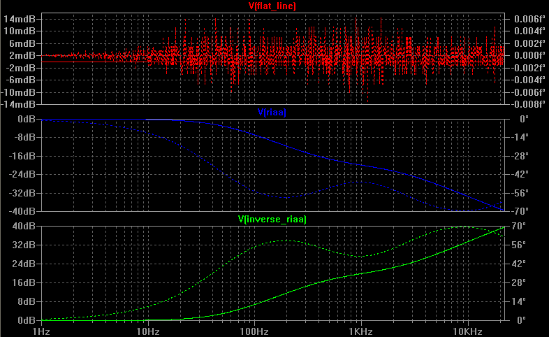

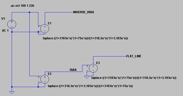

Use the forum search function and lookup the terms laplace ltspice and you will find a few posts. The gist of it is to insert a voltage dependent voltage source (E) whose value is set to a string of the form
laplace ((1+3183u*s)*(1+75u*s))/((1+318.3u*s)*(1+3.183u*s))
You'll have to check the formula above because I wrote it from memory and I don't trust my memory.
In ltspice, to set the value of any component you press the CTRL key and in the same time press the right mouse button on top of the component. That will open a dialogue, and you need to change the "value" field.

ra7 when you get ready to test your phono preamp with physical test equipment, the circuit i provided above goes in front of the phono preamp (between the sig gen and the phono preamp) and approximates (+/- 0.1db) the pre-emphasis curve of the laplace inverse riaa sig source.
