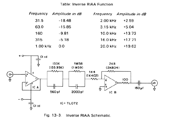

inverse RIAA, ckt below. use the values in parenthesis for the most accurate curve. input the signal source on the left, no series resistance for the signal source is required. in LTSpice remember to use MEG instead of M, so the 1M59 will become 1.59MEG if you use the default op amp, set the GBW to 10Mhz
