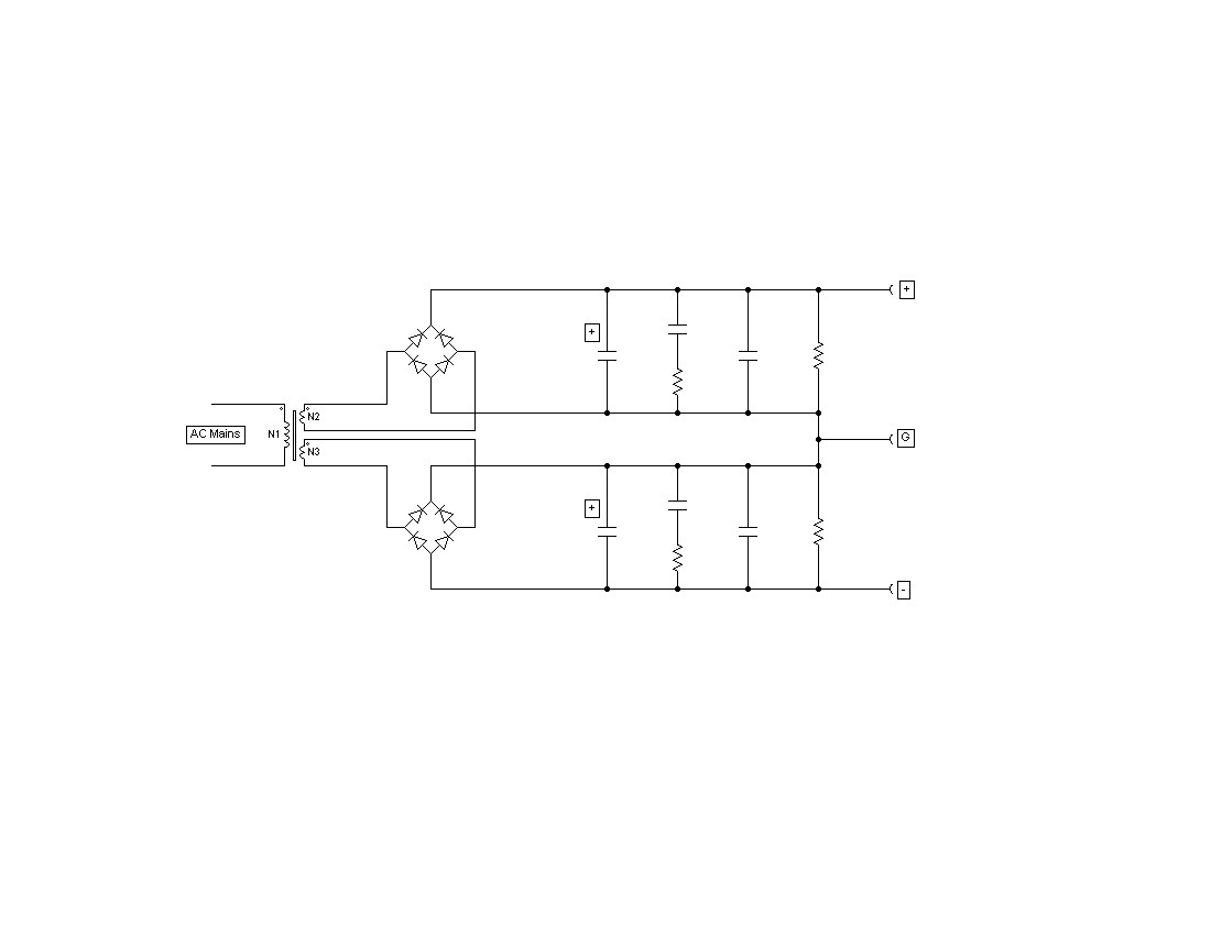

I feel compelled to repeat what I posted in #90, to be sure there is no potential for ground loops, you really should at minimum keep the high level and low level grounds totally separate. You might get away with combining the power and speaker grounds, but to use a single conductor for all grounds from the amp board to the power supply is inviting disaster. Even if you have a "star ground" on the amp board, you're still using one wire to connect it back to the power supply, combining low level and high level signals. I have the input, power and speaker grounds all on thier own conductors, never have any issues. Besides, like I said before, wire is cheap and it's easy to do it that way.
Mike
Power and speaker grounds should meet at the star ground for everything.
It is a bit confusing what you wrote about using one wire to connect back to the power supply. If you have the star ground on the amp board there is no need for more than one ground wire to the PSU, except that you're doubling resistance to have one ground wire handle return for both positive and negative rails.
One ground back to the PSU would not combine low and high level signals unless designing something odd where the low level audio signal goes through the power supply board traces but that is not the case in hurtz design nor most chipamps that I can recall, there would be a separate ground from the audio input, from the power supply, and from the speakers all meeting at a star ground on the amp board.
OK, where does the current from the speaker ground go, what's the return path back to the power supply? Now were's the ground return path for the low level side of things, the input ground? Looks to me like one common path, one single wire. I'll say it agian, you will get superior results, lower noise and distortion by keeping large current and small current paths back to the power supply separate. Even with the small value (10ohm?) resistor "isolating" the input ground, it is still using the same ground return path as the speaker. It might work your way, and I'm not trying to rain on anyones parade, but the way I'm suggesting works better and it's easy to do.
Mike
I'm glad you asked that, I took another look at it and realized you're using a single rectifier bridge, whereas I normally use two with a dual secondary transformer to maintain independant supplies for each polarity, I should have been more observant. So it would be better to use the original design where the ground trace was a continuos ring around the outside of the board. However, for that design I would personally prefer to have a single large ground trace down the center of the board and put the power rails on the out side, the way you have it is sort of "inside out" to my eyes. Sorry for the misdirection and confusion.
Mike
It's been said, a picture is worth a thousand words, so here's how I usually do it.
Mike
