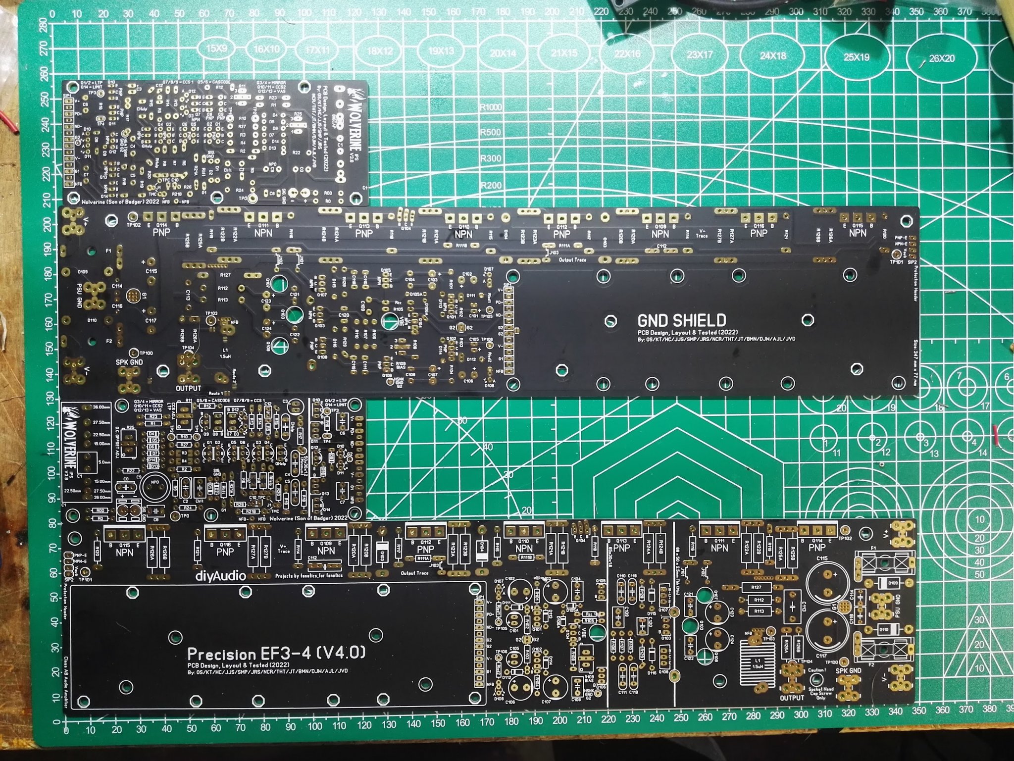

I received my boards. they are awesome!
I have a couple comments after reading the documentation and reading some posts.
./ This is not the regular weekend warrior project.
./ You will need to fabricate heatsinks, solder SMD components, tap threads, make spacers, coils, use precision resistors and match a bunch of transistors.
./ If one cheap out, this thing might oscillate on the best case or have a catastrophic failure and ruin your work, troubleshoot this won't be easy.
./ A stout well designed power supply, a soft start circuit and speaker protection circuit is advised.
./ Between components, PS and a good chassis is not a budget oriented project (for DIY standards) I would say that at least around 1.000 USD without shipping and taxes.
Bottom line, it is kind of a commitment so be sure to have some knowledge about amplifiers and power supplies, but with following the procedures given and use a very good quality and well designed power supply I'm pretty sure that will result a hi-end power amp.
