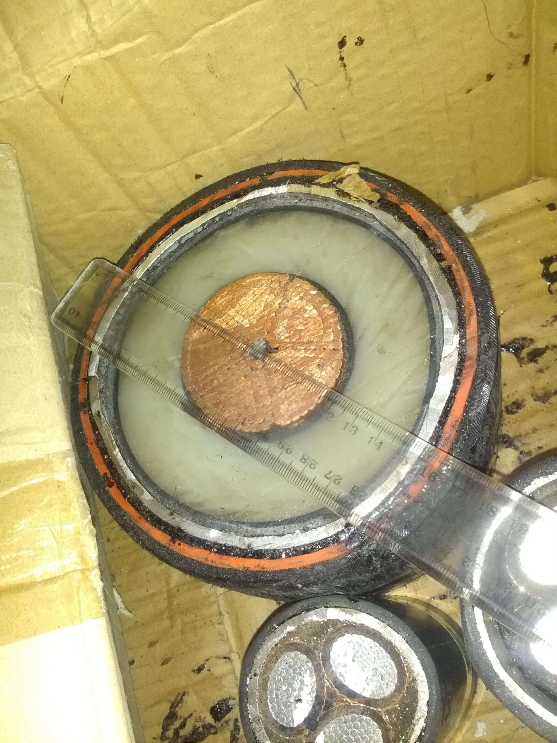

For power supply wire, just use something that is appropriately sized for current carrying capacity and copper conductor since it is small you can afford it.
If you're buying big cables (see attached pic for an idea of BIG cables that get used at my work) then maybe you'd consider a cheaper conductor! Since I know someone will ask - that is one phase of a 110kV copper conductor, lead sheath, oil impregnated paper in the insulator. The other cables edge of pic are alu 33kV.
