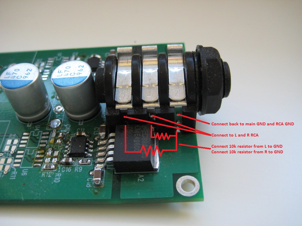

I'm trying to decide on an optimal arrangement now for my The Wire BAL-SE setup.
Will be fed directly from output of TP Opus (WM8741) DAC. I'd like to get RCA and headphone outputs. As I see it there is a few options:
A) RCA and headphone ports in parrallel off the board.
B) Relay switching between headphone and RCA outputs.
C) Dual 'The Wire' BAL-SE in parallel off DAC.
D) Relay switching between two BAL-SE 'The Wire' off DAC.
Taking into consideration length/impedance of wires connecting these up I'm personally leaning towards relay switching outputs per option B. Thoughts?
screw that!! relays will add resistance/impedance at the output and the decent ones are often of limited current capability
as long as the wires are kept short, just run them in parallel from the output option A. just dont leave the headphones plugged in when not in use. if you must use a switch; IMO you are better off using a high quality mechanical switch
I'll echo qusp's comments... just run them in parallel at the output as in A.

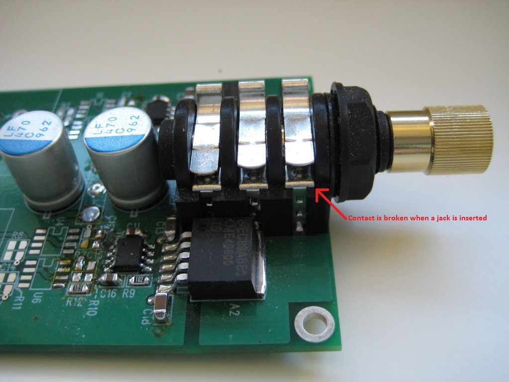

No need for relays or a switch. Even if you were driving both headphones and the RCA outputs at the same time I don't think you'd notice a difference.
What you could do if you want a really cheap and easy "or" type inplementation (where the RCA jacks are turned off when headphones are plugged in) is to use the same jack as used on the first version of The Wire but connect a pair of RCA jacks to the switched pins on the side of the jack. These jacks are specifically designed to work as switches, but I would opt for the gold plated version if you're using it this way.
The GND pin should be hard wired to always be connected, and you'll want some 10k resistors from each output to GND to reduce clicks and pops.
See pictures for details - and feel free to comment on the excellent lighting!

i mentioned not leaving the headphones plugged in, not because i think the load would be a problem so much, more that you would want to be running it probably at full volume for the line out, maybe not so good for the headphones . that and perhaps having an aerial connected to ground at least on paper maybe not so great either. in practice the latter may not be a problem, but the former might be very expensive.

ahh... good point about over-driving the headphones... I hadn't really thought about that.
In that case, it's probably best to disconnect! The above circuit would give you a not-so-subtle reminder to disconnect your headphones, as the RCA outputs wouldn't work until you did.

That'll work perfectly. I will be doing volume attenuation in the digital stage. These switched phone jacks will certainly be simpler and neater than any of my ideas! In my application OR is definitely the only use case, can't think of any time I'd want to run both simultaneously.
