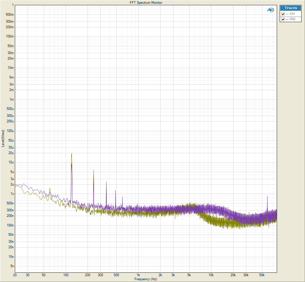

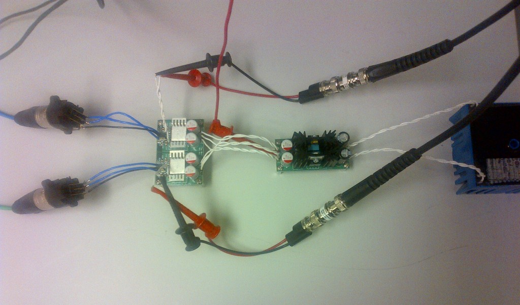

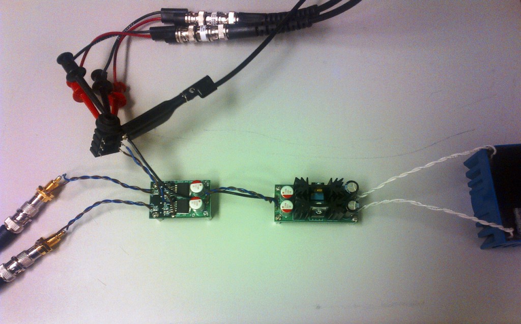

Hi Guys,
Well, I finished measuring the SE-SE and the BAL-BAL version, as well as the PSU this evening. Tomorrow I'll measure the BAL-SE, then I'll be starting on the power amp.
In the meantime, I'll post what I've got so far. I'll toss them up here, and I'll compile them into a proper wiki and link to it from the main headphone amp wiki. In the wiki I'll discuss the significance of each measurement, and post up a more formal spec.

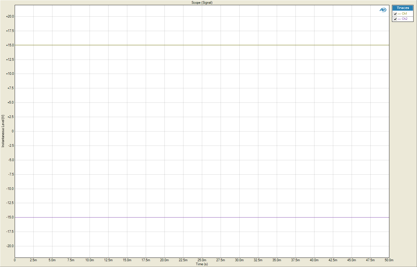

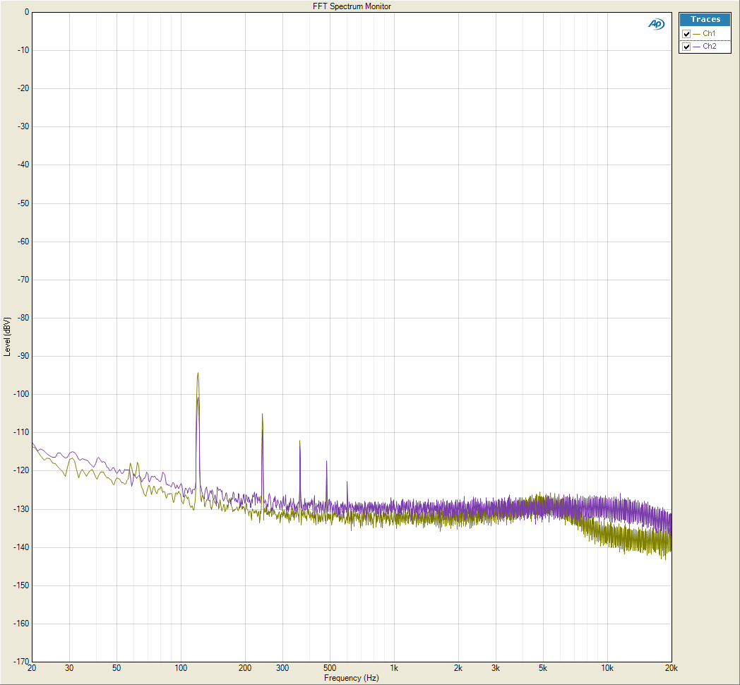

Let's start with the PSU:
1. I took an AC coupled FFT measurement of the output of the PSU while connected to and powering the SE-SE amplifier. You can see the 120Hz fundamental caused by the rectifiers, and the subsequent harmonics at 240, 360, 480 and 600Hz. The negative rail is the purple trace and the positive rail is the greenish trace. The fundamental is about 20uV on the positive rail, and about 10uV on the negative rail. Overall, the supply is very quiet and well behaved up the measurement limit of 80kHz.
2. This is the same measurement as above, except only up to 20kHz and expressed in dBV.
3. This measurement simply shows the two rails on the AP scope.

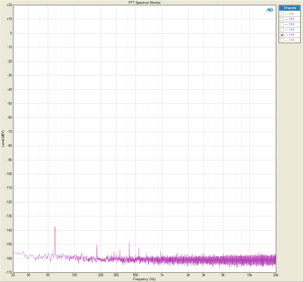

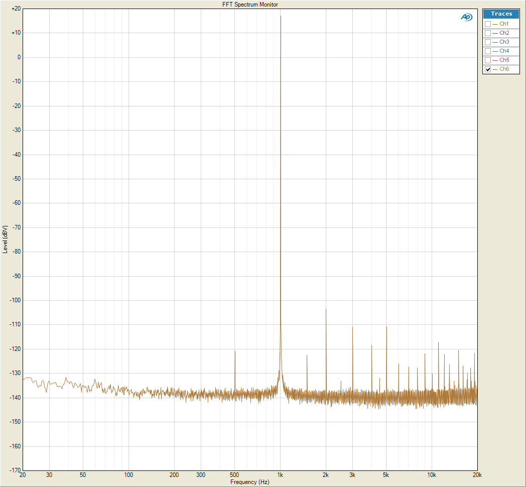

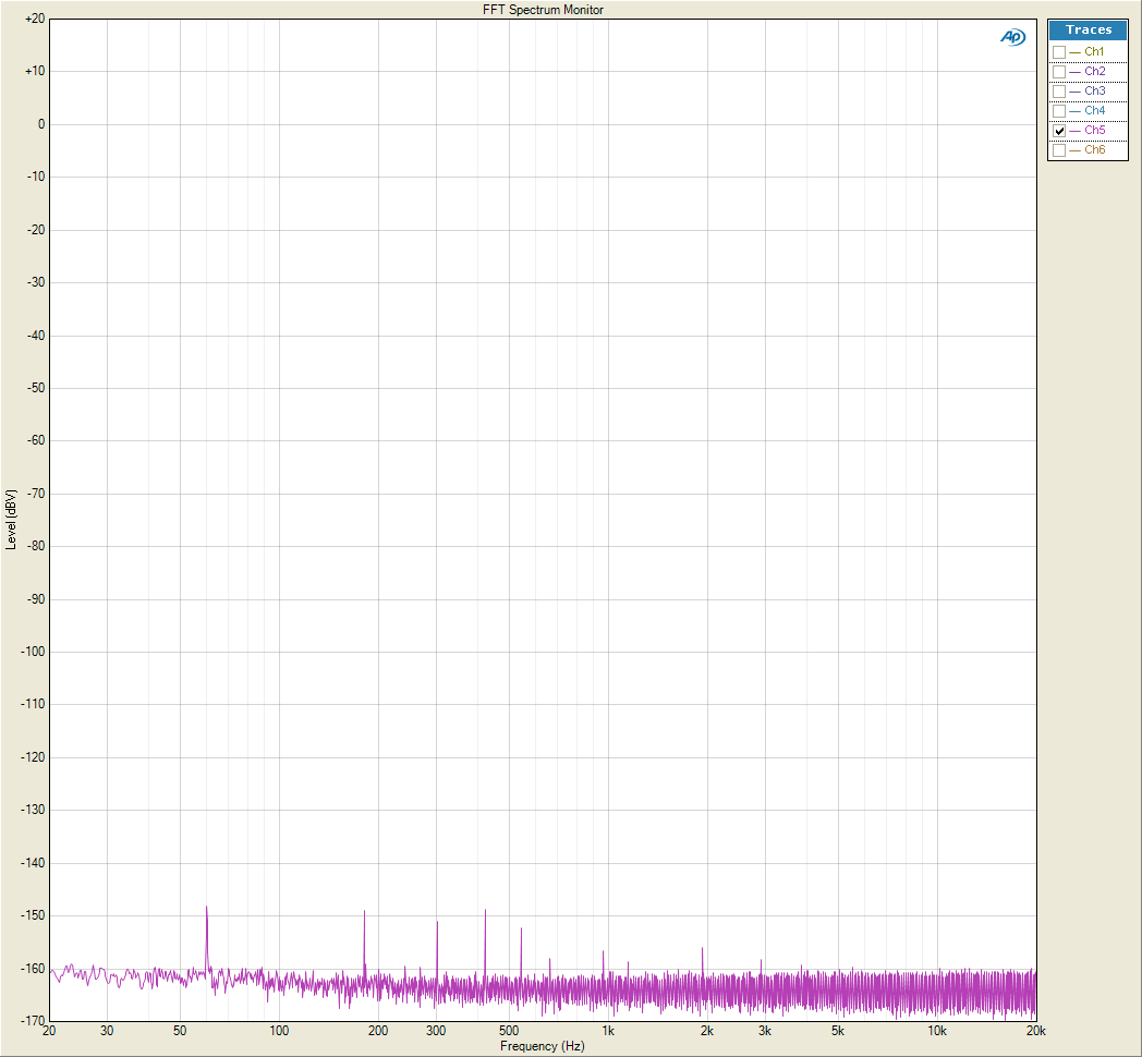

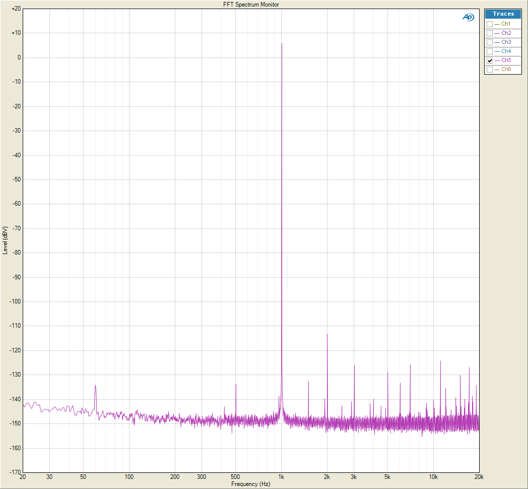

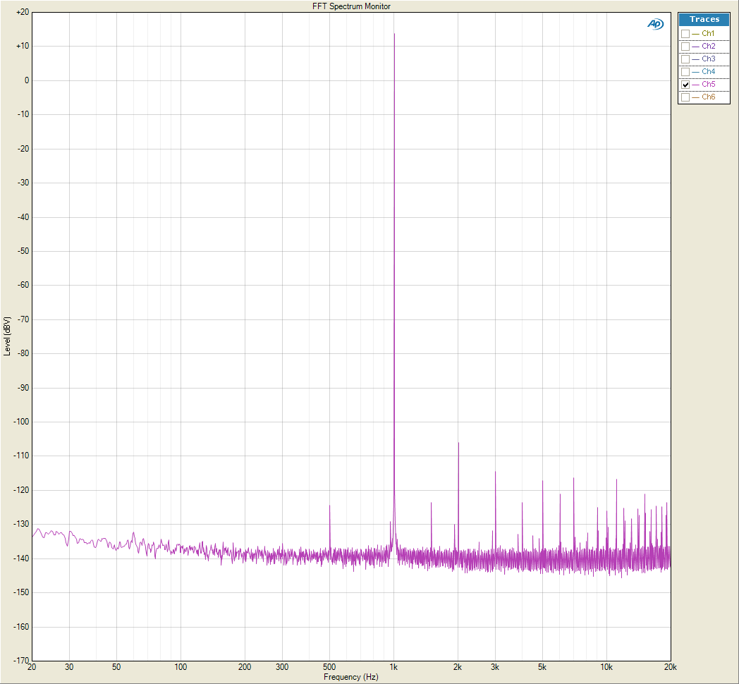

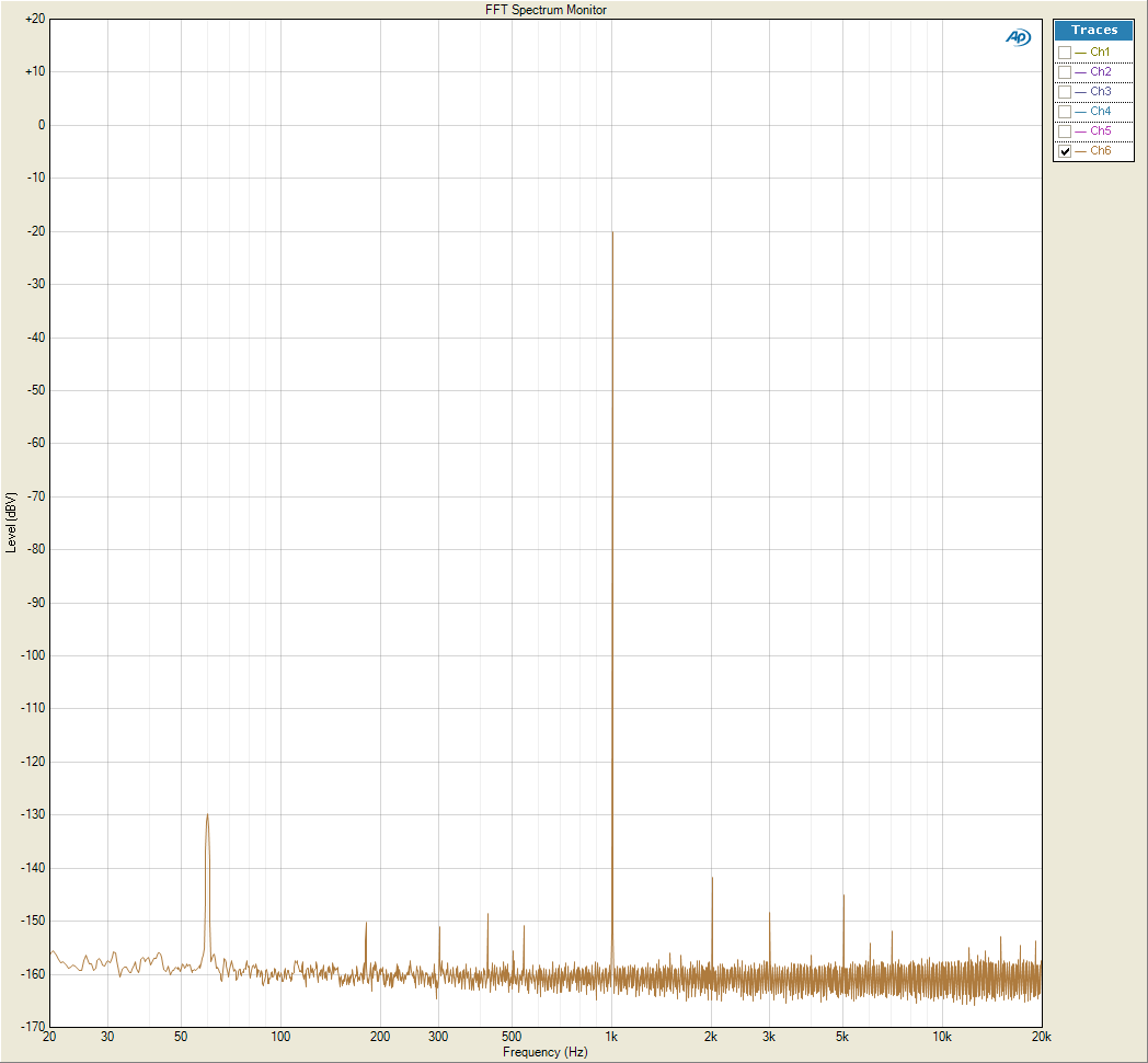

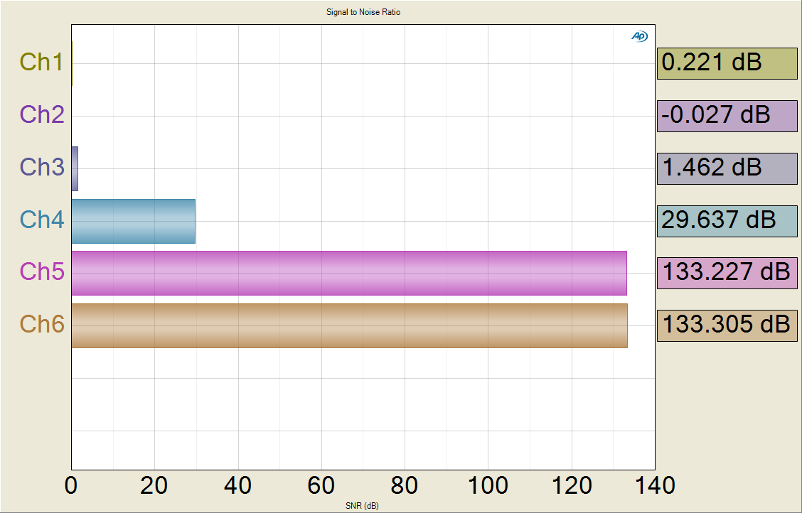

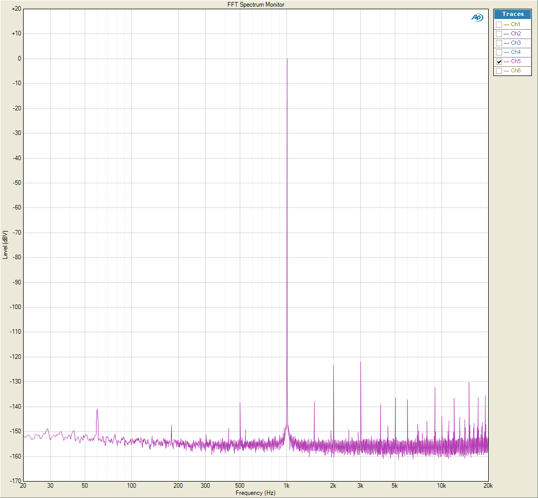

Next up we've got the SE-SE headphone amp. This little guy far exceeded my expectations, and those of you going with SE inputs and outputs will be glad to know that you're not really giving anything up in doing so!
1. The first measurement is an FFT of the amplifier's output into a 50 ohm load with a 50 ohm load across the input which is disconnected from the AP. This basically eliminates the AP as a source of noise and shows the amplifiers true noise floor.
Thanks to the three layer board, the noise floor is about 10dB lower than the previous BAL-SE version, for a pretty stunning noise floor of between -160 and -164dBV. You can see the 60Hz noise and a few of the harmonics getting through, but they're all lower than -148dBV. This is the quietest amplifier I have ever measured.
2. The next 6 measurements are all FFTs at various voltages driven into a 50 ohm load. There's 0V (AP plugged in but no signal), 100mV, 1V, 2V, 5V, and 7.2V which is the most the AP can put out single ended.

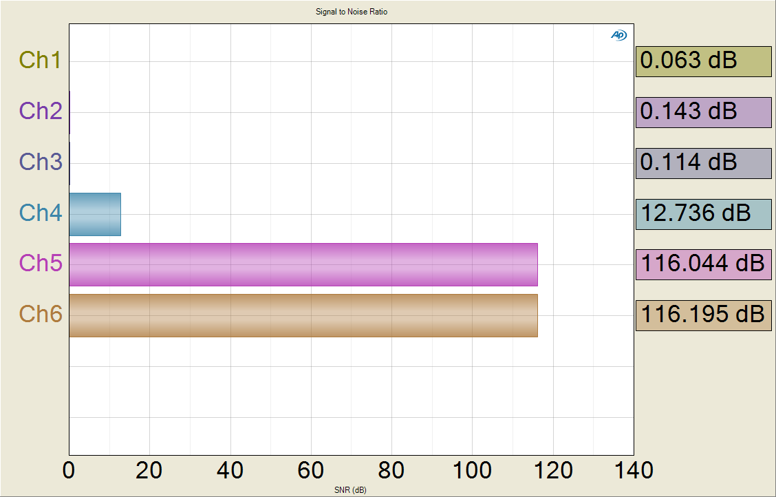

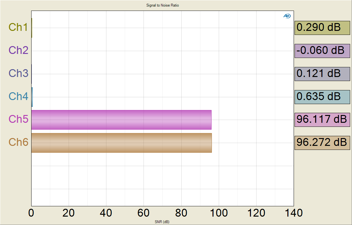

3. The last three measurements are calculated SNRs at 100mV, 1V and 7.2V. The channels of interest are 5 and 6, the other channels are not connected. These channels are used because they happen to be the best performing of the 8 channels.

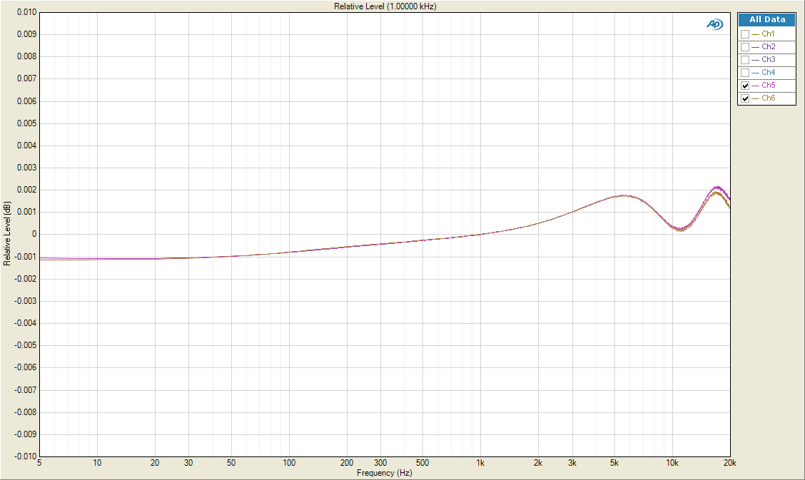

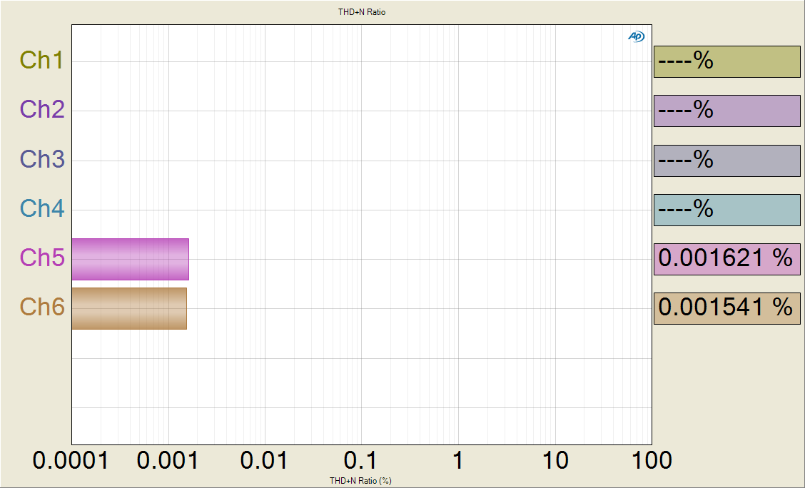

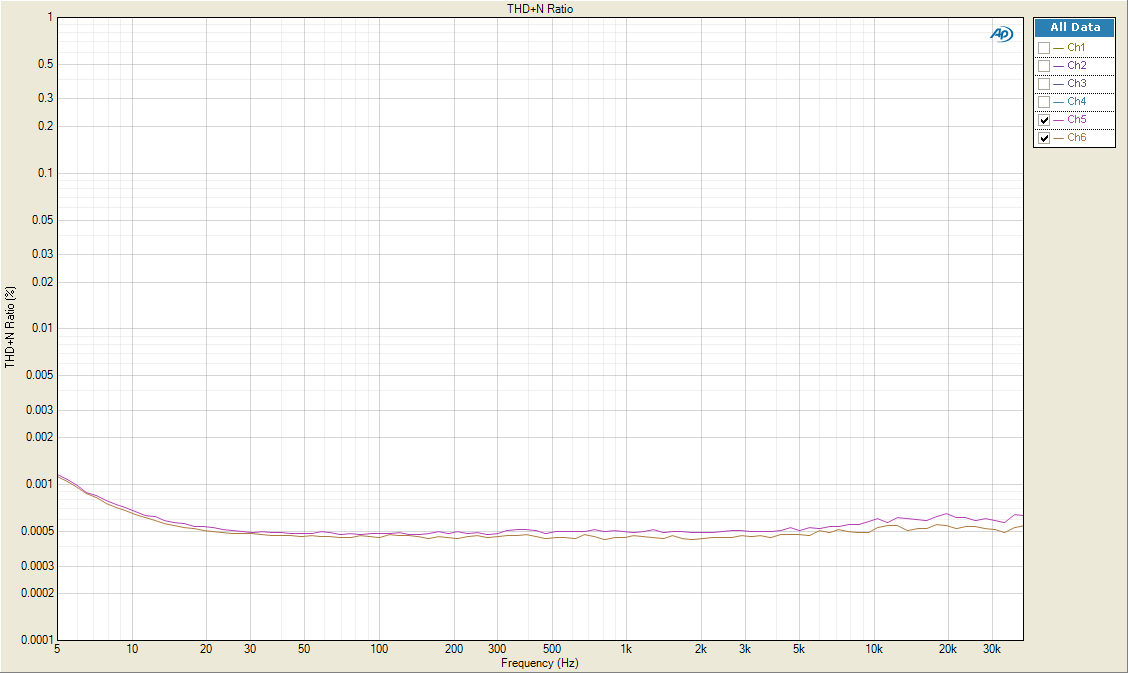

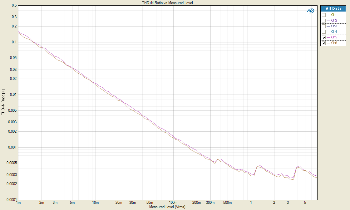

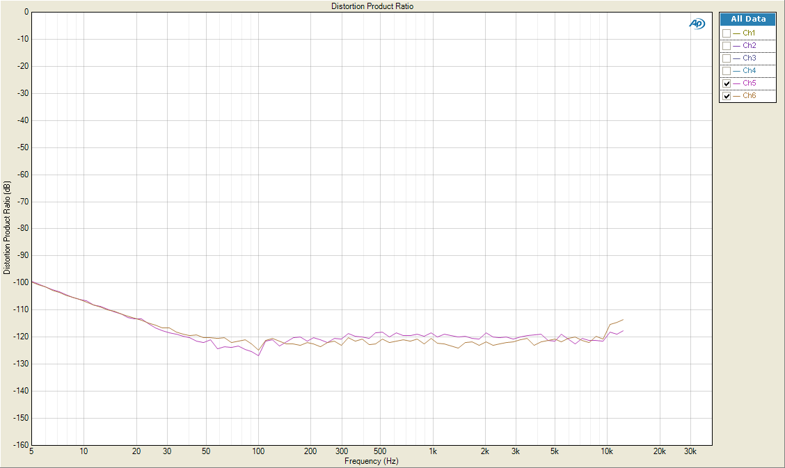

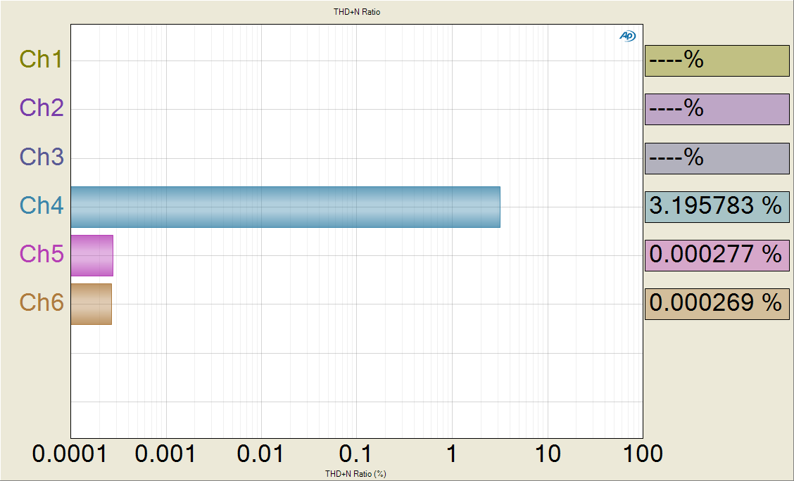

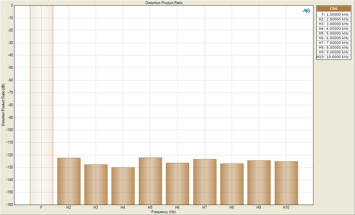

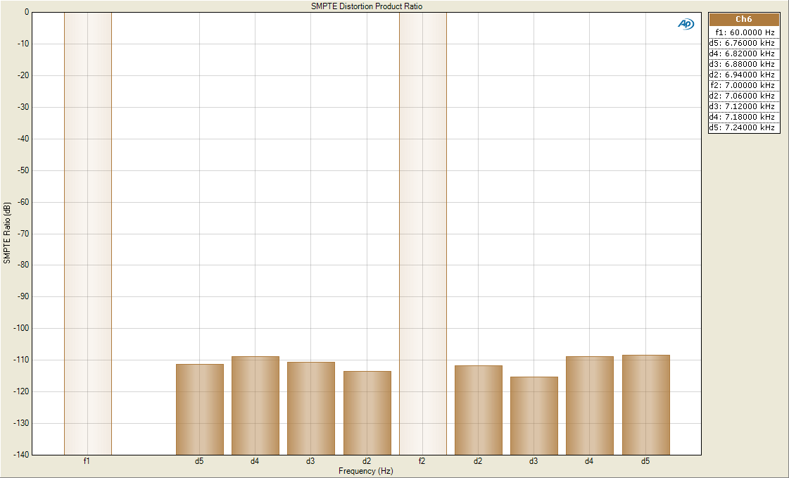

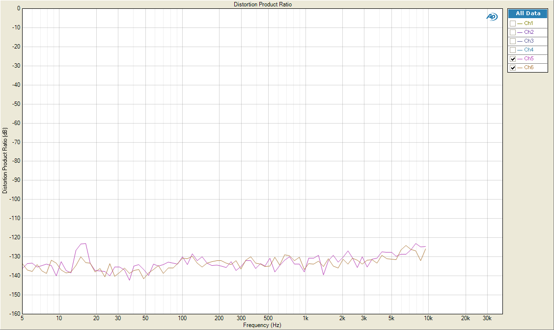

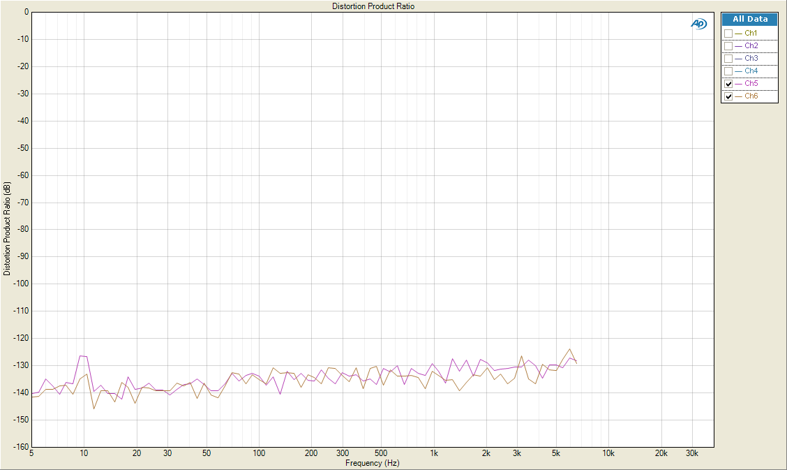

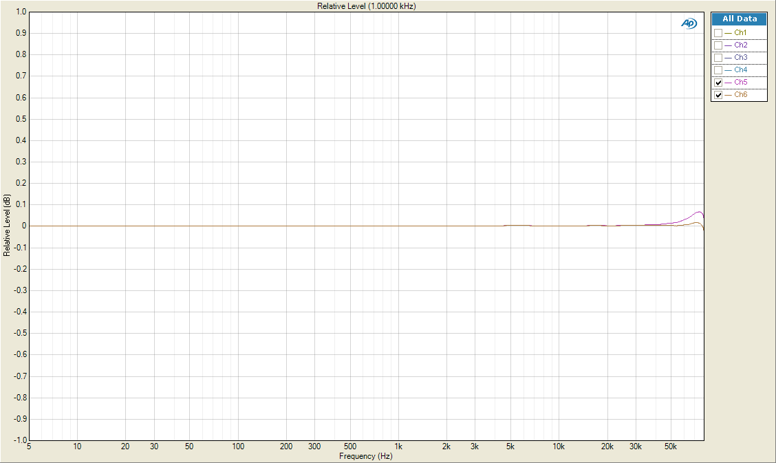

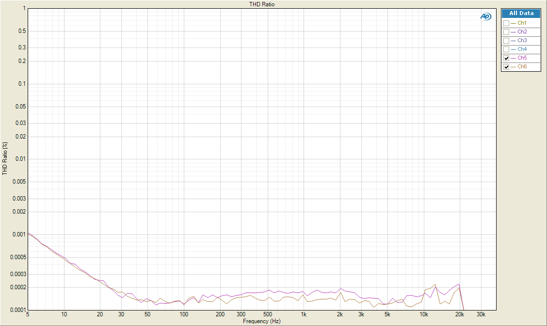

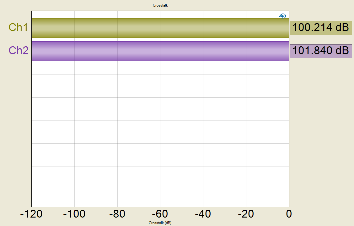

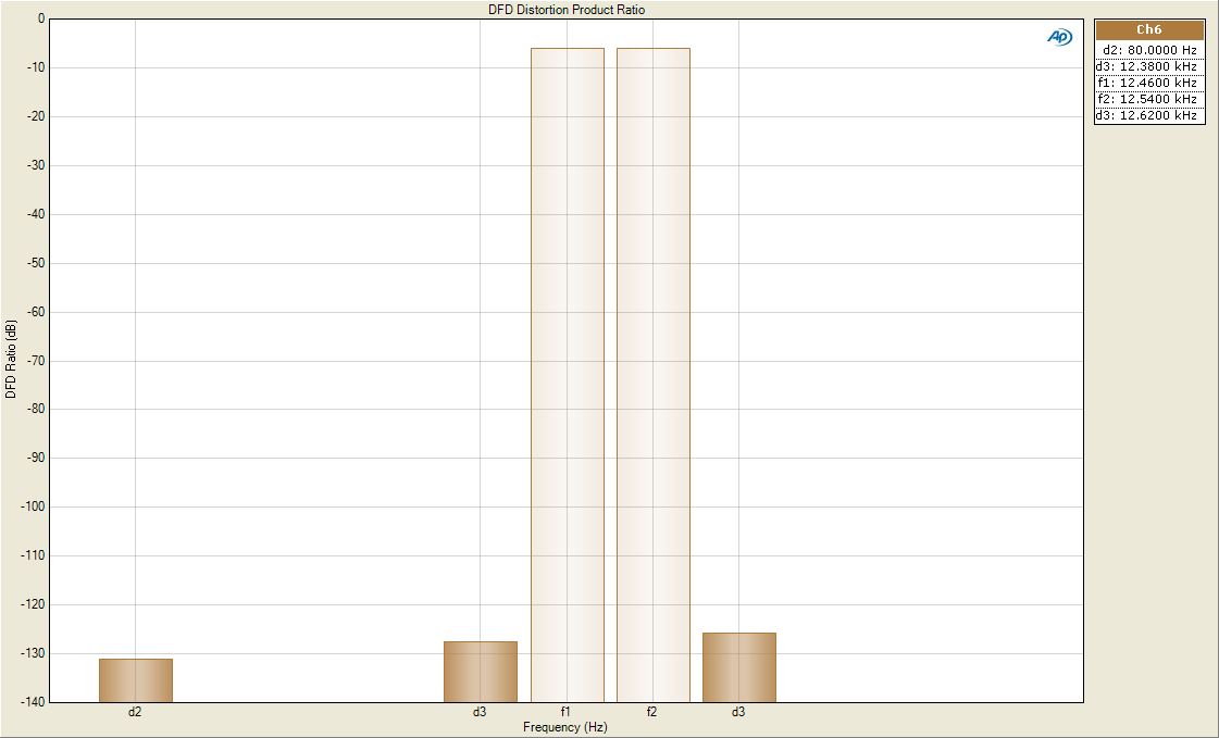

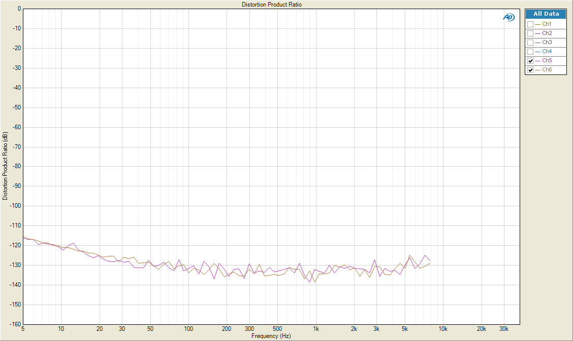

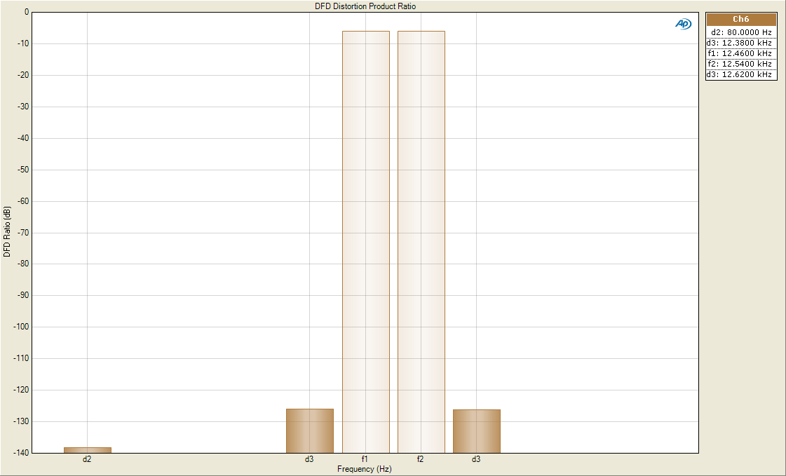

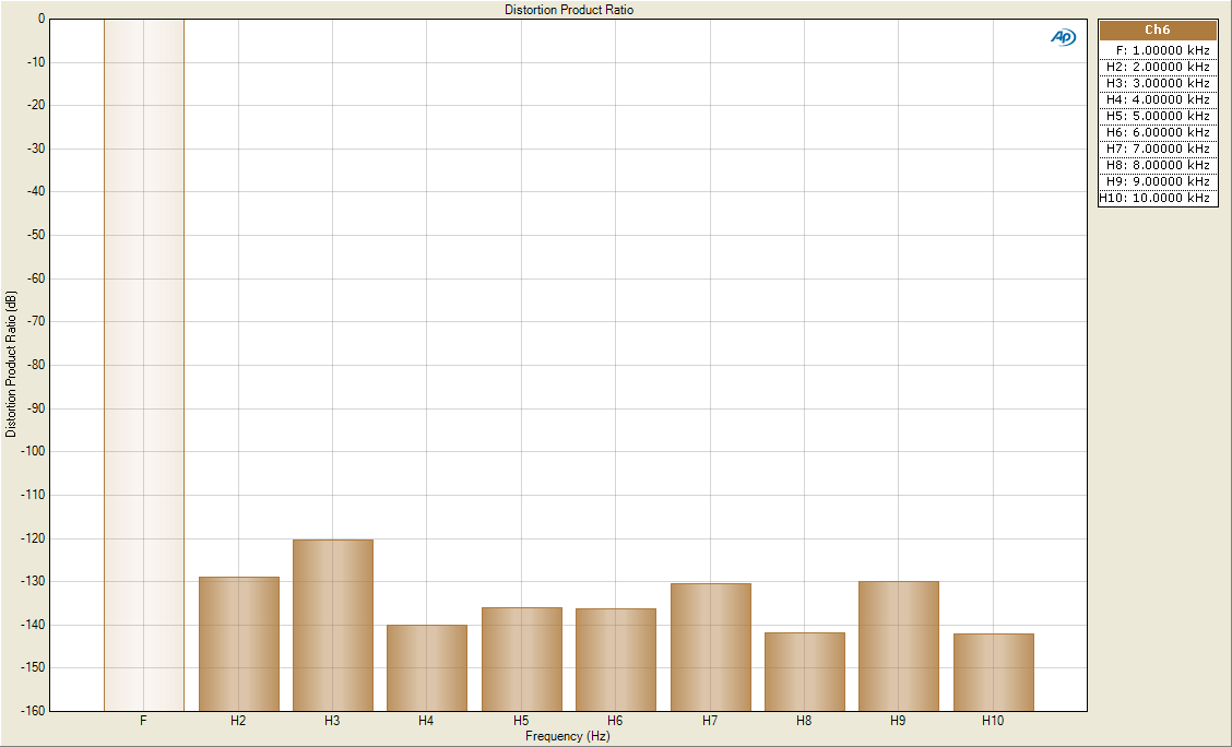

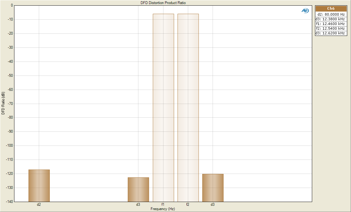

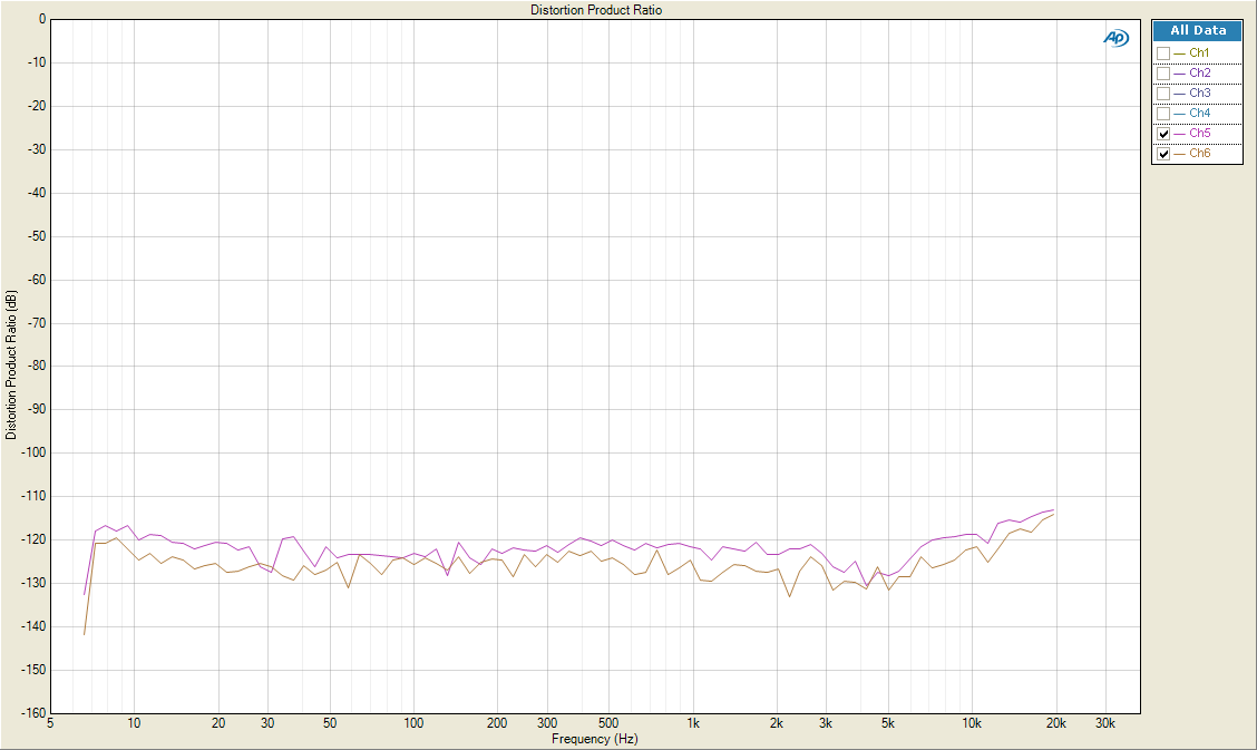

Continuing with the SE-SE amp we have:
1, 2, 3 = Calculated THD+N ratios at three different drive levels, 100mV, 1V and 7.2V all into 50 ohms. Again, channels of interest are 5 and 6.
4 = Gain linearity which is basically showing that the gain remains perfectly linear regardless of output level. If you had an amplifier with a high output impedance, this would be all over the map. The Wire, however, doesn't flinch at all from the lowest to the highest output level.
5 = Frequency response. Note the +/-1dB scale. The peak between 70 and 80kHz is the AP, not the amp.
6 = Frequency response zoomed in. This is probably one of my favorite measurements because it's almost funny how absurd it is. The 0.1% resistors mean that the channels match up better than 0.0001dB.
7 = THD+N ratio vs. Frequency - sweep
8 = THD+N ratio vs. Output Level - sweep
9 = THD ratio vs. Frequency - sweep

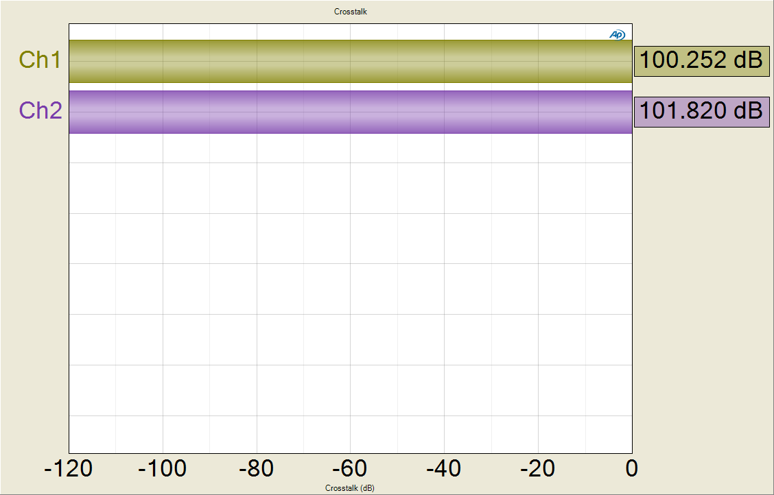

Next for the SE-SE amp we have:
1,2,3 = DFD Intermodulation distortion at three different drive levels.
4,5,6 = SMPTE Intermodulation distortion at three different drive levels.
7,8,9 = Crosstalk at three different drive levels. As this is an SE output amp, this is where the BAL-BAL really pulls away. The SE amp hits the wall at about 100dB of channel separation, where the BAL-BAL, as you'll see later, does significantly better.
1,2,3,4,5 = sweeps showing distortion product ratio vs. frequency. Each harmonic is shown separately so you can see the character of each with respect to frequency.
6,7,8 = Distortion product ratio at three different drive levels.
Overall, this amp measures incredibly well. I personally have never seen anything that has such low distortion that you're basically just measuring the AP's generators. The noise floor is so low that this amplifier will be completely silent into even the most sensitive IEM's, and yet you still get enough voltage and current drive to run the hungriest headphones out there. The very low output impedance means you get superb linearity, and a perfectly flat frequency response regardless of the load. I couldn't be happier with this little amp! Keep in mind that there are no tricks here... no batteries, no filters, no fancy chassis or shielding, just the supply and the amp running off a transformer.
I've attached a few shots of the test setup below.
