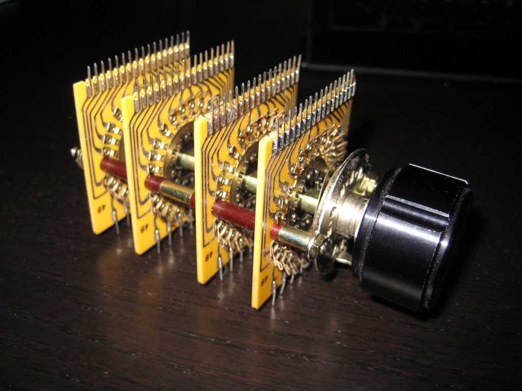

I'd suggest one of these (the quad version for stereo balanced) if you have the cash:
Prices
Otherwise, there are several other switched attenuators out there for far less money. I think I remember reading about one from Poland that looked very well made, and decently priced.
Unless your source is very low output, I wouldn't bother with anything active. If you're on a tight budget, there are very cheap dual gang 12 step selector switches which would allow you to do dual mono balanced attenuators (one knob per channel). Take a look on Digikey or Mouser.

For attenuation, I went ahead and ordered one of these:
High Quality Audio & Industrial Attenuators
It just seemed appropriate to stay on the SMD scheme. I also like the fact it has 48 steps vice the 23 of the goldpoint.
BTW, I will be making my build single ended through out. I might also increase the gain to 2X to make it a bit more universal for my intended sources. We shall see.

yeah i mentioned those, imo they are te best option on the market at the moment when it comes to steppers. did you buy it direct or through pcx? pcx has the option of using zfoil shunt resistors which is cool, though easy enough to do yourself. so as you are se, you just went with a stereo model yes? shunt or series? and heres an interesting question, will you actually recieve the model you ordered? have they sorted their development phase out? i prefer the look of the old model, but this one is still very cool. i would be buying the shunt version and breaking out a few ASMP smd zfoils for the shunt resistors. at least from pcx they tell you what is in stock
jdkJake,
That's exactly the stepped attenuator I was thinking of! They were from Poland, but I couldn't for the life of me remember what the name of the company was.
I think I'll actually be ordering one of those just to have around. They're beautifully made, and as you said, the more steps, the better with stepped attenuators.
I wonder if they would do a ladder type balanced attenuator with the 8-pole version?

I bought it direct. Communications with Arek of Khozmo was excellent. He was very prompt answering email and answered all of my questions. I have not received the part yet, but, so far, the experience has been fine. Heck, I haven't received my "Wire" kit yet, so, I guess I will see who is faster; Canadian Post or Poland Post. For the record, Canada had a head start.
BTW, I specifically requested the SMD model shown on the web page I linked in my previous post. They still offer the other model, which, is far more configurable in terms of resistor-brand choices:
Again, I went with the SMD version as it felt more appropriate for this amp design. They will custom configure a part to your specifications, you just need to ask. It appears they build to order anyway, so, I cannot see it taking much longer unless any custom/unique parts have to be acquired. I went for the stereo version at 50K. It is a series resistor into a ladder shunt to determine the final attenuation value.
They might. Drop them an email. Arek is pretty easy to deal with and respond quickly (at least he did with me).
