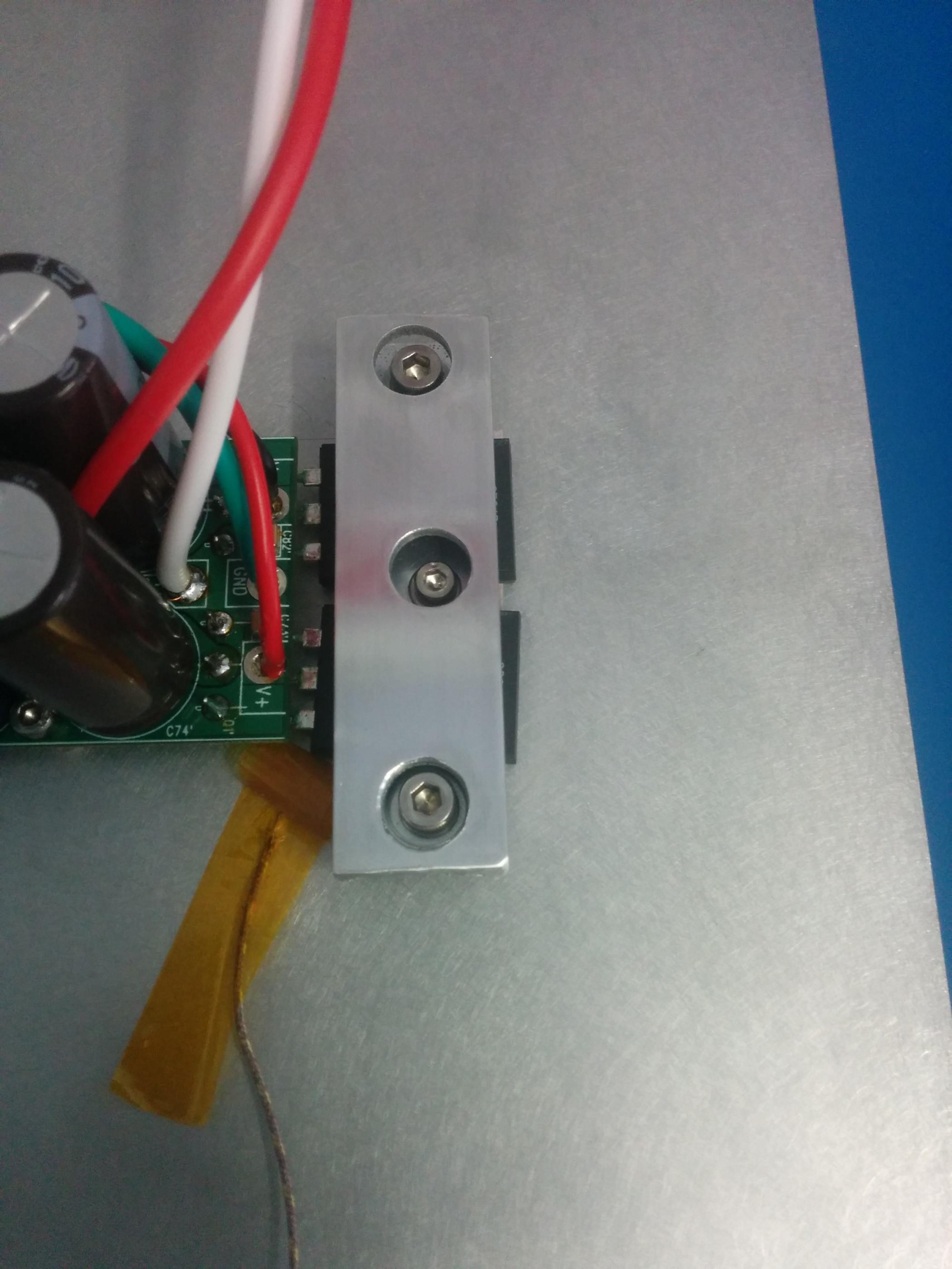

I felt like I was on the right track till I started poking the thermocouple around. Glad that I did though! The heatsink temps looked reasonable and I could have easily just moved on after checking it was all okay electrically.
U-channel sounds like the go, putting it so that the bottom of the U is down would mean no need to drill/tap the heatsink again (which is appealing). (I assume that is the correct way to do it anyway, becasue applying pressure to the small surface area of the upside down U would risk damaging the devices I'm guessing).

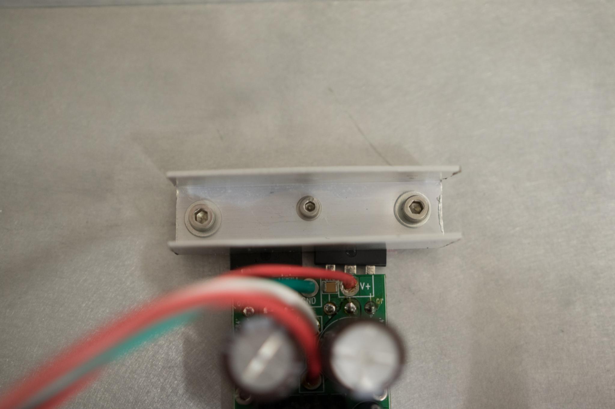

I tried some alu U-channel without the centre bolt, works pretty well. Temps of the u-channel bar are 5-10degC warmer than the heatsink is near the power devices. I decided that since I had it both amps apart to fit the U-channel, I had better add a hole for a centre bolt but I don't have a suitable length M3 bolt for the middle at hand. The one in the pic attached is only 10mm long which means it only gets a few turns into the heatsink and isn't enough to get much force.
I will get a 16mm bolt which will be the same length as the two M4 and then measure temps again with the centre bolt later this week.

Hi Chris,
I'd consider the following three options:
1. Spread the fets apart just enough to get another screw in between them
2. lose the bar stock and use U channel instead. It's much stronger, and won't flex as much in the middle.
3. Drill two more holes in the bar stock and run bolts through the bar stock and the fet holes for more clamping force in the middle of the bracket.
I certainly agree with the mounting methodology overall. It's much better to have the force applied directly over the die as opposed to the screw hole above the die. Paradigm did this in all their amplifiers with steel U-channel, and the thermal coupling with good sil pads was exceptional.
Owen

Ho,
can you see why the two bolt clamping failed?

Yeah, the penny dropped quite early on, before I powered it up I had noticed the flex in the bar. I backed off the pressure to reduce the flex but I wasn't sure if I'd still get enough pressure in the middle. In hindsight I was getting almost no pressure in the middle even with the bar not visibly flexed. All of that is why I was checking temps while also checking the board was electrically okay.
I think things are pretty good with two bolts and the U-channel now since the delta between main heatsink and the bar is much closer now. I'll take a more controlled measurement to see if I can quantify the difference 3bolt vs 2bolt arrangement on the u-channel clamp. I expect thst since the u-channel is only 1.5mm thick T5 alu there may be some improvement left there. The end result should be better than the standard screw attachment method and thats the main goal! If I'm going to try for high (up to 40W per device) bias then I want to be sure I've got everything right before it leaves the workbench. Especially when the surface area of heat source is small wrt surface of heatsink (heatsink Rth will be calculated with even input of heat across the surface)

hochopper,
If you only replaced that U-channel extrusion with a square tube with holes drilled for the screw to pass through the first wall you will see an increase in pressure on those devices. The U-channel with such thin walls still allows the channel to spread open and relieve the pressure across the extrusion. Even with the same thin wall type of construction you will see a difference with square tubing . If you have a micrometer you can measure across the open section of the U-channel before and after applying the pressure and see how far the opposing walls open up, that will show what is happening.

I did a few informal tests and after 20 mins or so the U-channel with 3 bolts and the rectangular cross section tube both have pretty similar heatsink temps. But this looks much cooler
With ~70W bias and ambient temp of 26degC I get a heatsink temp of around 54degC with both approaches. Probably average heatsink temp is a few degrees less than that.
To be honest I think I could get a bit more torque on the bolts but without a torque wrench I'm hesitant because I don't want to overtighten and strip the threads.

Looks good!
That's a very healthy amount of bias if you're dissipating 70W! Are you running at 500mA or are they just very high rails?
It makes perfect sense that the U channel would perform the same as the box section. The added strength comes from the sidewalls, not from the top and bottom. You can easily verify this by grabbing a 1m length of 19mm x 1.5mm bar stock. Try bending it in the flat direction (probably bends under its own weight) and then try bending it lengthwise, which you will find is nearly impossible. Multiply this effect by 2 for a U channel, and that's why it works. Adding the top for a box section probably only increases strength a few percent at best. If you've already got it though, might as well keep it!
The only other thing I could think of would be swapping materials to something stronger like carbon steel, but you're definitely into the realm of diminishing returns at this point
Very curious to see how this all turns out! I love the attention to detail as it provides useful information that we can all draw on to improve our builds!

Yeah I bought 1m length of 3mm bar, 1.5mm U-channel and 2mm rectangular tube. I do think if I really ratched up the torque the U-channel would start to bend a little on the short axis which would mean the pressure wouldn't be even. The top of the rectangular tube keeps this in check. I don't think I'm quite getting to that point yet. There was some mention in EUVL's F5X chassis design article of higher pressure's helping too. My goal for now was to get the pressure even and in the right place, I'm pretty happy with the result.

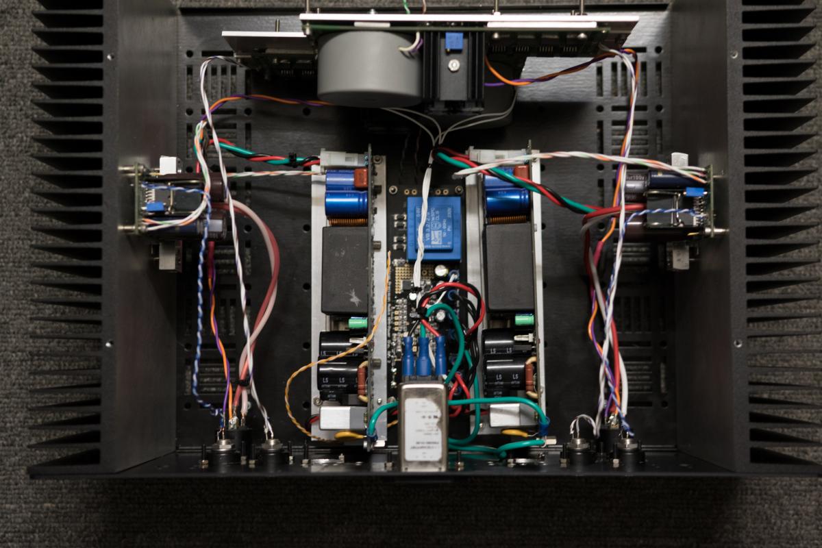

A few finishing touches left for next week after I go out of town this week. But the internal wiring is now finished. Need to trouble shoot why one of the LME ICs isn't getting power (mostly likely culprit is my connector for the DPS600 pin header output).

Nice work! I'm considering building the LM. Can I ask you why you put in two LPUHP headphone amps in your system? At least, based on what you said, these are what they are.
For the switch driver? Why did you use such a design instead of going with just a switch driver like AMB does (AMB.org).

The LPUHP is a 15W speaker amp. I'm building it as a 4ch amp for my active speakers and I will hook this up to the speakers using 4 pole speakon connectors. The LPUHP will power the B&C DE250 and the LME49830 amps will power a pair of Peerless 8in nomex woofers each side. Have you seen the LPUHP thread - http://www.diyaudio.com/forums/soli...gh-perfromance-lpuhp-16w-power-amplifier.html - there are some discussions from people thinking about using them for headphones but for most cases Owen's BAL-BAL headphone amp is an equivalent choice (and my personal favorite).
The switch driver circuit does a few extra things, DC offset protection (disconnect mains power on speaker amp going DC) and has a 12V trigger input as well as allowing me to avoid the need to run mains wires to the front panel switch.
