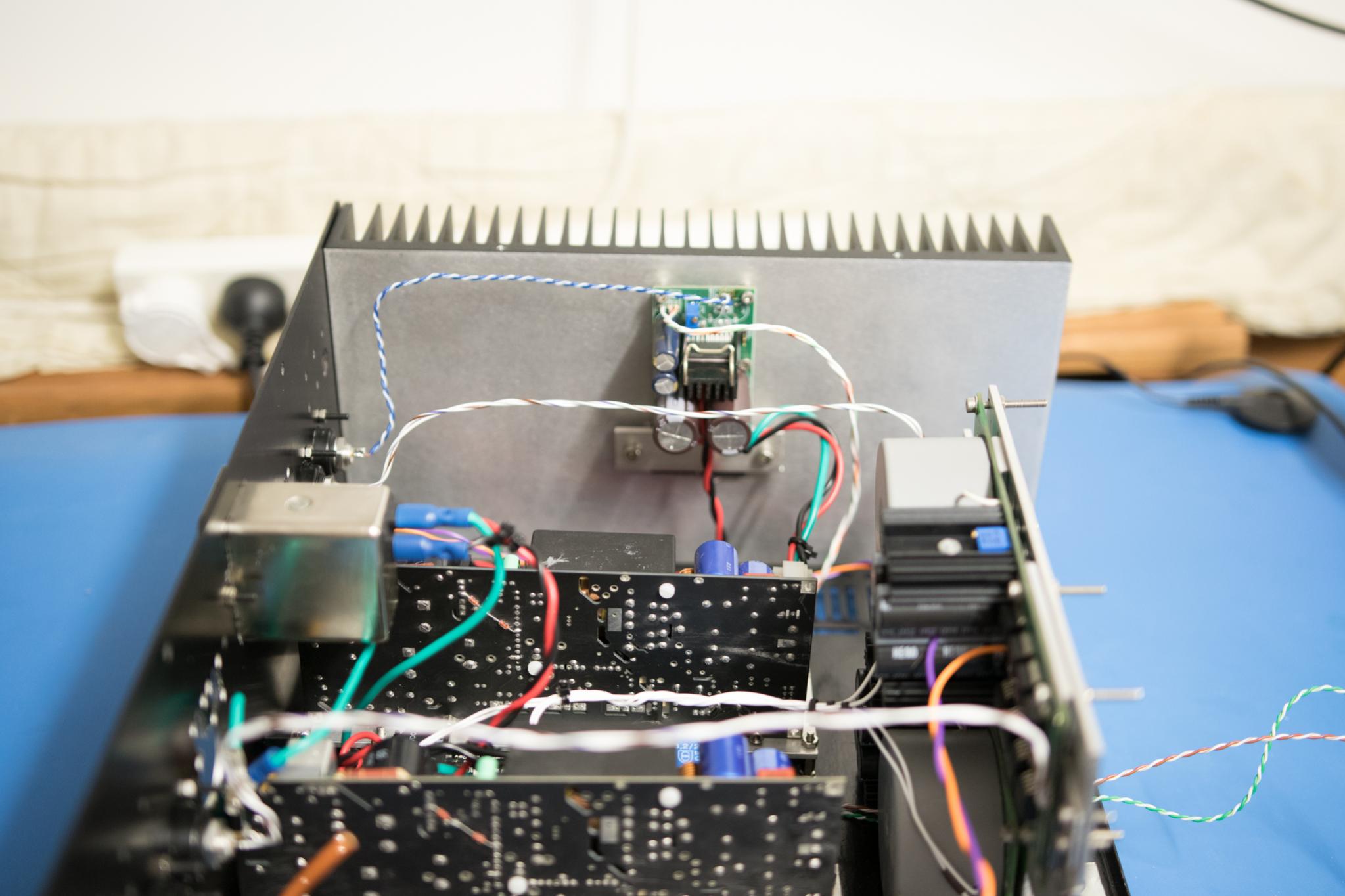

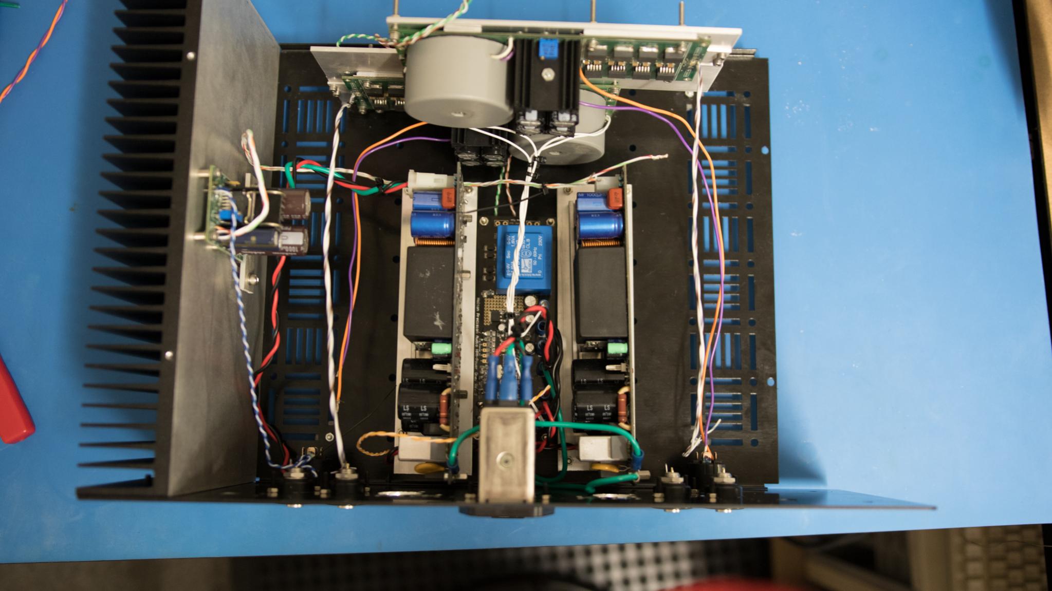

After a few years with the parts for these amps I've finally started to stop stuffing around aimlessly and finish a few of these projects where I've got all the parts already.
Here are a few pics of where I'm up to so far (see attached)
2 x LME49830 amps with DPS600 SMPS, 2 x LPUHP v1, aussie amps mains controller in the middle
When I got everything back out after 12months on the shelf I decided to change direction with layout and that's left me with a bit of a messy back panel unfortunately.
Chris
Chris

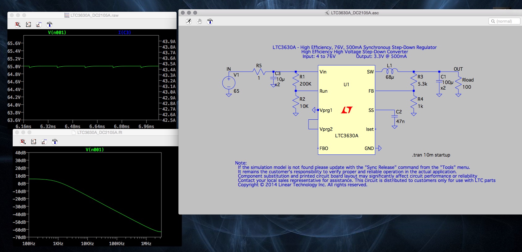

Hey Owen,
How much noise would a DC/DC buck converter create? I'm more worried about radiated noise than conducted, I'll run it off the LME supply so the PSRR should help there. A linear reg dropping from 65V to 5V is too inefficient so I'm looking at other options. Thinking about supply options for that stupid bias switching board I had in mind a long while back.
Chris
Chris
Owen tell me when this gets too far OT okay?
I tried to simulate tonight one of the buck converters that I picked out. Just to see how it looks. I'm very green at anything SPICE, never really used it for more than about 20mins previously. I found a model on LT website for the converter I'd picked and adjusted it a little to suit my load and output voltage requirements and input voltage.
Came up with the attached. Is probably a bit oversimplified to make any real conclusion right?
I need to finish drawing up the circuit for control but it's pretty basic. 555 timer delay to allow startup of amp and it's power supply under very low bias current - after say 2 or 3 seconds - then switch relay to add/remove parallel resistor for the preferred bias current level with an Omron G6K relay (I've got a bag of 100 of them so that's how I made that choice). I can also use the second contact in the relay to start the amp muted but this might not be necessary with this amp.
I'm not sure about adding LM335, comparator and a 2nd relay for a temperature adjusted bias level - to select a lower bias as ambient temp increases. Adds a bit of complexity for not a huge gain.
Thoughts?
Thoughts?

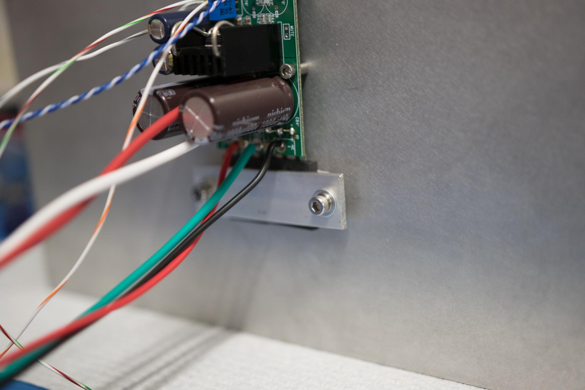

I had the second channel from my amp build on the bench today giving it its first taste of electricity. All went well, electrically.
Since I'm going to be trying to go for quite high bias (especially if I put together the bias switching idea I'm working on) I thought I'd poke around and check some temperatures.
I have done some calcs on heatsink temperatures and whatnot when checking what bias I will be able to handle. I've checked my calcs against what was done in this article - http://linearaudionet.solide-ict.nl/sites/linearaudio.net/files/Didden LA V3 PK lr.pdf - by EUVL explaining the modelling/calcs done in the design for the F5X enclosure design.
Everything seems above board on paper, but I wanted to check with real world data.
My concern now is how I physically attach the output devices to the heatsink. In that article I got the idea of using a clamp rather than a bolt through the hole on the device due to the package requiring more pressure further down the chip. On re-reading it today it seems to be more along the lines of being in addition to the usual method. See attached for how I've got it at the present.
I'm currently seeing ~60degC temps for the clamping bar and ~45degC temps for the heatsink when sitting at about 60W idle dissipation. I'm assuming that inside a case this will be worse. I presume this means that I'm not getting ideal coupling of the device to the heatsink through the keratherm red.
So, should I:
1. drill two more holes in the bar and two more into the heatsink and tap those for 4 bolts through the bar into heatsink; or
2. discard the bar and drill two more holes, mount the output devices normally and get on with life.
Thoughts?
Edit: I previously had just a split washer between the bolt and bar, I think things are better after adding the flat washer as well but the numbers above are with the arrangement pictured.
The problem with single-screw mounting is that the pressure is applied at the wrong place, i.e. not directly under the silicon substrate. It is normally (and understandably) at the top of the package above the chip itself. Thus, possibly less than half of the applied pressure is seen by the chip, and the pressure decreases rapidly with distance from the mounting hole. Therefore, even if you don’t intend to apply the full 1750N, it is still beneficial to deploy an additional clamp directly over the silicon substrate, as shown in photo 1. The bottom surface of the clamp should have a slight curvature, or a thin elastomeric layer in between, to avoid excessive stress concentration which might in turn cause premature failure of the transistor encapsulation over lifetime.

Hi Chris,
I'd consider the following three options:
1. Spread the fets apart just enough to get another screw in between them
2. lose the bar stock and use U channel instead. It's much stronger, and won't flex as much in the middle.
3. Drill two more holes in the bar stock and run bolts through the bar stock and the fet holes for more clamping force in the middle of the bracket.
I certainly agree with the mounting methodology overall. It's much better to have the force applied directly over the die as opposed to the screw hole above the die. Paradigm did this in all their amplifiers with steel U-channel, and the thermal coupling with good sil pads was exceptional.
Owen
