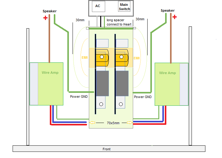

I have just installed my boards into the old carcass of my monoblock amps. I just "tacked" in the power connections etc for the moment because I will build a new chassis for the amps and use them with DPS 500 power supplies I have ordered from AP. They work but I have the mother of all hums, likely ground loop induced which I will need to play with to fix.
In relation to that, where are people grounding their amps to the chassis? I have run a ground wire from the high current power ground input to chassis. Another alternative would be from the centre of the off board filter caps. I might need to experiment with lifting the board from chassis ground with a low ohm resistor too. Time to get out the clip leads.

Some photos could be very helpful. It could be a combination of a) ground current-induced voltages across ground conductors and b) some loop enclosing too much geometric area that is having currents induced in it by some AC magnetic field.
For the chassis connection, it seems like just after the last reservoir caps would be better than between them.
Tom

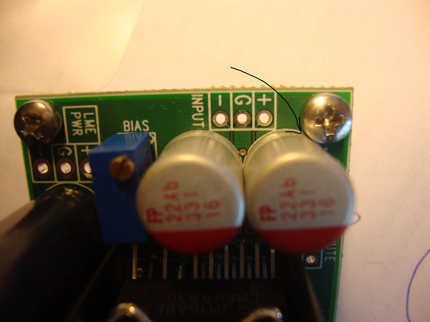

I had similar problem with my AC coupled SE amps when using a screw with too large head. Screwhead touched input cap.They work but I have the mother of all hums.
Other than that, i didn't notice any hum or other strange behavior, no difference how grounding was wired.

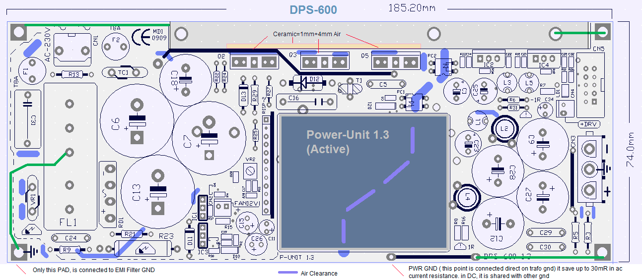

no need for grounding the amp to an external ground, just the GND screw term on the DPS power supply. here is the recommendation from Roberto. note the GND screw term on the corner, it connects to the AC line filter, that is connected directly to safety ground and thats it, the power supplies are double insulated afaik.
Note the CE mark too, so this isnt some whacky/risky audiophile grounding setup, rather the way it should be and given the amp topology, no need to have shield ground or safety ground anywhere near the amp side power supply, or signal ground. power ground (which is separate, on the clean side of the power supply, becomes the speaker return directly in Roberto's schematic, but it can just as easily just connect the ground on the amp board as speaker return. Try both, I intend to.
as for starting into 600mA, nope its not going to work any better on the dps500, it has the same auxiliary regulator section as the 600, so you will need to stick to 350-400mA, or install smart bias switching, hochopeper and I came up with an optically isolated switching scheme that can be manual, or connected to a controller for automatically handing it,

Owen
Assuming you are correct, which is not the case, explain how you handle the following:
- Loudspeaker binding posts on an amplifier
- XLR output from a preamp
Both of the above are exposed metal parts which cannot be bonded to earth while maintaining even basic functionality.
It's not about bonding everything to earth, it's about isolation between primary (live) side and secondary safe side.
Owen
- "The Wire AMP" Class A/AB Power Amplifier based on the LME49830 with Lateral Mosfets
