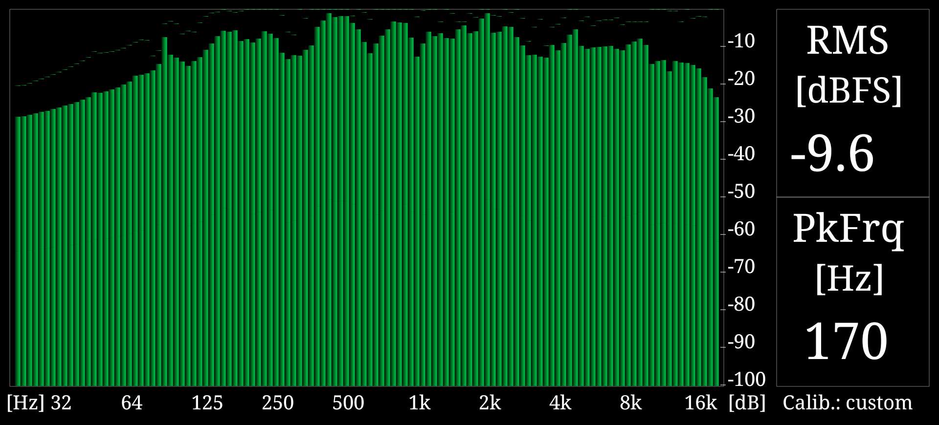

Built my wibaq's a year ago. I went a bit too heavy using 22mm MDF. but at least it is very solid.
Only did the sanding and painting of the enclosures a month or so ago. ( my wife convinced me its time)
Depending on who you ask they probably have enough bass.
It was a little shy for me. I'm running mine of a 30W per channel ultra linear tube amp.
I did a BSC with a simple resistor / capacitor in the line level between riaa preamp and main amp with single opamp buffer as per rod elliot guide. Setting for 3dB worked ,but i still was not completely happy.
I don't listen very loud on this setupr , but I do prefer a decent amount of bass.
In the end I added a simple bass boost of about 10db at 50hz with a single opamp between my riaa and main amplifier. I'll make it neat one day ,currently it just lives on a peace of vero board with seperate +- supply.
10db is unnecessarily much , but it does give it a lot of presence at low volume.
I'm sure i'll have an itch to change something again. But I do prefer line level active filters compared to large caps and resistors and inductors at the driver.
Having an active filter is so much easier with a single full range driver.

I am really surprised that the bass is weak. Did you over stuffed it ? Try to remove some of the stuffing. The last one third og the line is unstuffed.
I am using 4" Tang Band in my original TABAQ and very seldom use the sub for music listening.

Did do a test and removed all stuffing which had little effect. Only stuffing top part as per dumbledog's posts.
I truly believe it is a situation of my personal taste though. and possibly combination of ultra linear valve amp and speaker?
The same amp had much more bass with standard 2 way bookshelves.
But my understanding is that the ultra linear setup should actually have more volume at the high impedance lower end than a solid state would?
BSC helped a bit , but still not to where I like it.
i'm still learning and experimenting.
So my understanding is that for a valve amp with lower daping factor and higher output impedance , where the speaker has higher impedance there will be higher output V and thus watt.
I have not yet used a solid state amp on them , will try and test how it sounds.
Gastroschisis measurements on page 12 shows this:
The 10dBV gain I have at 50hz makes up for the drop.
I am going to modify my circuit for 6dBV gain at 50hz and do some more tests. the current 10dBV gain is a bit Bassy , but nice to my bass freak ears :) especially for older pressings that is normally lower on bass.
With the current 10dBV gain at 50hz I have no need for any BSC or other circuits with these speakers and they sound VERY nice to me.
