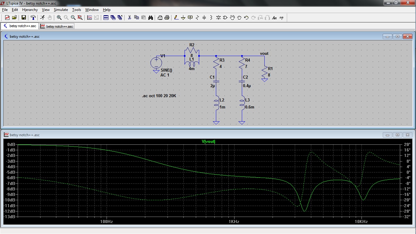

Hi folks,
thank you for all, and to the guy who desgined this piece of art.
here is a filter I designed for Betsy in WIBAQ, BSC + notch to tame 3.5K and 10K.
ajust with slightly different value of Rx.
regards,
seb

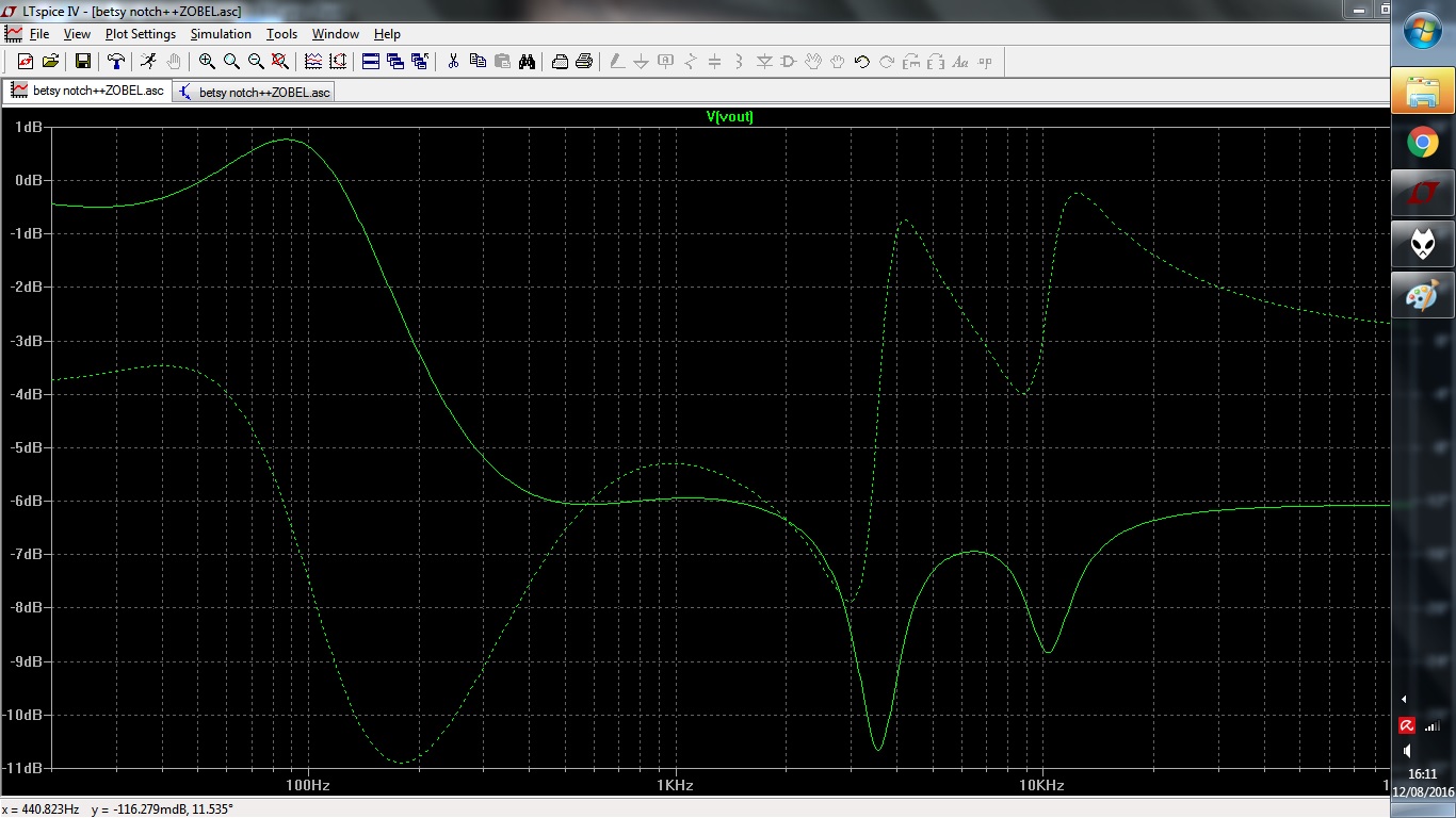

I will build it soon. At this moment I use Foobar EQ, +6dB from 0 to 400Hz, slow slope, -6dB @3.5KHz, -4dB@10KHz. It sounds great. No harschness no "sssss" nice voices. I can listen for hours with no pain.
If impedance rises too much I will do something Zobel style. BSC could be tricky but the frequency of the 2 notches is not speaker dependant.

great job !!!!!!!!!!!!
The longer I'm at this, the more I believe most full range drivers need a 10 band eq.
Nothing wrong with that, I just can't grasp that drivers past $200 need it too.
Baffle step, well, everything needs that, especially with our lower volumes we listen at.
Without baffle step and that pretty big peak near 3.5khz, I can see how betsyK could be hard on the ears.
I'm surprised you don't need more attenuation at 3.5khz.
I like a dip 1-4khz.

I listen the Betsy's close range, 3.3 feet. I don't toe them in too much. Now i only tame the beast -4dB@3.5Khz, -1.5@10Khz. I use "graphic equalizer", a plug in with FOOBAR
Here is the file of my EQ. Feel free to try another values.
I will do the EQ with RLC later, and also a solid wood WIBAQ enclosure for the Betsys.
