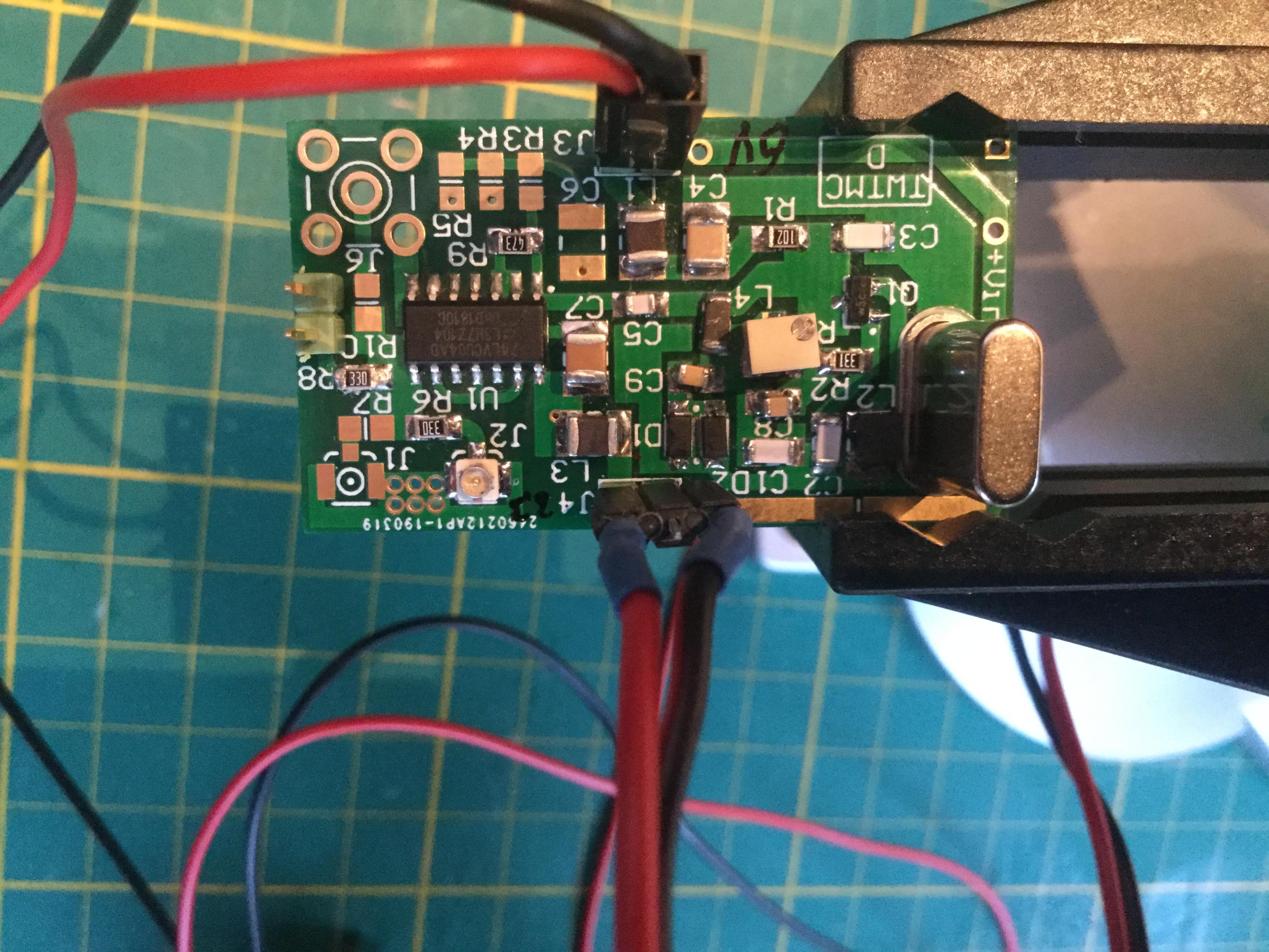

Hi Andrea,
I have build my first driscoll clock unit with a 45.1584mhz sc-cut crystal.
The build is fine as far as I can judge. Smd soldering is not too bad if the right tools are used, soldering paste works very good.
The only thing is that there were two parts that mouser did not have in stock, I started out with an alternative:
L4 should be 1,5uH, I used 1,8uH (also have 1,2uH in stock)
Q1 should be NE85633, I used MMBT5179 but I do not know how to select for high hfe.
The clock is not working on Ians fifopi.
Do you have any suggestions?
Or maybe an adress where I can get the correct parts (for a reasonable price).
Do you have an oscilloscope to measure the output? I got 24.576Mhz working, but the 49M never worked. I suspect the 45M will do the same. At my best, it only outputs 16.x Mhz. The parts here are very sensitive.

L4 is a critical part since it's used to tune the oscillator at the crystal frequency, so you should use exactly the value indicated in the BOM. It seems that Mouser has the part in stock ILSB1206ER1R5K Vishay / Dale | Mouser Europe
To select the hfe of the MMBT5179 you need a DMM that implements this function. Anyway the oscillator should work properly with the MMBT5179 without any selection of the part.
Finally, you need an oscilloscope to see the output of the oscillator if it does not work correctly.
Please, remember to set the bias of the bjt by trimming R11, as in the assembly guide at page 18.
Andrea
P.S. You can source the NE85633 here: NE85633 (2SC3356) NEC | Silicon bipolar NPN RF transistor, SOT-23 | Buy on-line | rf-microwave.com
Andrea
Hi Andrea, (and Canvas),
Thanks for your assistance.
I have an old tektronix 335 scope that goes to 35MHz (and an old Philips tube scope on 10MHz) this will not be of any use for these problems.
The bias of the bjt is set as described.
I will get the correct L4, it is in stock now at mouser but was out of stock when I purchased the components. If I understand you correctly the transistor will be ok so I will leave it for now and see if it works with the right L4 value.
Yes!

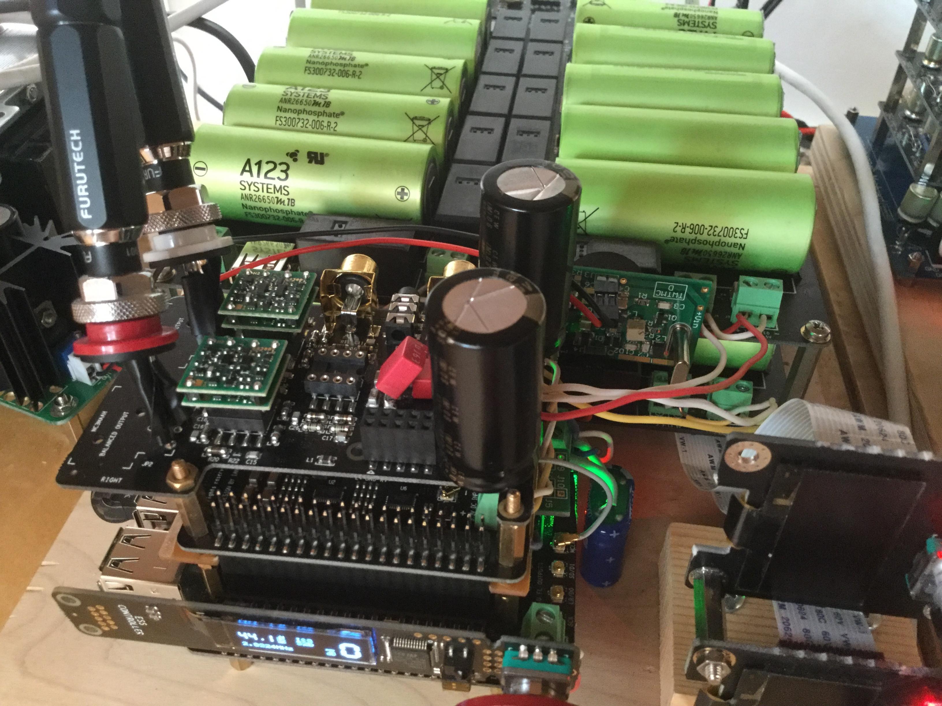

I got the 1,5uH from mouser today and the clock is working now.
I did not check the signal with a scope but it is playing music on my fifopi currently!
Now its time to let it run in for a while.
