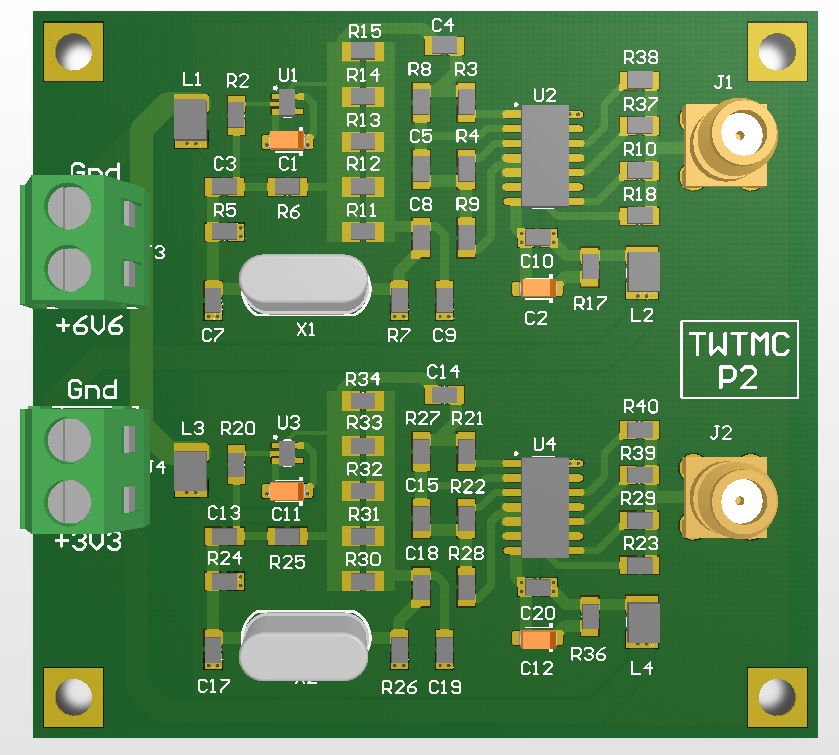

I don't know if Ian's FiFoPi supports 5.6448 MHz with 24.576 MHz.
You could use the new TWTMC-P2, double Pierce oscillators on a single board, maybe battery powered.
It's born to accommodate 22.5792 Mhz and 24.576 MHz At-Cut crystals, but you can replace the first crystal with a 5.6448 MHz simply replacing a few components.
It will be available soon.

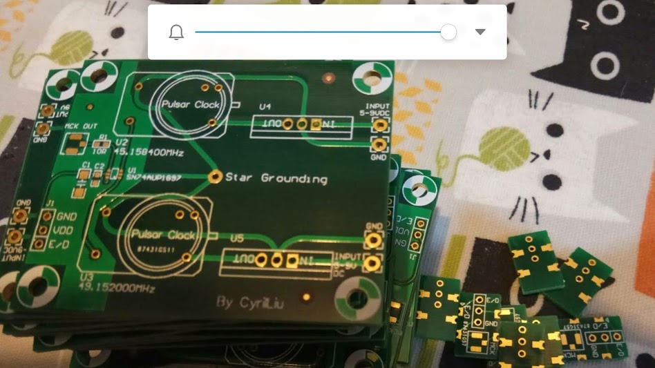

I have designed a similar clock board under the guidance of pulsar clock.
