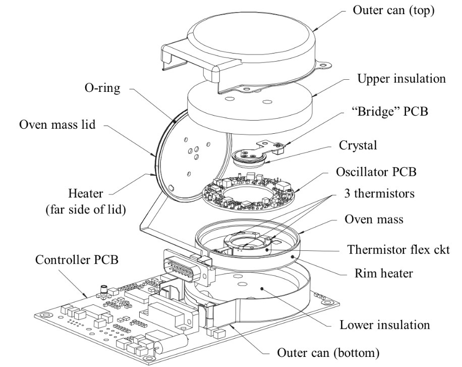

Maybe this will help or give you some ideas:
http://www.karlquist.com/osc.pdf
http://www.karlquist.com/oven.pdf

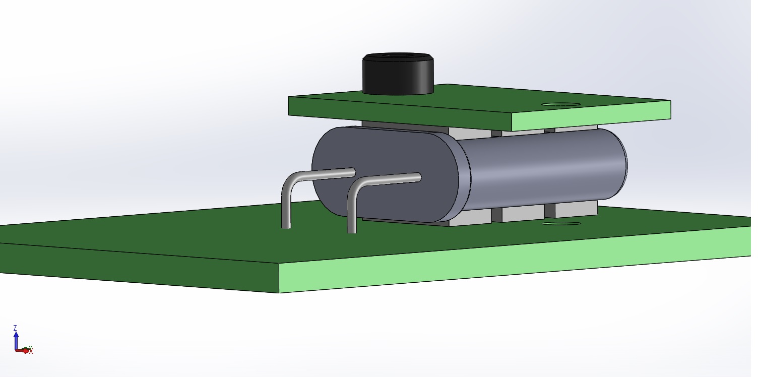

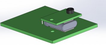

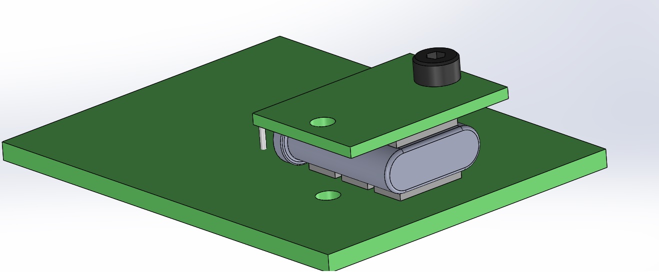

Andrea,
I've had a look inside a few OCXO's that I have used and they had a flat
heating element mounted on pcb with the XO can bonded directly to it. It
seems like a decent system. You could perhaps even sandwich the XO can
between the main pcb and a small top pcb to get better heating efficiency.
The heating elements can be smt 2512 high temp resistors with some small
mica washers to prevent shorting on the can.
Refer to the CAD pics.
cheers,
Heater

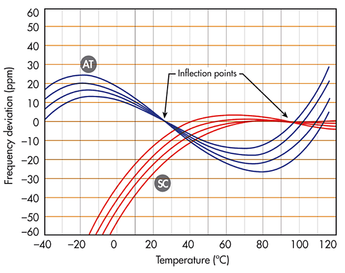

But keep in mind we are not building an OCXO for satellite communication. Some long term frequency deviation is not an issue in digital audio.
Take a look at the attached image: optimum working temperature for SC-cut crystal is around +85°, but a variation between +50° to +100° gives a deviation of 3-4 ppm.

Since low phase noise at 1 Hz is a goal the thermal mass should be large enough to slow the change to reduce the phase noise impact from a temperature change. Done right it would also reduce the vibration sensitivity.
SC-cut crystals are reportedly less sensitive to vibrationally induced phase
noise but there seems to be conflicting information about that. Regardless, it's
probably worth trying some additional mass together with isolation.
