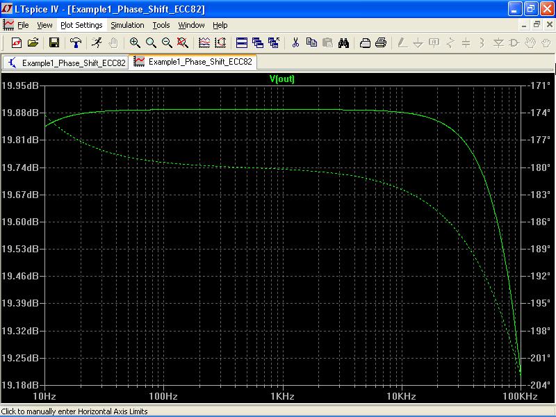

When youdid the volume pot noise tests, Did you leave the amplifier input impedance at normal value or short the amplifier input to ground?
Post#4, the same for all preceding simulations.

No, it is a misinterpretation, let me explain
If you read more carefully, general design goals are
When designing a Preamp only remains for us, as design goals, the basic and standard
a) Low distortion, preferably predominantly second harmonic (the lesser evil)
b) Good dynamic response.
c) Good bandwidth.
d) Small phase shift.
e) Low output impedance.
f) Low noise.
For a particular case
1.- A traditional approach
Input => Pot => CC + CF => Output
i) Phase shift
As a reasonable design goal, is expected +/- 5º phase shift from 20Hz to 20KHz.
The worst case regarding the pot is at half the resistance, ie 50K + 50K when the output impedance reaches a maximum, supposing an ideal source of Z=0 ohm.
The only valve that I know for this requisite and a reasonable low gain is the ECC82/12AU7.
In the first simulation can be seen that hardly achieve +/- 5º phase shift.
ii) Noise
Meanwhile, the thermal noise produced by the pot over a range from 10Hz to 100KHz is 6.4µV RMS (second simulation).
For a tipical gain of 22dB, at the output the noise is about 80µV RMS (third simulation), only due to the pot !
For the proposed approach
3.- Another approach
Input => CC => Pot => CF => Output
i) Phase shift
In the fourth simulation we can see that the goal of +/- 5º is easily achieved over a range from 10Hz to 100KHz.
Not bad, right?:D
ii) Noise
In the fifth simulation, we see that now the output noise is about 7µV RMS !
Remember that the volume pot is not the only source of noise, neither the only resistor, and mathematical models of valves don't take noise into account.
However not a bad result...:cool:
Simulations are placed on the correct order, however should be placed separately to illustrate each particular point and avoid future confusion and complains.
Let me clarify that I always do simulations on the 10 Hz - 100 KHz range, so first simulation should be
attachment.php
But the point to illustrate became obscure now, for the scale factor. :rolleyes:
