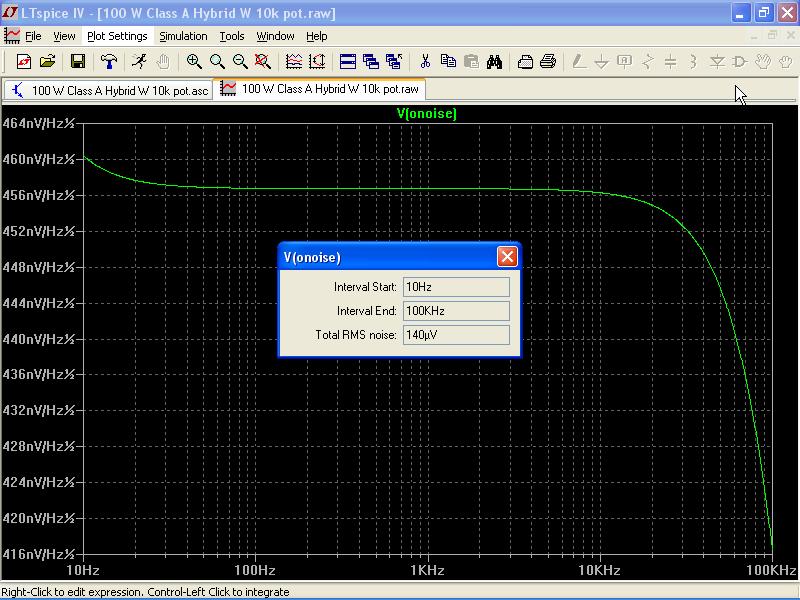

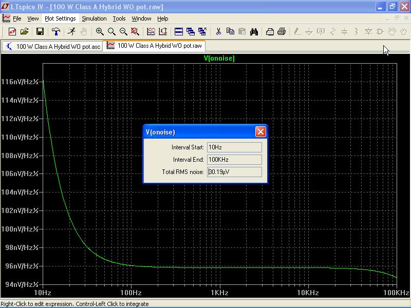

Hi Ian, hi DrRick, thanks for the links ! :)
Now try to show that putting a pot on the input of a high gain amplifier, in this case a 100W class A hybrid, is not a very good idea.
Sim#1 - Amp without pot.
Sim#2 - Amp with 100K pot.
Sim#3 - Amp with 50K pot.
Sim#4 - Amp with 10K pot.

What you say is correct, there are only a few posts referred specifically to the pot, some joke among friends, and as any exchange of ideas, several interesting issues arise.
Pots, or variable attenuators, are a necessary evil in any practical music reproduction system intended for use in a domestic environment. Many systems moreover, manage to have a pot without any audible noise. Even in those systems where there is audible noise, it is masked by the music in most circumstances, and noise is regarded by many as the most tolerable of flaws in a reproducing system.
In the world of the SS, the pot presents no difficulties, being low impedance devices, you can put very low pot values.
However, with valves, it gets more difficult, and the noise starts to be an issue.
We also discussed the effect on bandwidth and phase shift.
So what's your point?
As you say, the pot is a necessary evil, my point is to put it where do the least damage. :cool: :D

It is fairly obvious that a large value pot contributes more noise than a smaller value one. It is also fairly obvious that the noise contribution of a pot will be greater if you put more gain after it. So to answer your question it will create the least noise if it is last in the chain. So what you really need is a 100W constant impedance T pad connected between the 100W amp output and the loudspeakers. This may well affect the damping factor but that is a whole other debate.
What you really need to look at are ALL the noise sources in the system including the source material and compare their values relative to the pot at each proposed placement of the pot.
Something to consider: just about every professional mixer uses 10K faders so just about every source you feed through your pre-amp has been through at least one and probably several 10K pots. If you use a 10K pot at your pre-amp input, how is its noise contribution likely to compare with that of all the 10K pots that preceded it?

Fair enough, but I think calling the volume pot a 'villain' is a little premature.
That is precisely the idea, but as I said before, we have no control over the source material, for each format, analog or digital, it can vary greatly depending on the recording company, not just blame the recording engineer.
And the point is there is a whole range of noise sources in the pre-amp that you can control and pot noise is just one of them. You need to examine and quantify the others before you brand the volume pot as the 'villain'.
