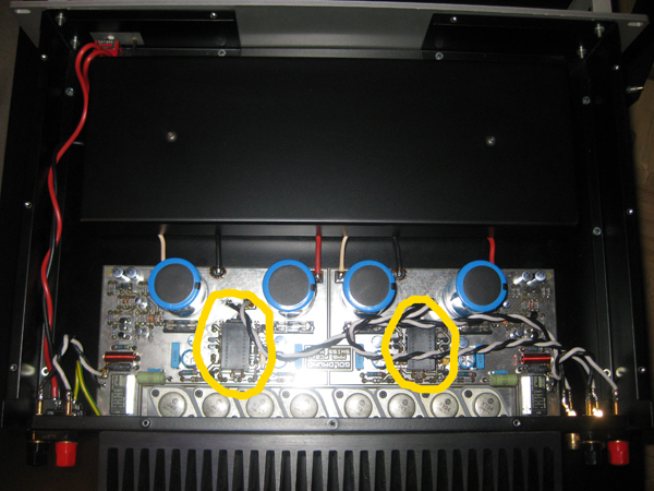

OP amp module is potted in a plastic case in the original Goldmund. Goldmund would provide schematics without the module. It was their secret.
Is OP amp module same as A1?

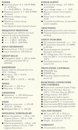

Look at the warranty. Ten years parts AND labor. I know of no other warranty that nice except Bryston. Several bad design issues and you are out of business.

Has anyone every experienced the transitor vibration issues stated in the Goldmund writeup. Supposedly the reason for potting the input stage.

NVD33 - perhaps this is issue of mechanical vibration not a show stopper. There are devices around that can mechanically isolate things such as PC hard drives. There is also a great deal of technology and tricks that we can borrow from TT mechanical isolation. Do not despair or give up just yet - for all we know this is just sales brochure cow manure - or perhaps something not of importance at lower wattage levels. Buuuuuuut perhaps Goldmund is onto something here! After all if you put a transformer under increasing heavy load you can feel the mechanical vibration increase with load and often times hear the sound of the transformer increase with load. Such vibration of the transformers windings if often experienced with poorly made or badly aged xformers. I think that by using quality parts and some rubber isolators (or whatever) the problem could be licked - perhaps even made better.

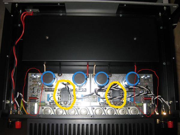

and I wonder about the use of both a zobel and output series inductor

apexaudio - Yes, the Goldmund A1 module is the same as the OP amp module in my schematic.
Guys, I wouldn't worry about the mechanical issue. Yes, it helps. Yes, Goldmund uses it, because they can and they charge lots of money. Yes, it does make a sonic difference. But it has nothing what so ever to do with the amplifier working properly, or not. It's the same as putting hard metal cones under the heatsink, or where the output transistors are located, only that Goldmund incorporated it into the entire design. Please do not make this into something it's not.

tinitus - There are just as many audiophiles with broken equipment as there are with Bryston, or Ayre, or Levinson, or Boulder, and the list goes on. The Zobel and the series inductor are both necessary because this is a wide bandwidth amplifier, it might oscillate without them. Not a bid deal at all.

Doesn't the Zobel work better when mounted to the back wall of the chassis?
Leach decided this was an issue in the Super Leach amplifier. Catch the high frequency critters before they infect the board.

tryonziess - Having Zobel on the board is no problem at all. As a matter of fact, all Goldmund amps have the Zobel on the circuit board.

I see some small issues with board layout
only 2 mounting holes
transistor legs solder points seems a bit far from heatsink
it cannot be mounted horisontal without mounting angle
parts of supply rail line seems smallish
many paralel copper lines
ofcourse I dont know, but it seems to me you may find it better to have supply and groundplane closer to the middle of board
if boards a professionally done, it would be natural to use double sided boards
but ofcourse that would make a DIY copy difficult
