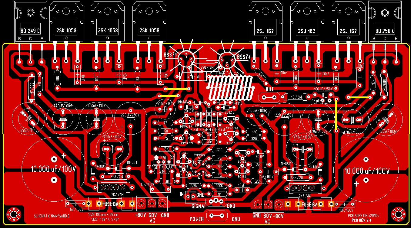

He claim 1000V/uS slew rate...
The amp described in this thread is at 90V/uS at most,
still a respectable number, but nowhere close to claimed figure.
If this amp is good, it has more to do with Hitachi s lateral fets
than with a so called design philosophy as the schematic himself
is a poor variation of broad designs at the time...

You are a true artist with the pcb design. How you accomplish this so fast is beyond me. Nice.
After reading the Goldmund article it might be a good idea to limit most builds to 60 volts. All of this leads me to believe any small changes in the layout could result in high frequency oscillation issues. Much of Goldmund's design engineering was not done by accident. Potting the small signal transistors and coupling the stages together cost money. Something commercial companies do not do unless they must. Just a word of caution.

I have to conclude that Goldmund had an error in their schematics.
I also believe that part of the Goldmund secret formula was their mechanical grounding scheme and layout.
A good amp when used correctly but can be improved quite a bit by addressing the current mirror on the second differential.
The amp was always on the verge of instabilitry and increasing the value of the gate stopper resistors sometimes helped.

PCB rev 2.4 top and bottom side in black and white
.... let's see PCB rev.2.4 top and bottom side .I can do it better , but I need more time ....may bee in weekend , until then I will doo some change ..:)

According to this article there was (is?) considerable care taken in the grounding and mechanical isolation of the power supply, torfo's, signal PWB's etc., and without this included into the construction of the amplifier it did not perform to it's best capabilities. Thus even the best PWB's and components will not matter much unless a suitable chassis etc. is included as part of the construction.
I do know that mechanical stability is an important consideration around lasers and some hi-freq. RF, but had not considered it in the area of audio amps (TT's and CDP's sure). Any thoughts about this aspect of construction?

Distorsion is very high in respect to current standards,
even compared to a cheap gainclones...

Let me state at first that I am no guru. However, I have assembled a few projects with OP amp ic's and quite a few LM3886 "gainclone" type amplifiers and not installing a low value film cap as close to or on the legs of the IC there was always some interference. I find it hard to believe that this discrete OP amp type module has no film caps anywhere for stability. It must be in the design.
Alex, What type of resistor dimensions did you use in the layout. Will full size Vishay/Dales fit this item. Not that it matters that much.
