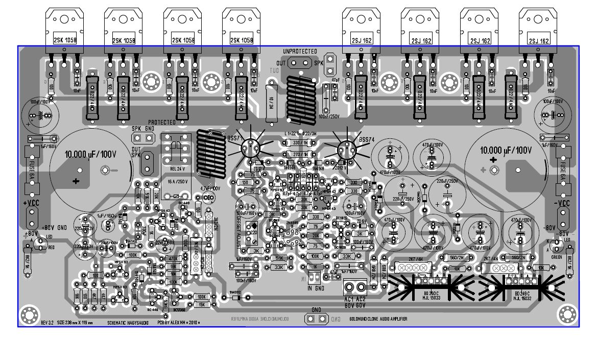

Here's a challenge for Lee Knatta, Tinitus, Jam, Krisfr, Jacco Vermeulen, and Ostripper:
You guys are "EXPERTS" in grounding schemes and negative feedback traces, so can you please take the below picture (of Alex's current PCB layout) and draw in GREEN (Photo Shop, Paint, etc.) the correct ground traces (star ground, separate power and input ground, speaker out, transformer ground for 60VAC, etc.)? .......
I understand you simply don't care.
Why should I do pcb design for you?
Good luck with your pcb for the magic Goldmund amp.
If you look at the photo in post #140 you will see a STAR Ground, unless you are blind or do not want to see it.

Yes, this looks like some partitioning of ground.
Resulution is way too low for an exact analysis but I can see something, too.

Bigpanda - If no one wants to improvise the grounding scheme, I think we are good to go with the group buy for Alex's latest PCB layout. I looked it over and there seems to be no mistakes

Given that I have learned a lot from this forum and to help those that have invested time and resources to this thread, I choose to lend some thoughts.
I feel for Alex IF he has to discard most of his Fine and honest work...
Nagys: Take a big bite of pie, humble will do. Show yourself that you are willing to LEARN
Now
Take note with a high def photo of the original board, notice the zones
Zone your board accordingly
duplicate the front end mod (with a small board if need be) in one of those zones
Put a Star ground point in the middle of the board
Establish an output Zone with larger traces for the supply lines
take a big fat ground trace from each zone to the star ground
No ground lines on solder side.

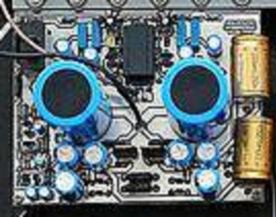

This is a very good question Nagys. Is there any chance of getting some high rez close up shots of the Mimesis 9.2 PCB ?
That pic that has been posted is of a Mimesis 6 stereo amp I think.

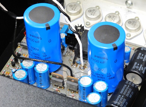

Ah, you can't see the star ground, or would you like to read the output device number ?
any more pics? BTW,It's a little different from the one in the post #140.
You mean the black 160V Siemens-B43 220uF axials instead of the Goldylock 250V Roederstein-EG series electrolytics ?
Other than that, only difference (i.c.s) are the additional TO-92 plate coolers for the Vas devices.

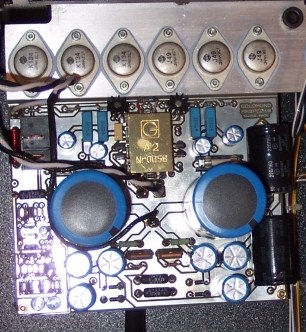

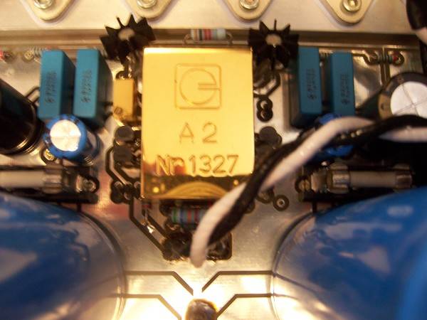

Speaking of Swiss perfection, the goldplated A2 upgrade modules didn't quite seem to fit without bending the drivers+TO18 Stargate heatsinks.
OopZie (Z = for Swiss accent).
The Telos monaurals and up are modular, see Telos 400 pic in post 902 ;
- Front end stage on a separate board right behind the inputs.
- Zoby coil soldered at the output terminals.
- AC carrying stuff as far away from the input as possible.
- Powersupply + protection circuitry on a separate board.
- Foil nF caps at the source of each output device.
(plus usual stuff as inrush limiter for the transformer, no rail fuses, other usual "audiophile" crapp)
