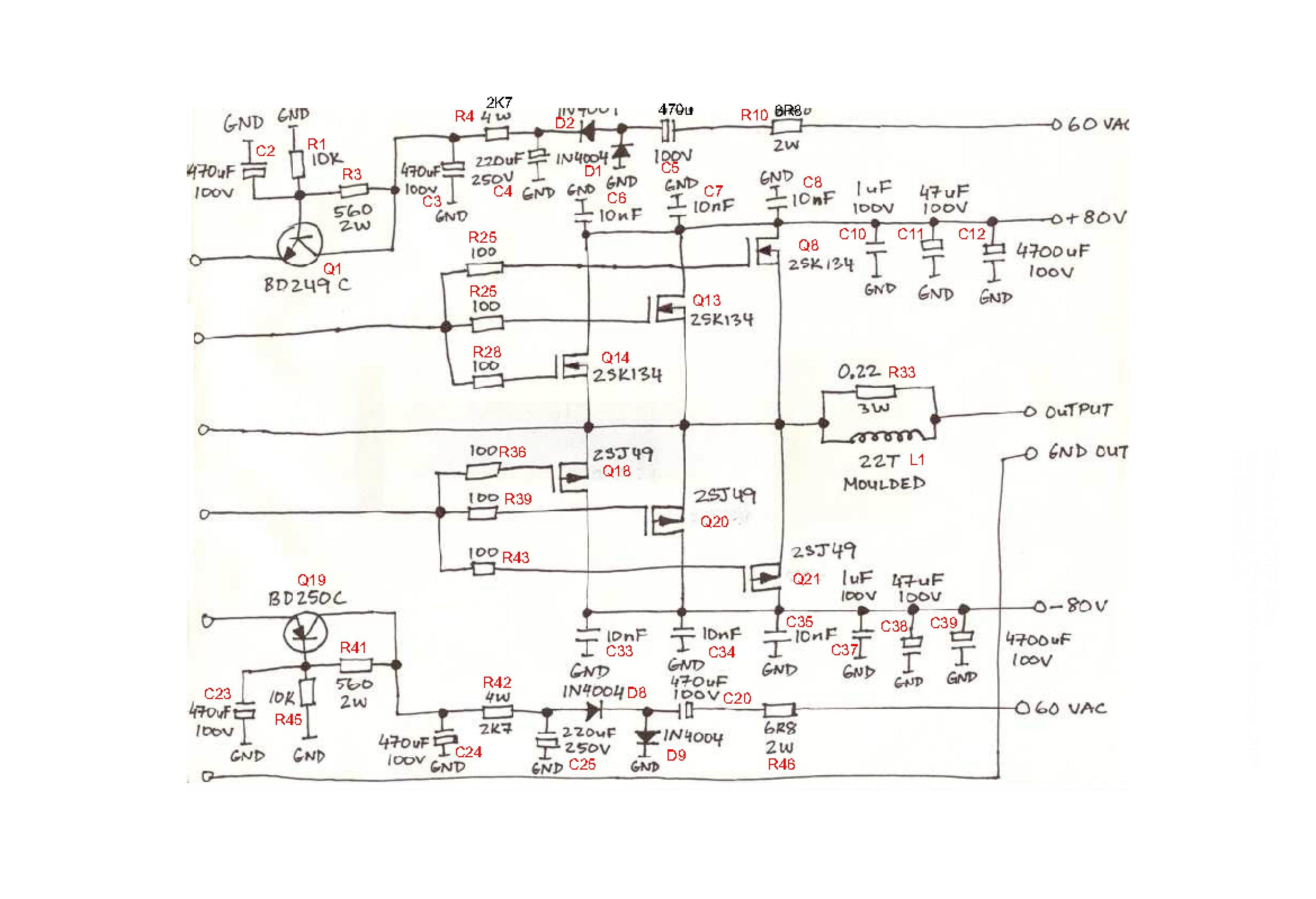

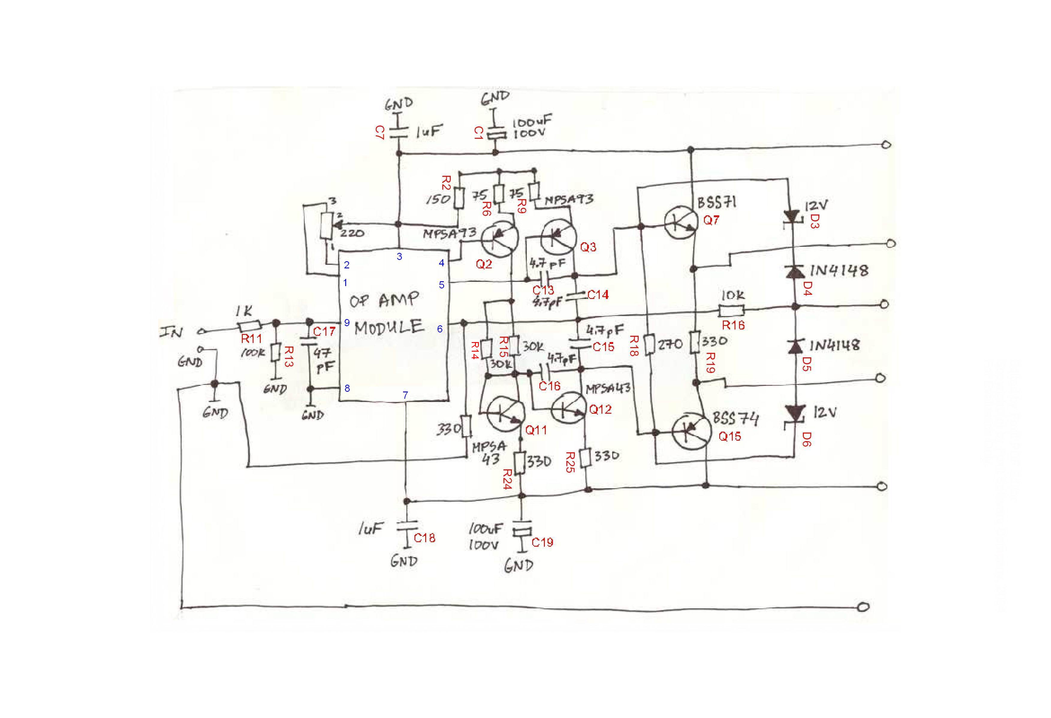

I have ID the components on the original schematic post by Nagys using Krisfr's scheme. I tried to us Krisfr's posted schematic but it was blurr when I zoom in. Just in case anyone might find it useful. (at least I do). Still checking if there is any mistake.
Hi Krisfr,
There is a 330ohm between the feedback of the op-amp module and ground in the original schematic posted by Nagys which does not appear in your schematic. Your R12 should go to the signal ground but it hadn't. Is there any way you can posted a clearer schematic (or is it just my ACDSee software that is screwing up?). Tks. I try to use yours but there are some difference so I labelled the original one. Hope you don't mind I am using your scheme.
Hi Krisfr,

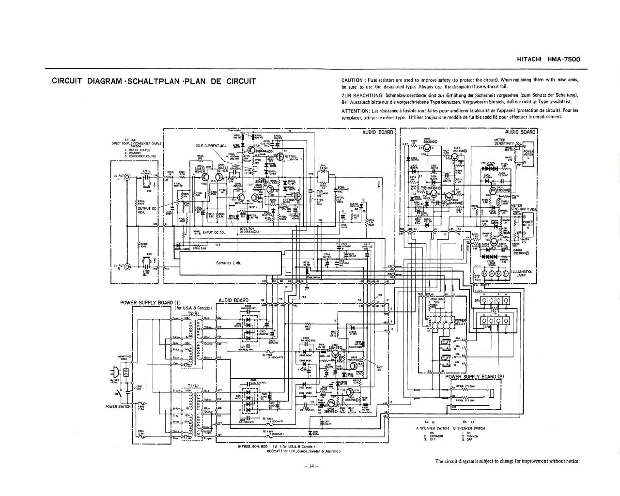

'Goldmund' is HITACHI HMA-7500 from 1978 with 'improvements', my F100 (with HITACHI MOSFETs) also, you can use old HITACHI design
I have absolutely no problem with ANYONE using the schematic I posted. I will update it tomorrow and hopefully post a totally completed one by the afternoon. I had a steep learning curve for the KiCad and my eyes are not as they once where.
I will re-post with a sharper image, I reduced it too much in order to comply with the DIYAUDIO upload limits. Will do better.
If anyone sees any other errors I will fix and post...

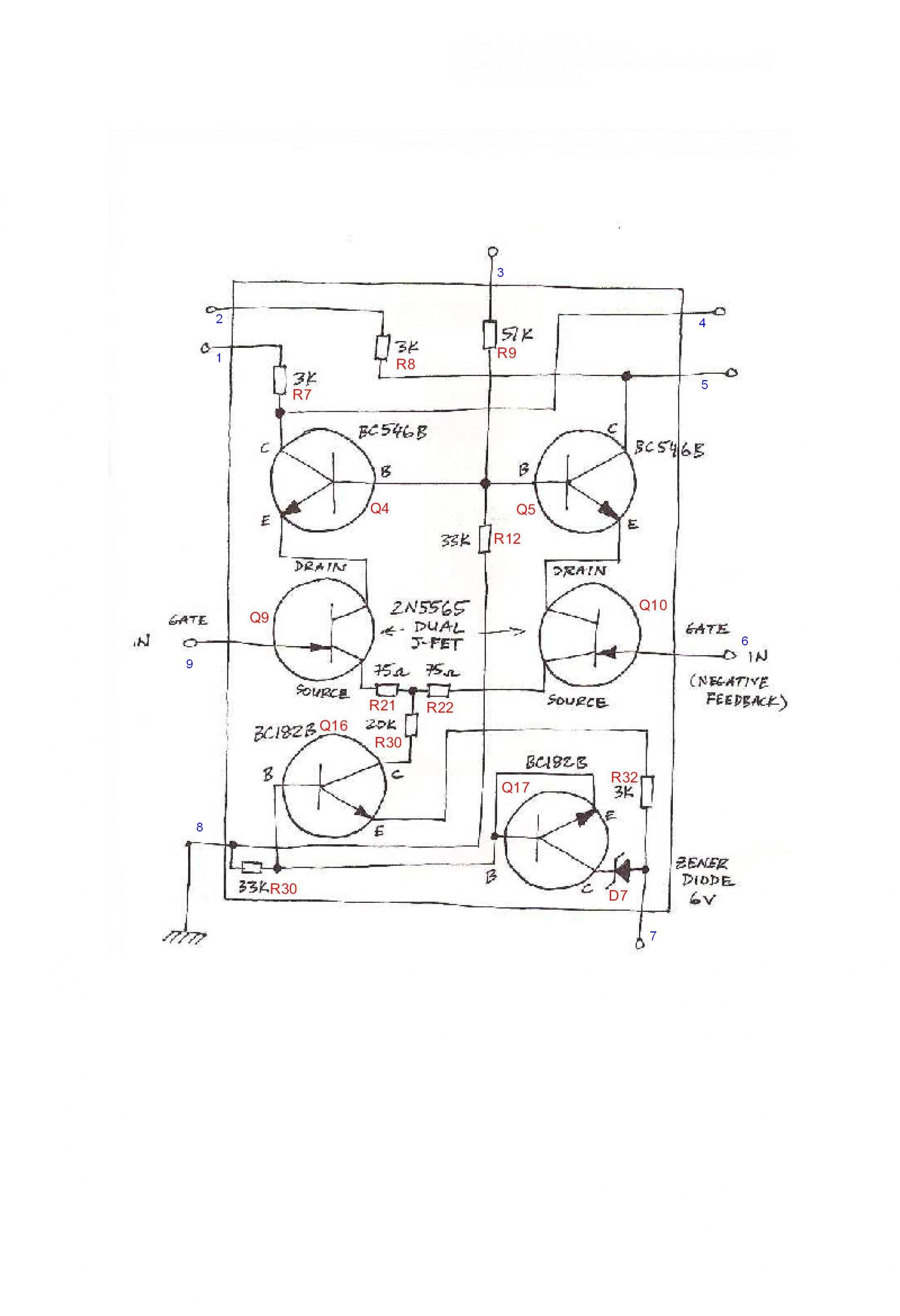

Hi
These is a another Goldmund design. I would be interested on these to .
All I know these is the mono block , newer version.
Any opinion on these schematic??
Unfortunately these PC board to complex to me ....
Some picture and the schematic..

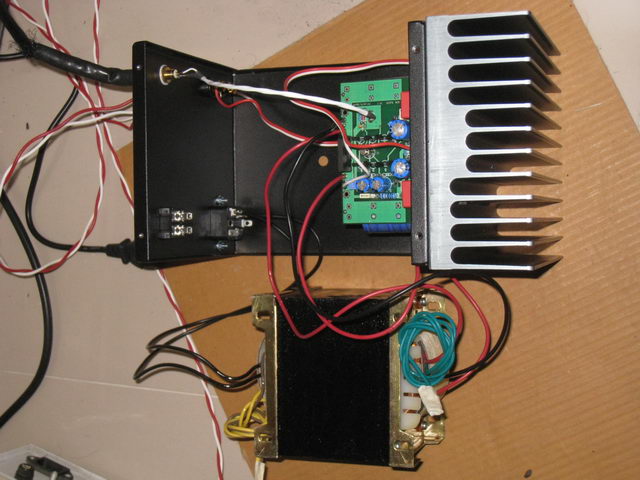

Hey !
These're my puctures that I cloned from original Goldmund for a long time.
I also have a Cloned & modified chassis from JOB to fit with my Goldmund Cloned, he he
Now I used Toroidal transformer instead of EI.

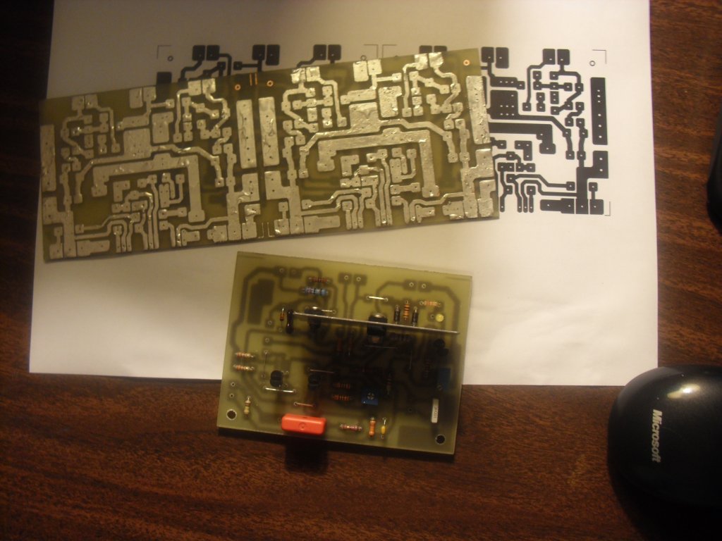

Hello
..................I purchased laser graved 2SK246GR 40PC and garbage , I tried to match them and impossible , at the end I thought check if I can measure hfE , but nothing!

Hello Anadigit
Welcome here!
Yes that yours , I posted only so people know the modern Goldmund got simpler than the older ones .
Of course that is not mean the new one sound worst . Actually I never heard not even one!!!!
I don't think a company remain in business if they start produce worst projects. And cost more and more the new project..
Sorry I didn't purchased your kit (only reason I do not like SM resistors)
I would be still interested in case I could chose my favorite resistors.
I hope you don't mind I posted your pictures.
Some people didn't believe that your schematic orig Goldmund!

Aren't these JFET's ?
Hello
Yes they are JFet . But when I tested 20-25PC and al dead ...
I thought may be the company put wrong label on the pars so I tested with hfE to.
Nothing , garbage!

gaborbela - Please take a look at my schematic on page one. It seems people keep asking the same questions and they are right there on page one. The amp uses (2) 4700uF capacitors per channel. Alex made them into 10,000uF when he designed the PCB, it makes virtually no difference. You can use whatever you like. I wouldn't use below 4700uF personally.
All wire is stranded.
Transformers seem to be 200VA, or so. I cannot see them because they're potted. But again, makes virtually no difference. Use 300VA if you'd like. Or whatever fits into the chassis that you'll be using.
Power supply is extremely simple. (2) transformers per channel, 200VA-300VA, and a standard diode bridge. Thats it!!!!
The rest of the power supply is already in the schematic that I posted on page one and in Alex's PCB.
You will need a preamp to drive this amp, just like you would with virtually every other amp.
Goldmund uses all Philips/BC capacitors.
All Vishay resistors.
Mostly Motorola transistors.
I happen to own a HMA-7500 and it has indeed a particular good sound with incredible punch and dynamics.
I would strongly advice to start a new thread, giving both opponents and proponents more room for productivity, each with their own valuable approach.
