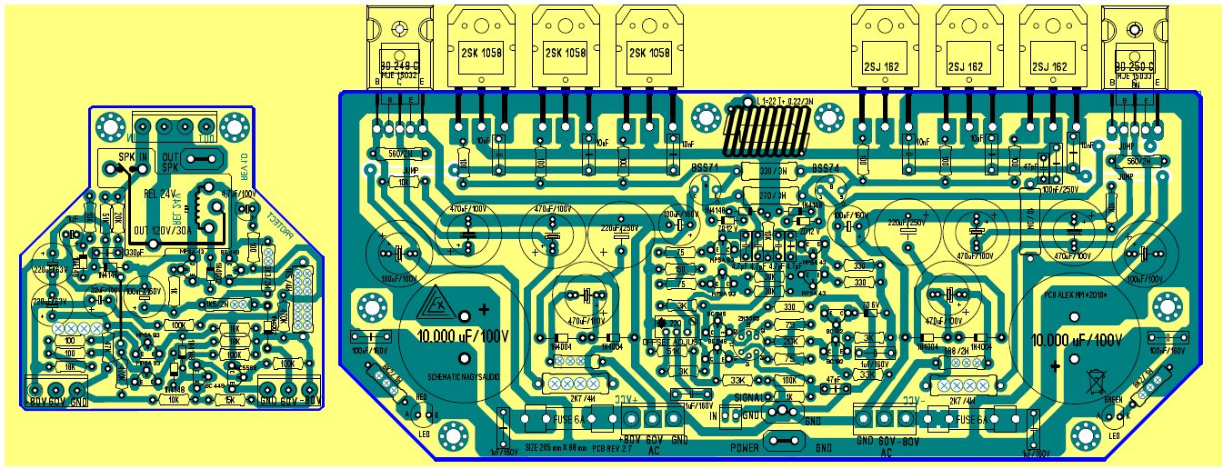

Alex, as always you're doing an amazing job and I cannot wait to see your final PCB. If I may make a quick suggestion and maybe someone else can also discuss weather it makes sense, or not... Can you leave the 24V relay on the main circuit board? Sonically this should be better, as the output signal will travel through the relay and to the speaker terminals, staying on the same PCB. If you mount the relay on the separate PCB, then the output signal will have to first travel to the protection circuit PCB, then back to the main PCB before it goes to the speaker terminals. Thanks!

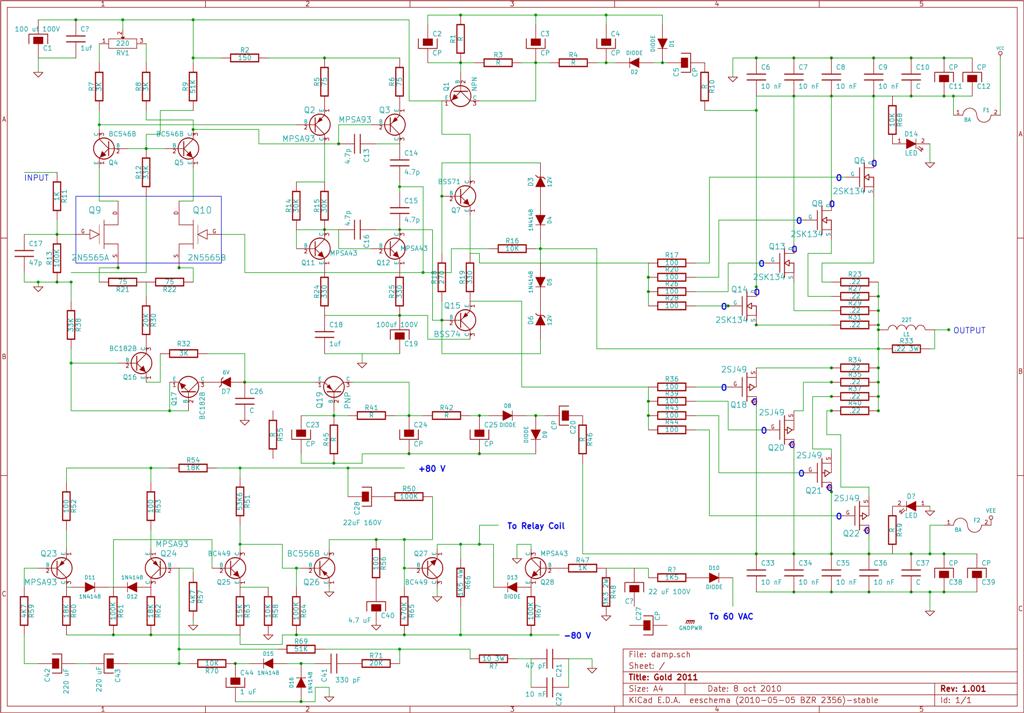

It's extremely stable below 4 ohms. Just like any other very high quality amplifier. Here are the specs, at the bottom under "Mimesis 9.2 Technical Data." This is the same exact amplifier which schematic I posted on page one.
http://velero-ii.com/Kraftwerk_Audio/Goldmund_Mimesis_9_Amp/Goldmund_Mimesis_9_Amp_Brochure.pdf

I have obtained the best results by combining all the stuff: PSU - AMP - LS Protect - on the same PCB.

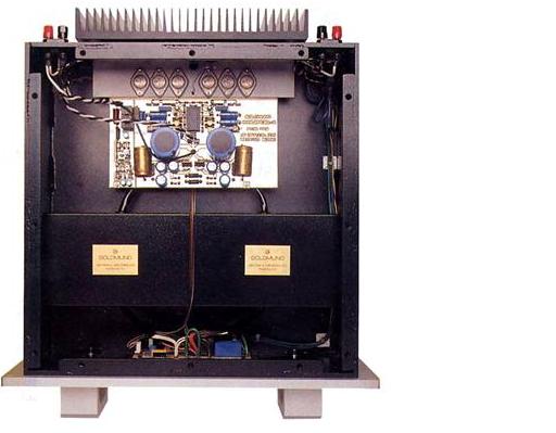

I have found a picture on the net of the acual Memesis 9.2 monoblock.
On the left is the protection circutry and above the power caps is the fuses, I think they was 8A fast types.
One thing NagysAudio, do you have access to a Memesis board from this time 1980 - 1990?, some photos? I am wondering how the ferrites was mounted (if any) with the TO-3 cased power transistors.
One other thing, looking at the PCBs on the Memesis 9.x photos they are manufactured with tin coating on top of the copper traces, sometimes called HASL. This is the old fachion way of making PCBs and I really like that. This may be one reason why the old version did sound better than the current models. The current models seems to all have green solder masks. I think that the green film, solder mask, can have uncontrolled effects of the performance of the circutry. I have not found any discussion about this in the forum so here is a link that explains it: Article - RF PCB Design (see third section)
The board is not going to be wave soldered anyhow so why not try HASL for this project? I have seen some other very expencive audio equipment using immerson gold instead of solder masks...

tommy1000 - Yup! That's the picture of Mimesis 9.2, the schematic that I posted! The fuses are actually 10A fast types. The amp has a super simple power supply, 2 transformers and a bridge, all potted of course because they're Goldmund! The TO-3 MOSFETS did not have ferrite beads on them! I have a Mimesis 6 amplifier and a Mimesis 3 amplifier, but I rather not take them appart to take pictures. Many can be found on the web, like the one you just posted.
I agree with you on everything you said regarding the PCB. So then here's the question for the forum... Does anyone have the ability to make a PCB board in this fashion?

PCB final version .....
.... after countles variant and revisions the final PCB
Regards Alex.
.Protection board on top of main board .Regards Alex.
