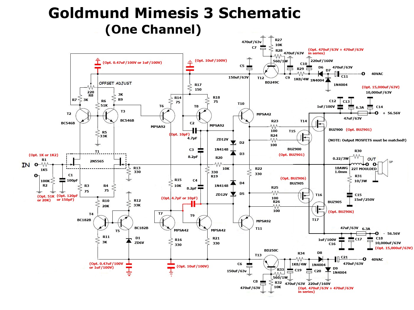

There is no cable attached to the input. Just the shorted terminals. It has 20 mV and it is measured at the speaker output. Matches the picture from my previous posts.
I would like to eliminate it.
20mv AC or 20mv DC?
If DC , you can adjust R8 pot.
If AC ,(it's a little difficult) you must start ;remove 8,2pf capacitors,cut legs and re-soldered.

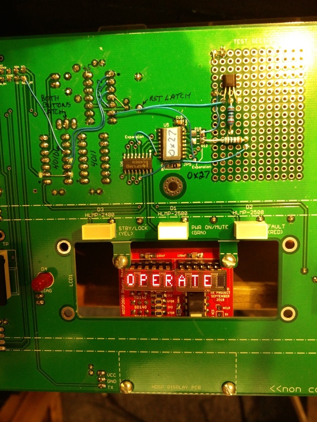

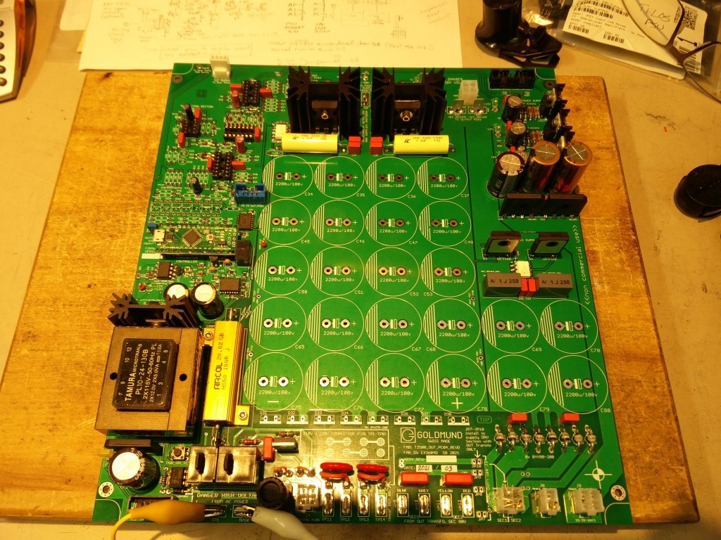

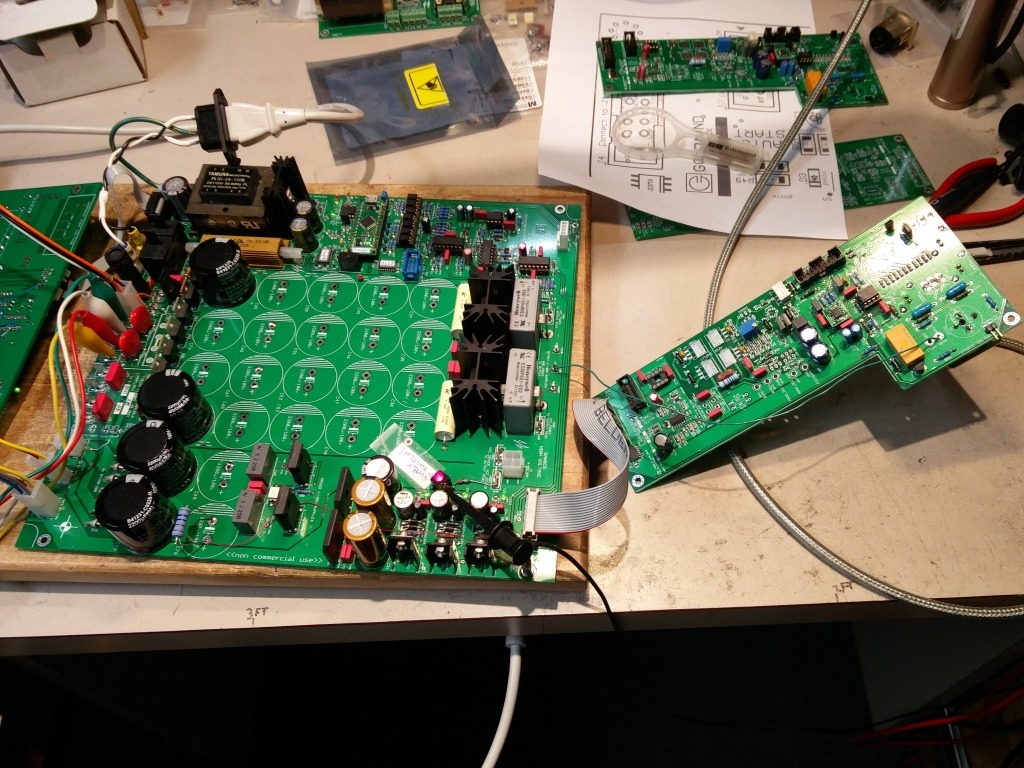

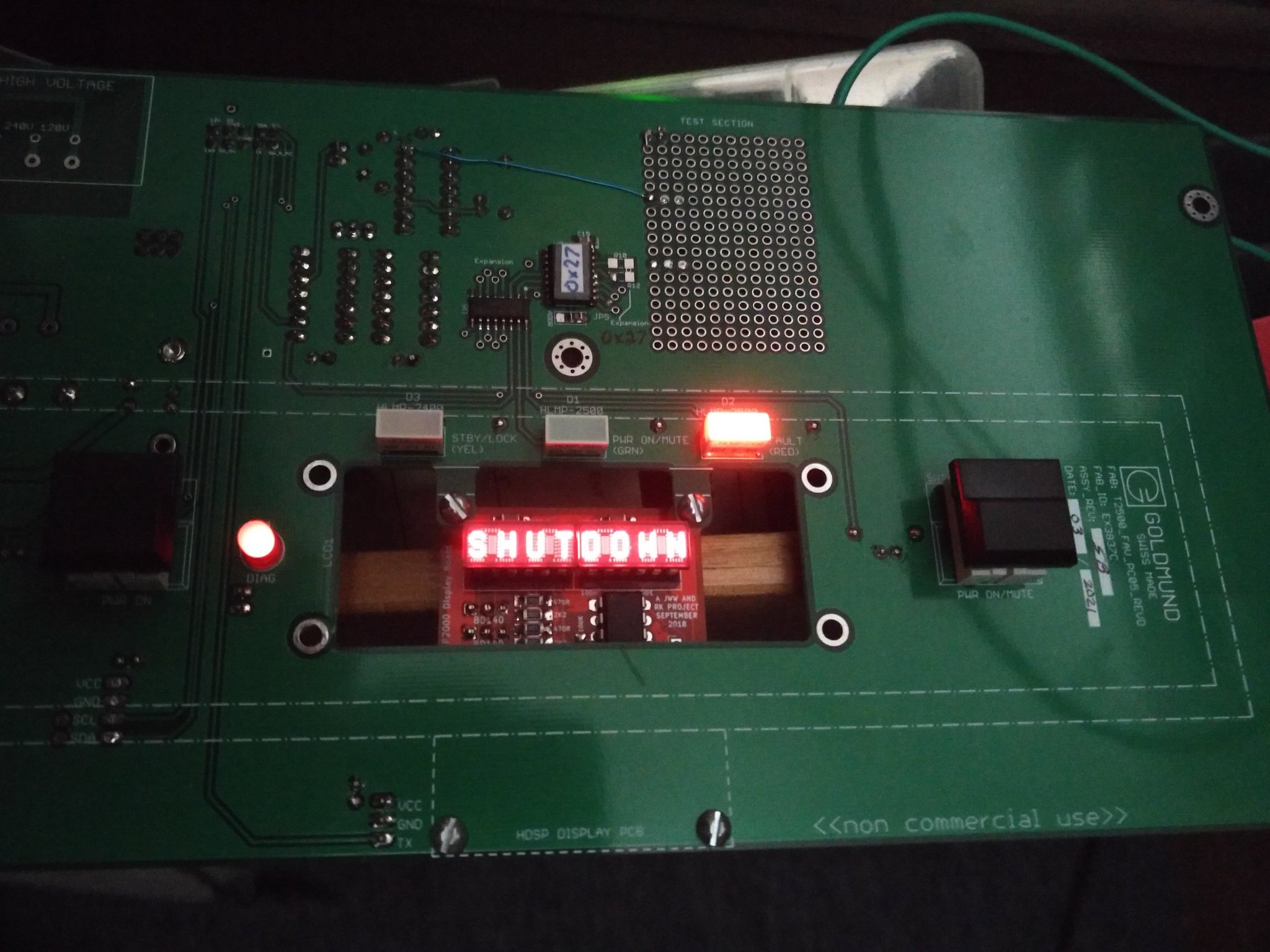

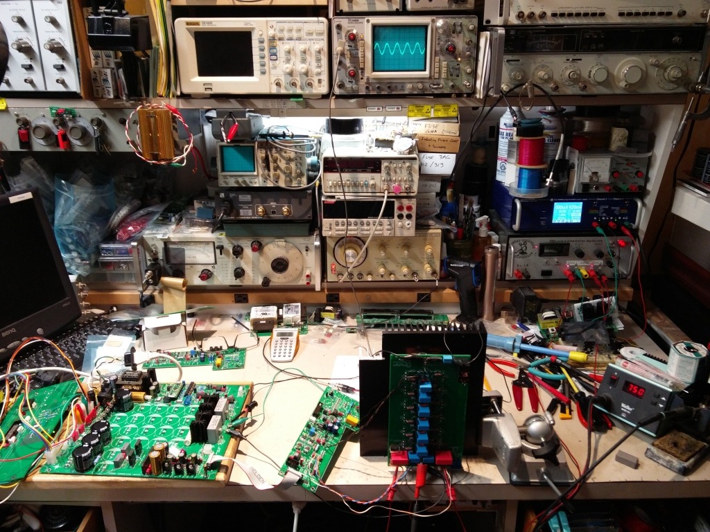

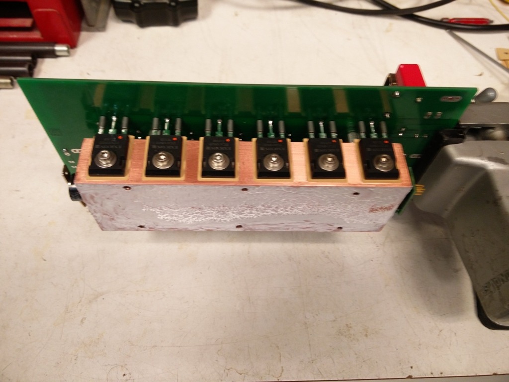

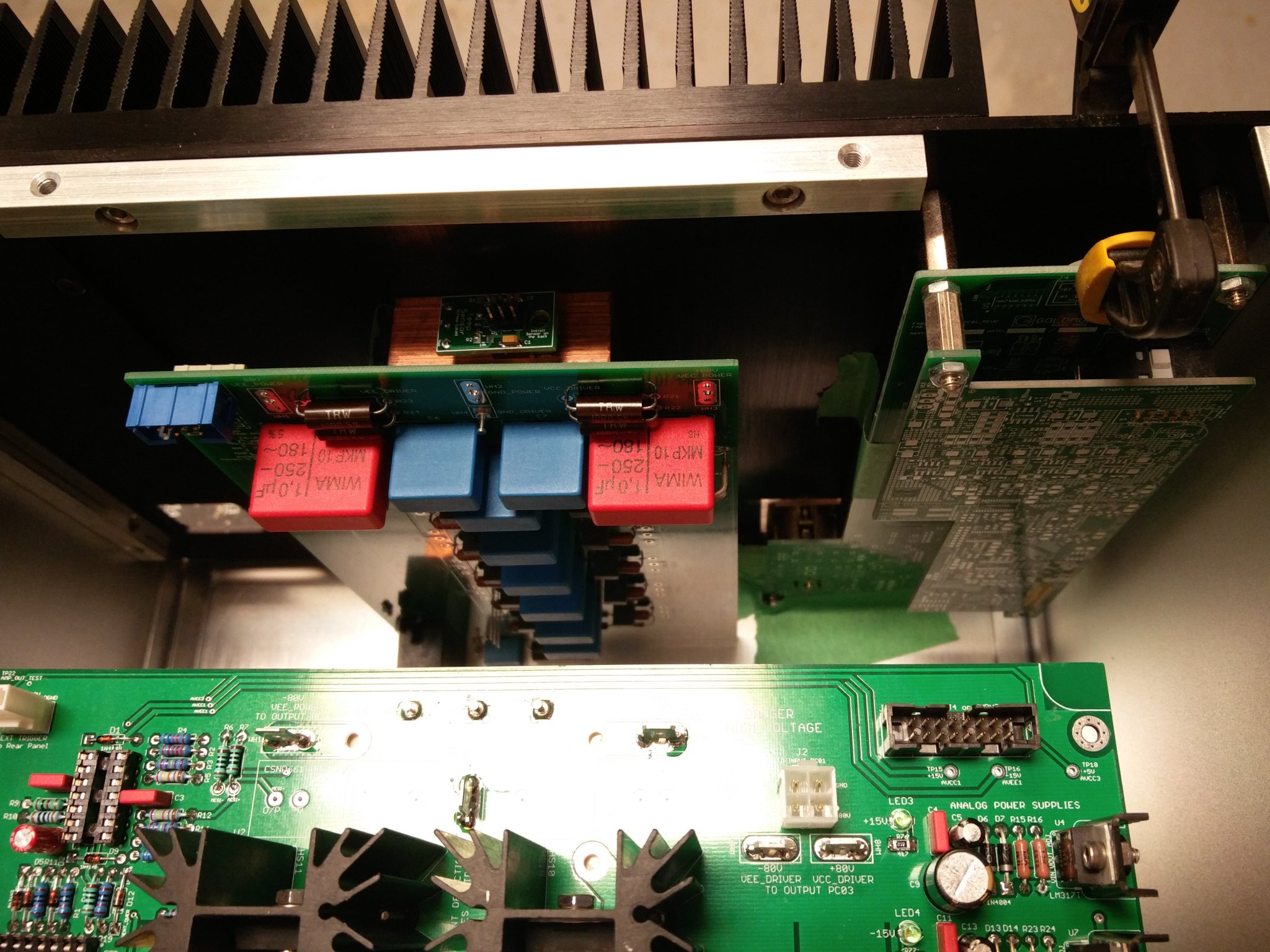

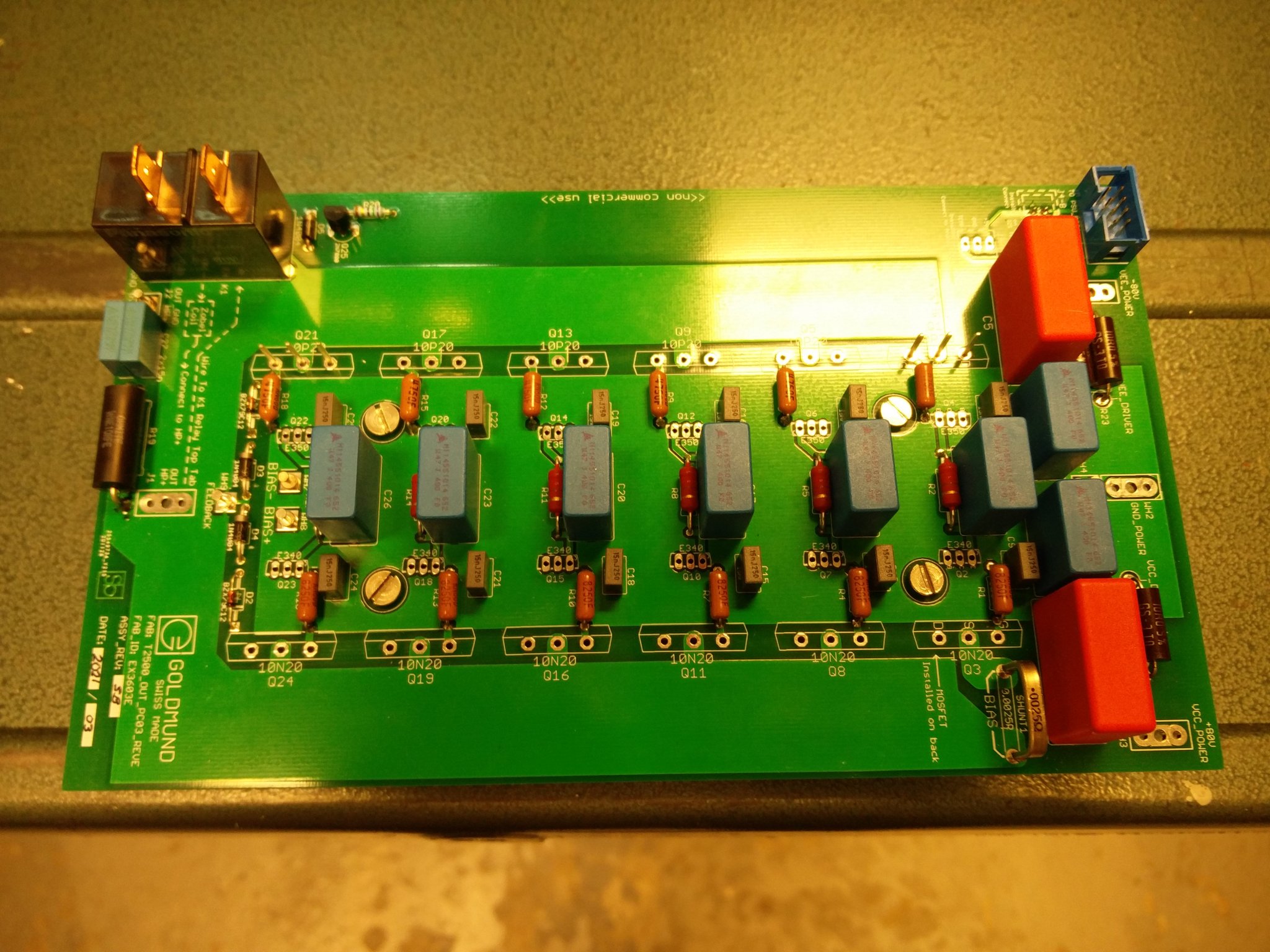

I hope it is as good as you're saying. I have a pair of Telos 2500 monoblocks in the making I have also the digital input PCB dac with PCM1794 Dac chip. I used an Arduino processor and did the code myself.
