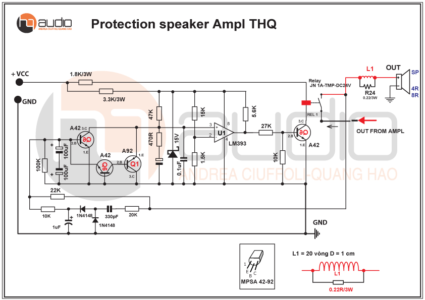

Your second picture shows Error (403)

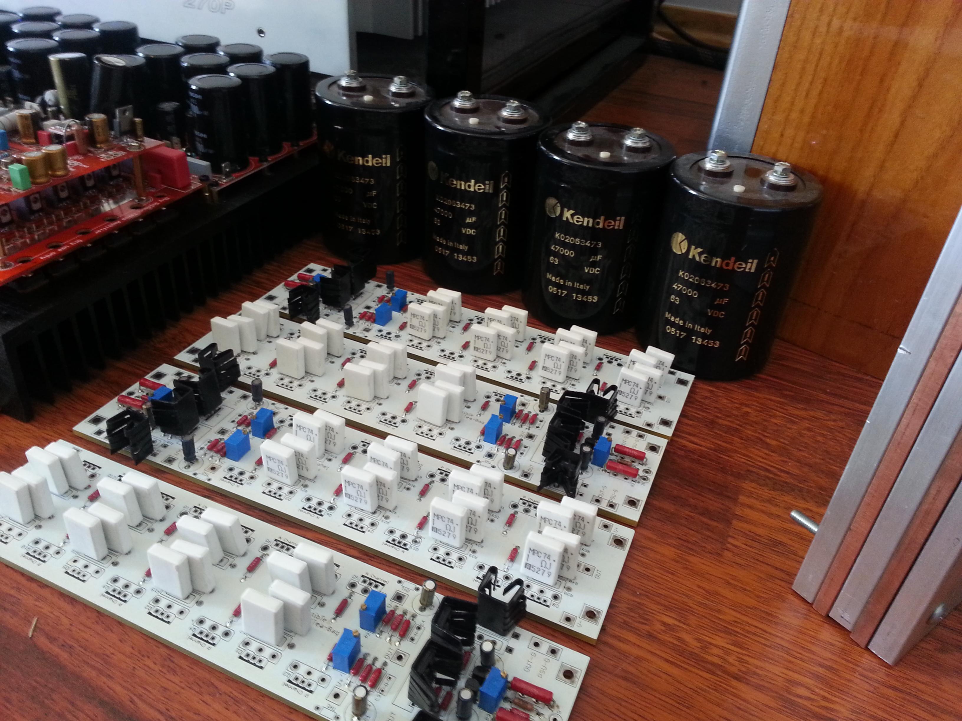

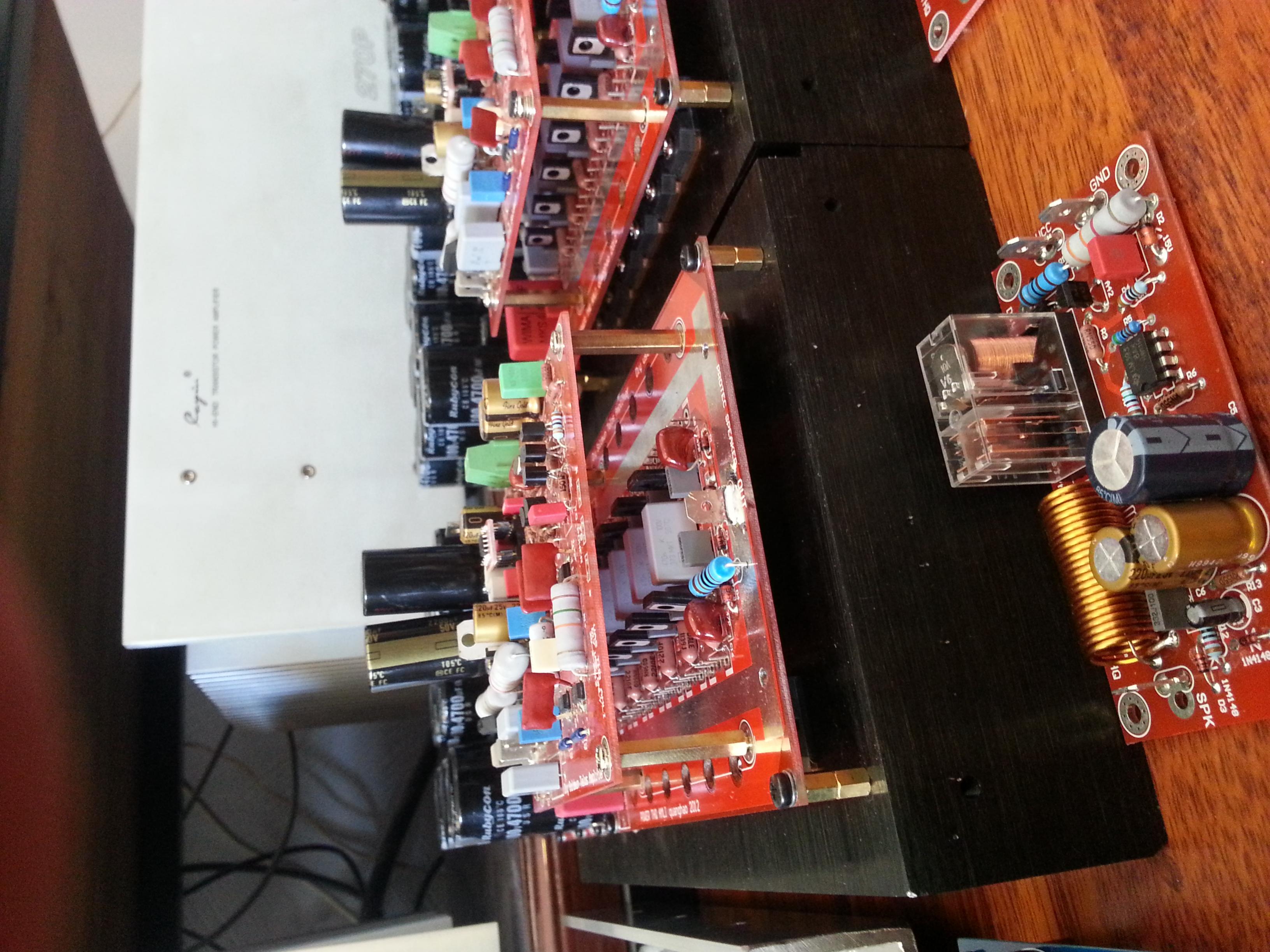

this work? as attachments?
edit: got this in email from member on board here. everething worked fine for him.
quote" Hi Stig,
This amp is worth the effort.
It is the best sound that I heard him!
Transistors,resistors - Exactly like in the schematics!
R20 - 330R (biass 100mA)
T5-T6 -Contact thermal!
T7-T8-T9-T10 - Thermal contact all four together!( I did exactly as proposed by Nikos on diyaudio)
Otherwise offset will not be stable!
I'm on the board:
C3=4,7PF
C5 = 10PF
C6 = 4,7PF
C7 = 4,7PF
T7 between B-C: 4,7PF
With these capacitors is perfect signal on the oscilloscope.
Transformers : 2x50V/500W (2 bridges for channel) It is the same 2x50V /500mA for BD249/BD250
From the bottom PCB - 2x 10000/100V.
On PCB - 2x4700/100V.
Not use strong resistors in the source.
Good luck !
Excuse my English
Best regards,
Vitali

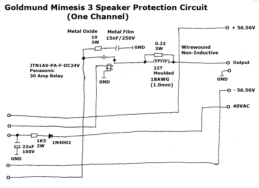

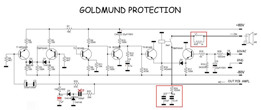

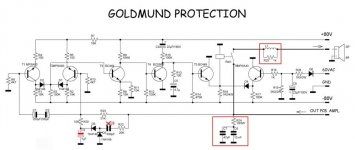

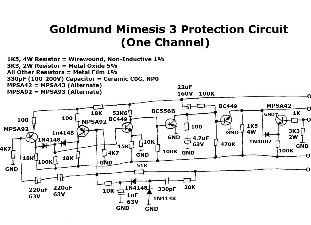

Unfortunately, I have not understood what is your problem regarding the protection circuit. When it comes to PCB, you are the first member I know of that use Nagys PCB. I think "all others" have used Alexs PCB.
I've looked at is your "silkscreen" that you don’t have on your PCB, but as a printed copy:
When it comes to the part of Nagy PCB, which we refer to as the protection circuit, this is exactly equal to the silk screen on my two PCB from Alex. Component values are also exactly the same. The only differences I can see is that Nagys copy have not given you the orientation for the ELE (C1-5 and C8).
The protection circuit works equally well on both my two print even if the voltage is significantly lower on Memesis 3.
My Memesis 3 is a copy of my Memesis 9.2 with the exception of three things:
1. Memesis 3 has a lower supply voltage.
2. Memesis 3 has 2x 2SK170 BL instead of 2N5564/65
3. Memesis 3 have as 9.2, three pairs of output FETs
Eivind Stillingen

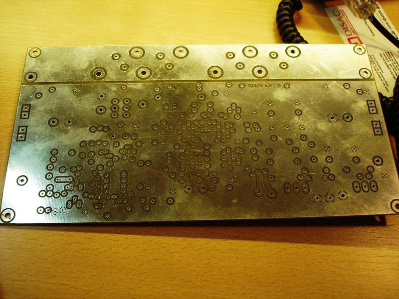

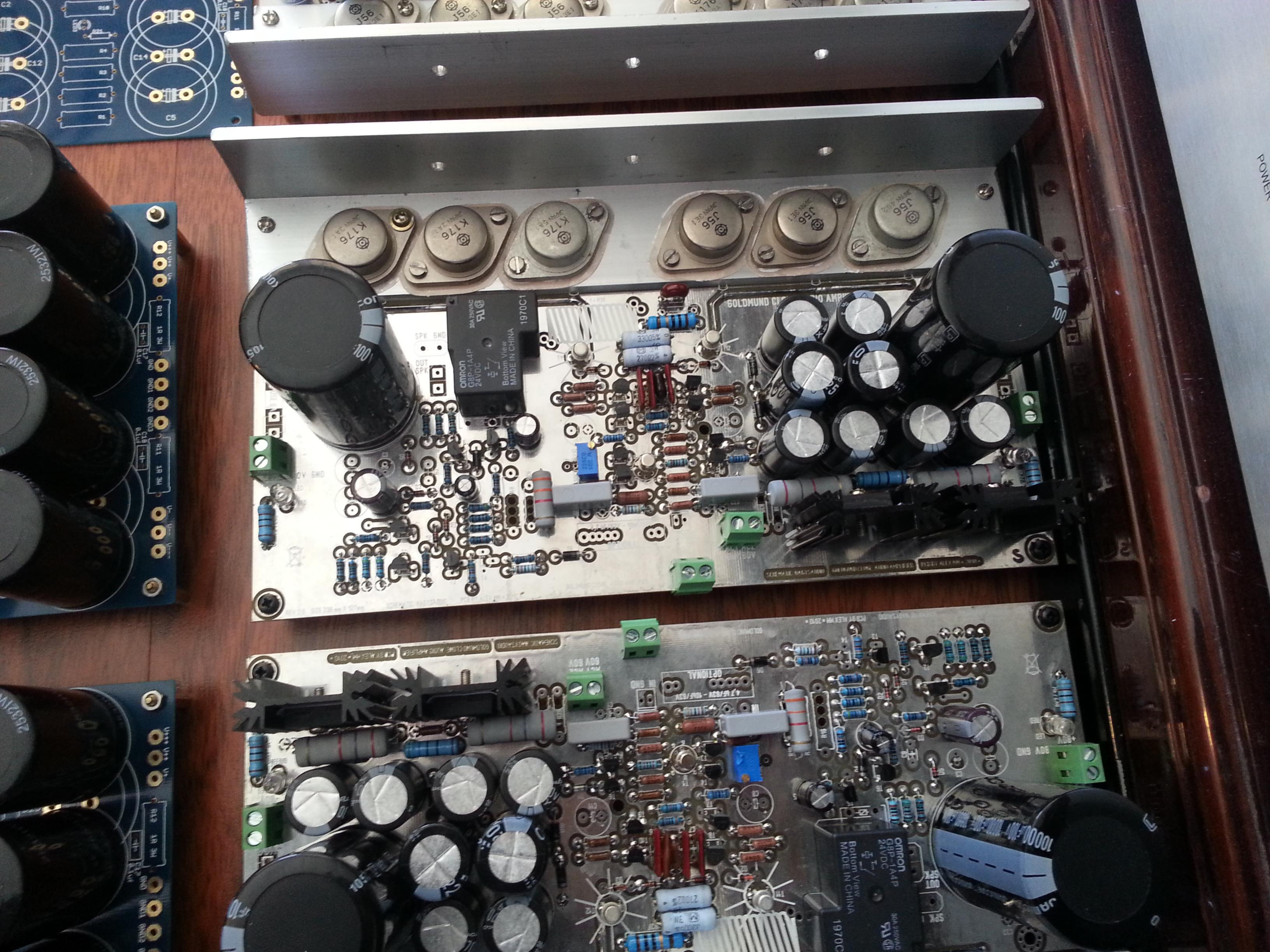

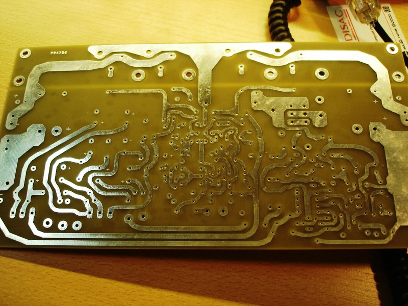

Eivind I can perfectly understand what you can't understand
I have some years experience with electronics and one of my many defects is that I need that everything is clear before aseembling, circuits, PCB's and part numbers.
Please tell me if you have seen this pictures of my board before
Please understand that after so many versions of nice boards seen here, I can doubt a little. Believe me I don't like smoke
After 6 or 7 beautiful versions of other kind of boards in the thread, Nagys posts and reveals the protection circuit at post #245 and talks of the Panasonic relay at post #256.
Most of his originals has been removed from the thread
All of your kind advices and oiphy's refer to a different amplifier, now I see that it is Goldmund 9
Your last post is the first time that somebody explains the differences between the 2 circuits, considering that the intention was to clone a Goldmund 3. Thank you for that, because I have never seen this Goldminds before, and many people here own one or has cloned one. Not my case.
So I will keep on researching the thread and try to resume a little.
The part numbering is different in my "silkscreen" . I mean the paper I have, not a real silkscreen that as you can see from the attachments, does not exist. My worry is that the paper could be different from my board silkscreen.

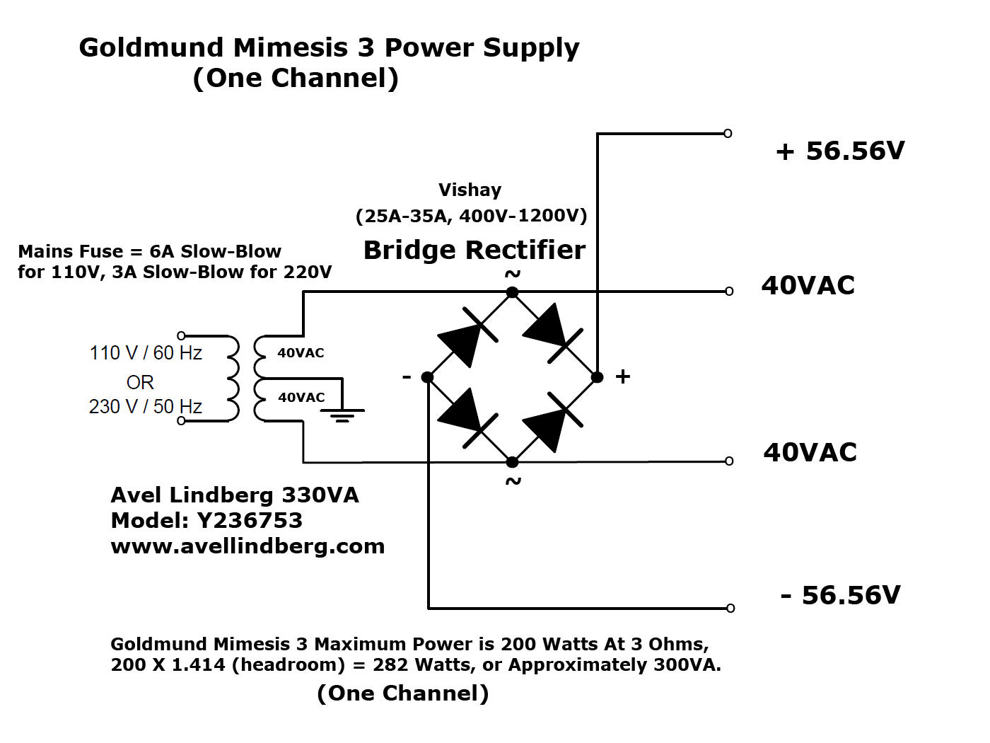

The power supply is + / - 56 VCC if you see the attached shematic. You guys always talk + / 80 VCC, this is confusing and may bring smoke. A little advice here should be nice. Nagys also talks 80 V, I think that the is talking 56 VAC x 1.41 = 80 VCC , right ?
Now that you have explained all this, I will try to assemble my board.
Thank you for your patience but I hope that yo will understand.

There may be lots of good protection circuits, but I should use the original one. I don't like to cut traces, this is not good practice specially in a high end device.
I need to know about the one that fits my board, please see all of the documentation that I have uploaded and that are my originals from Nagys.
Thank you

multiple gold'''''' clones pics
so here is whats keeping me up at night these winter months....
only missing small parts ....in the mail somewhere
so guess you'll hear from me often when this babies r being powered up
Hello Liliya, thank you for your reply.
I have also studied the whole thing and arrived to your same result.
1. for some reason I have the Nemesis 3 board with 2 transistor output version. This I obtained directly from Nagys.
2. most of the references of this thread address the nemesis 9 device.
3. the diference between them is 2 more output MOSFET's to make 3 total and increase output power and some changes in drivers and other semiconductors. Also resistors are added with the supply inputs. Capacitors values change. Circuit seems to be identical.
4. the power supply for Nemesis 3 is +/- 40 and +/- 60 VCC ; and is +/- 60 and +/- 80 VCC for Nemesis 9 version. I don't know GN9 power output.
5. most other PCB's use lateral TO-247 devices instead of original TO-3 package.
Now:
1. the protection circuit is included in my PCB in terms of copper and components allocation.
2. I have a neat circuit version that oiphy provided.
3. part numbering DO NOT MATCH mine.
4. don't know yet if the protection circuit is the same in both GN3 and GN 9
5. oiphy is showing a very similar (yet not identical) PCB as mine but it is good for GN9 not for my GN3 circuit. Can't see any ground plane cuts in it.
6. I don't know if oiphy's version is working and if it does, if it works fine.
Would like some help about evaluating this protection circuit and if I should incorporate it in my PCB.
With just a Dremmel drill I think I could make my board be a GN9
Question 1: are the Alex mm boards still avaliable for buying 2 of them ?
Please correct me if I'm wrong.
Thank you very much for your support
Roberto
Now:
Roberto

This is a photo of the PCB for Golmund 9.2 that Bigpanda sold. Copare tis with your own (Nagys) PCB
http://www.diyaudio.com/forums/group-buys/175296-pcb-order-goldmun-clone-31.html
I will try to find a copy in my document of the silkscreen of Bigpandas PCB.
Eivind Stillingen
Eivind Stillingen
OK Eivind, this is a G3 version similar I think to the one oiphy showed. As the metal is shiny, it is hard to get a good picture, but this one here is very good.
I will compare it to mine but I can tell you that I had done a quick compare of oiphy's layout and it has differences.
It would be nice to hear something about ground planes. Nagys said sometime that Goldmund didn't split planes in any way.
Thank you so much !
Roberto Berner
