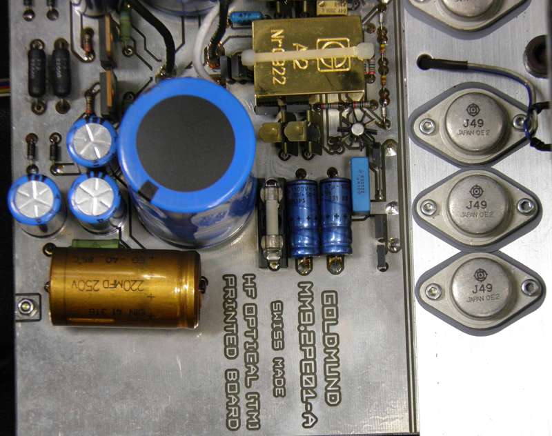

For those of You who realy know: Is the output transistors on the 9.2 isolated from the heatsink, or have the just made this arrangement for attaching the heatsink to make it possible to mount the transistors directly to the heatsink, no mica between?
I have used such configuration to several PA-amps where the heatsink has been totally covered by the cabinet, no danger of having it shortcirquited to anyting on the outside, neither any danger for being in touch with potensially dangerous voltages on outside areas.
Would further improve the C/W, wich can be a good thing.
No, the MM9.2 uses silicone rubber washers.
